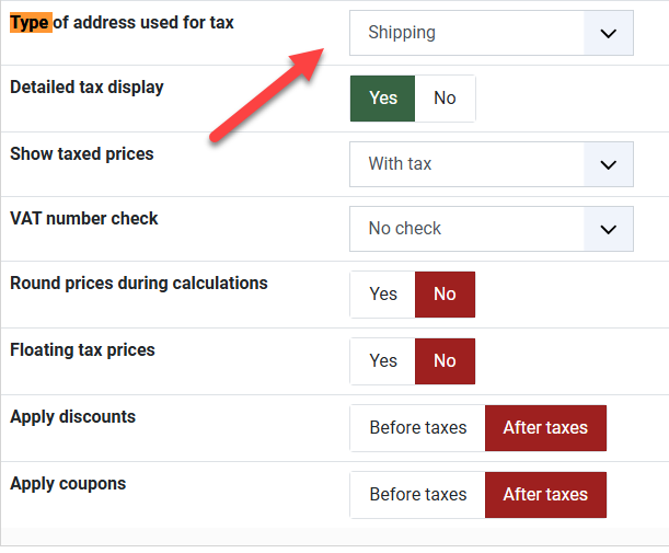

Similar to taxes restriction on zones, payment methods restriction on zones depends on how you configured the "Type of address used for tax" setting of the HikaShop configuration.
If you want the shipping address to be taken into account instead of the billing address, make sure that this setting is set to "shipping".

i have set that setting to shipping but still is the same situation. payment method dosnt reloads
