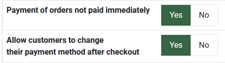

With the payment method PayPal Checkout in Sandbox mode, I tried to pay for an order in the "created" status using the "Pay now" function. However, I only received the following message:
"Payment of orders not paid immediately is not available on this website. Please contact the website administrator if you have any question."
Here are my configurations:
Is there something else I have to ajust?
Thank you!
