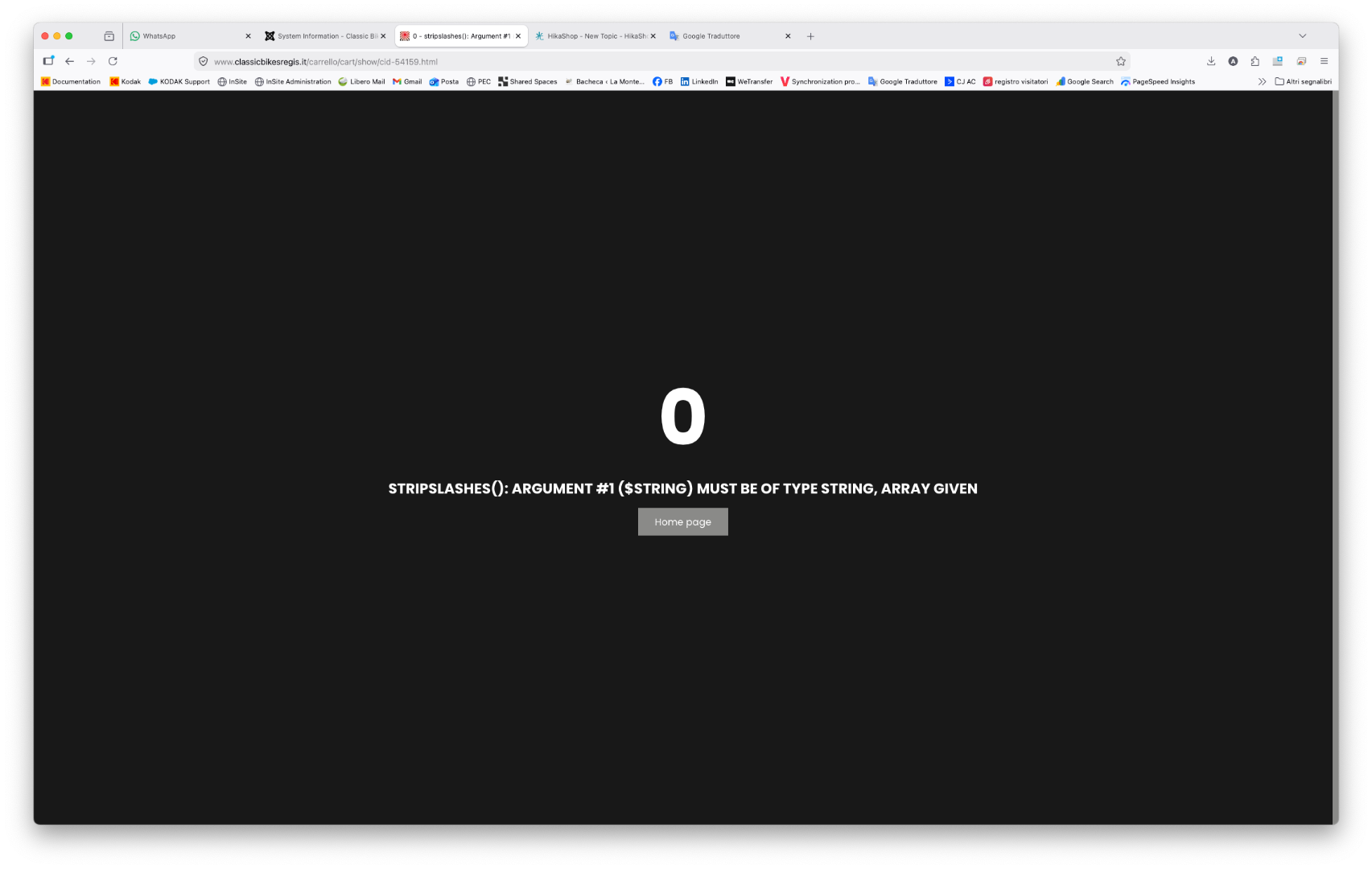

STRIPSLASHES(): ARGUMENT #1 ($STRING) MUST BE OF TYPE STRING, ARRAY GIVEN
Home page
Hi, let me give you an example: I'm logged in and I have 3 products in my cart. If I remove one (click on Trash) I get:
0 stripslashes(): Argument #1 ($string) must be of type string, array given
Please can you help me?
