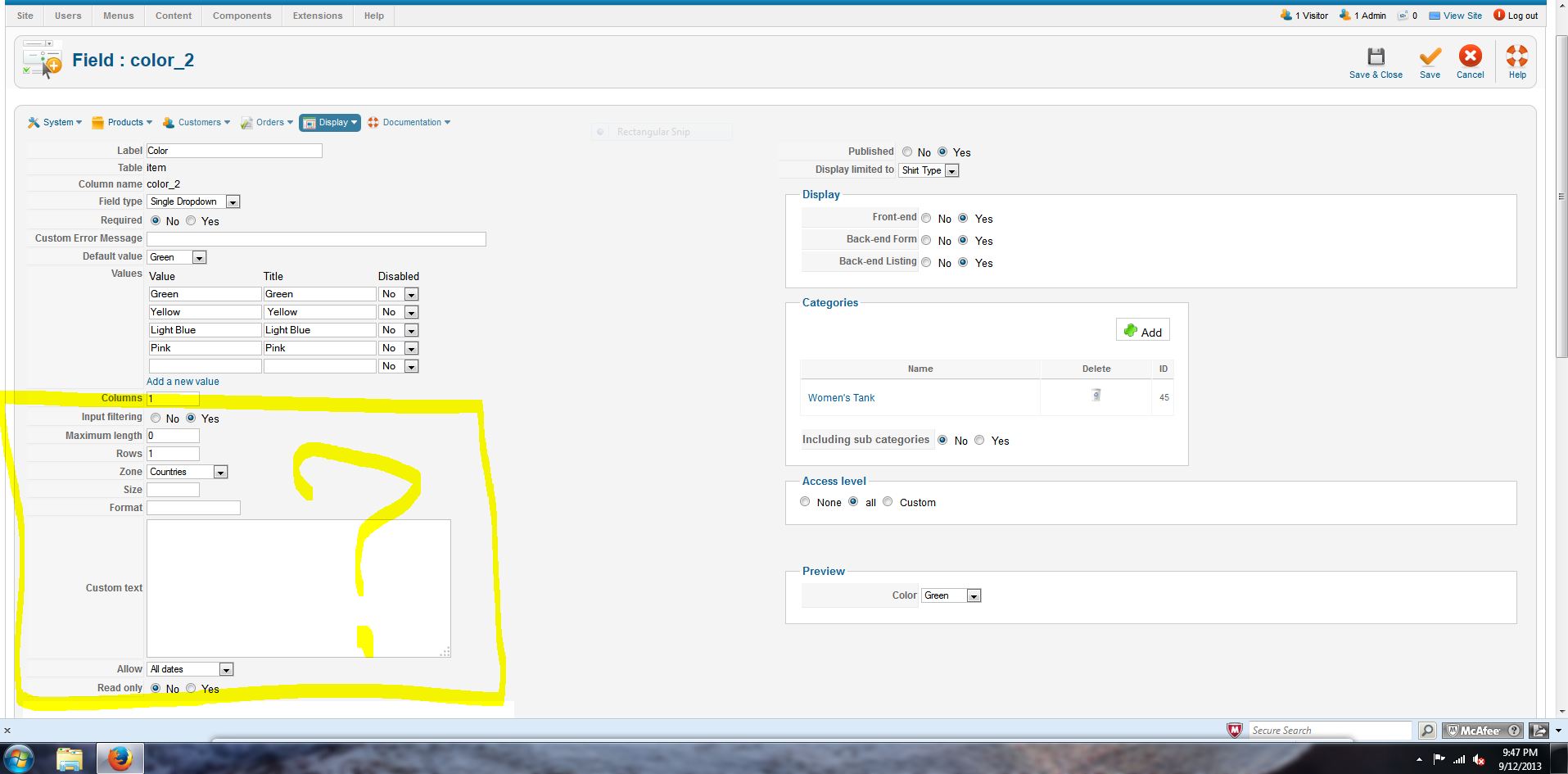

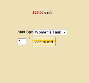

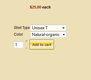

I am having trouble with this too. I have t shirts with one set of colors and tank tops with a different set of colors. It comes up correctly for the tees but the for the tanks no color option even comes up. When I try to limit display to tanks, and hit save, a box pops up on the left side of the screen and asks for columns and rows, input filters, a bunch of stuff. Its really strange.
The first picture is what I get when I select "display limited to:shirt type-womens tank" and hit save. I did the same thing with the t shirts and it worked fine.

BUT... the big thing is what is all that appears on the left side of the screen? It doesn't do that when I selected "display limited to- Unisex T". It worked just fine. See the jpg I attached.

  • Posts: 26380
12 years 10 months ago #123478
I think that you have a javascript error in the page, or you customized something.
We have a script which hide all elements when the page is loaded. After that, when an element is selected in the dropdown, the script will show/hide some lines depending the chosen one.
If all lines are visible it means that there was a problem with the initial script.
  • Posts: 47
12 years 10 months ago #123497
Thanks Jerome. I have not done any customizing outside of CSS so I don't think that's it. How can I fix this? The box appears and disappears as I hit save. Can I give you access to look at it?
  • Posts: 26380
12 years 10 months ago #123810
I think that it will be the best. I won't let you make some javascript debug.
The feature is working fine on the demo website and I suppose that you have a problem in your website which broke this custom fields edition page.
