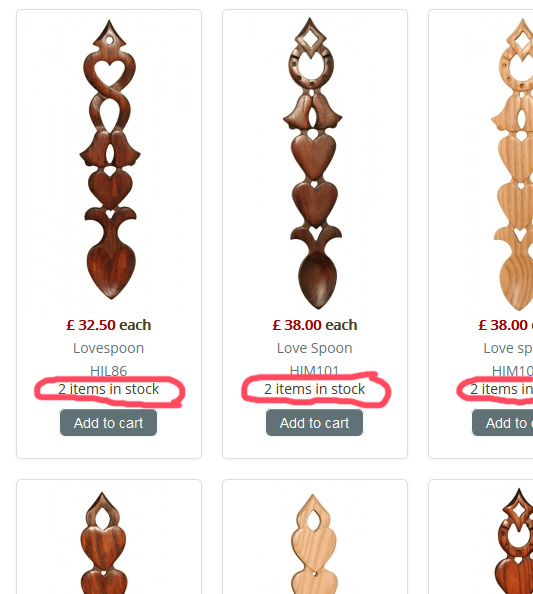

my client wants to have 1 of everything in stock for now....
He does not want the amount of items in stock to be shown in each listing
how do we remove it please.?
thanks

12 years 3 months ago #153071
the red area in the pic... how to remove fromview please thanks
12 years 3 months ago #153083
Using this kind of CSS code will probably do the job :
.hikashop_container .hikashop_product_stock_count {
display: none;

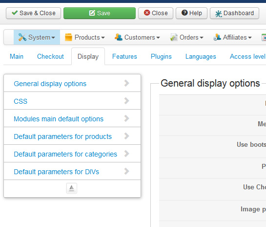

As it's said on the documentation :
All these CSS modifications can be done via the CSS edition interface in the Display tab of the configuration ("Hikashop->System->Configuration->Display"):
  • Posts: 114
12 years 3 months ago #153731
where!?!??!

12 years 3 months ago #153763
or You can do a language override
in Hikashop->System->Configuration->Languages
- choose the language(s) You wanted to edit
- You will see the line : X_ITEMS_IN_STOCK="%s items in stock"
- go to the override part of the window and type or copy : X_ITEMS_IN_STOCK="in stock" then You will just have the indication that the product is in stock without any quantity (or X_ITEMS_IN_STOCK="" Do some tests or customise it to obtain the best result for You )
