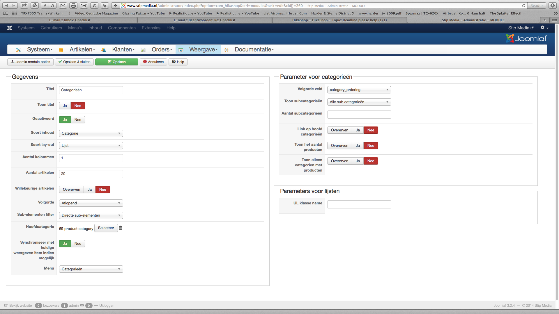

Then please provide a screenshot of the options of the module with the id 260 that you can find when you edit it via the menu Display->Content modules.
  • Posts: 23
11 years 11 months ago #168543
Here you go nicolas
  • Posts: 86027
  • Thank you received: 14170
11 years 11 months ago #168547
Edit the file "listing_list" of the view "category" via the menu Display>Views with this content and that should fix the problem:
