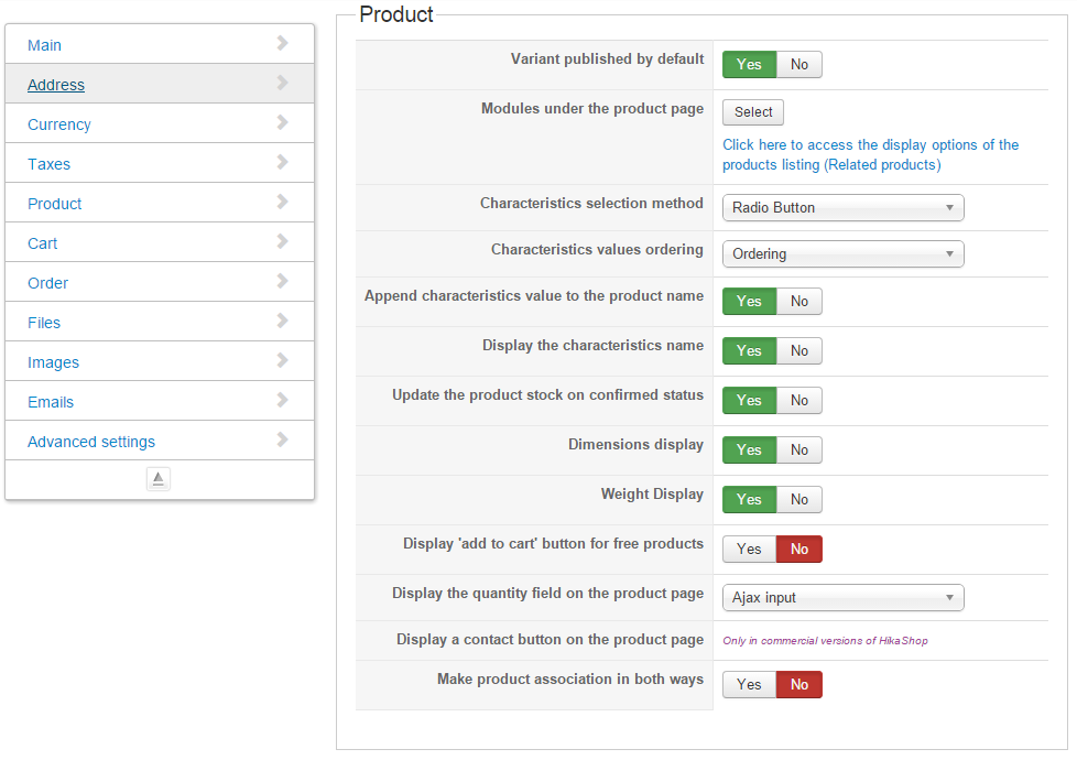

  • Posts: 16
11 years 3 months ago #200131
Hi there, I also have this problem and came across this string. I've also ensured that make association in both ways is set to off (please see attached screen shot) but it keeps on popping back up with random related items again I've set it to 3 for each product.. but I come back after a few days and it appears that the fourth one has come back?
My site I'm building is at: 101.0.115.100/~askueand/
Any help on this would be great. There's quite a few buggy things going on. Also with the variant characteristics it's set to 'ordering' and I never change it but it keeps jumping around from 8,9,10 to suddenly going the opposite way?

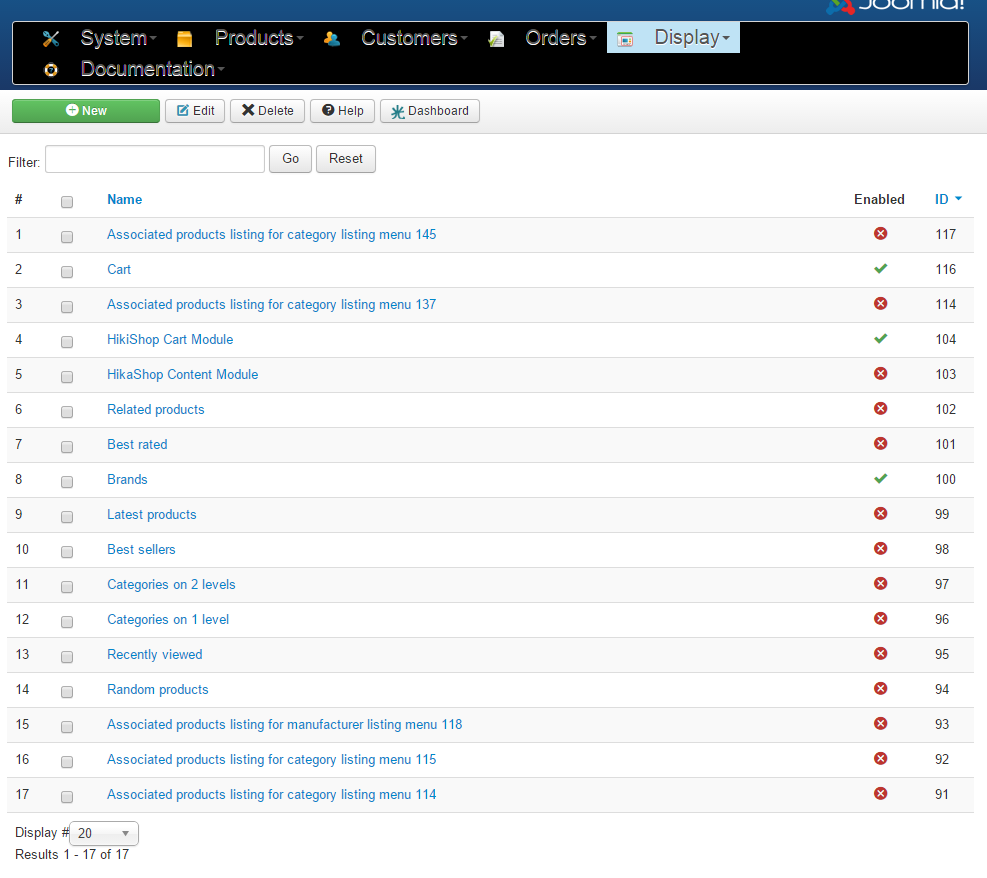

  • Posts: 26380
11 years 3 months ago #200186
Would it be possible to have more details about your HikaShop content module with the ID 102 ?
(Display > content module).

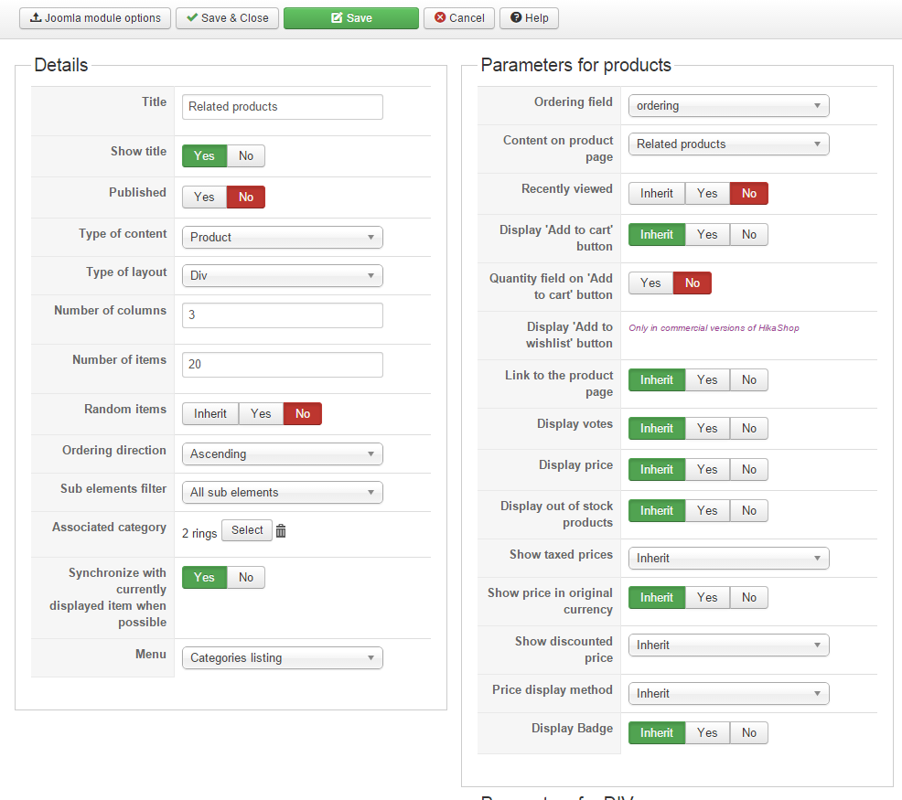

  • Posts: 16
11 years 3 months ago #200228
Hi Jermome, thanks for being so speedy in your support! I wish other third parties were this quick! Please see attached the screen shot. Interestingly enough the related items module in content modules says unpublished but you can still see related items as I added them under the product page.
  • Posts: 26380
11 years 3 months ago #200292
Thanks for the screenshots ; Your configuration is good.
I see that you are using HikaShop 2.3.1 ; even if I don't see any mention of fixes for the related product association in the change log, because the feature as been added in HikaShop 2.3.1, it could be interesting to update to the last HikaShop version (2.4.0).
At this moment, if you still have the issue ; it will be easier for us to perform some tests and find it out.
