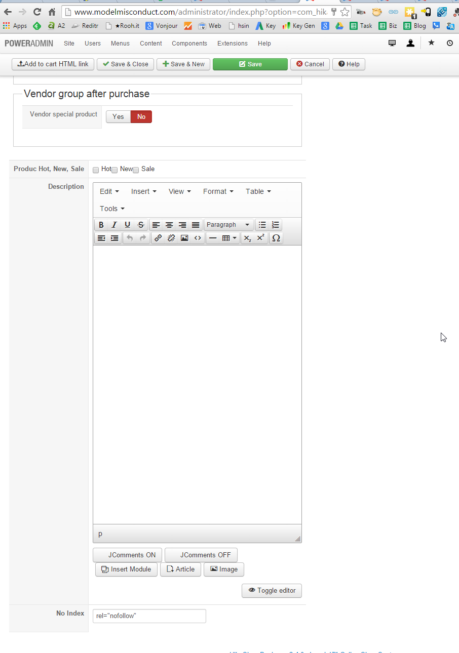

11 years 4 months ago #195895
I am not sure I understand. I'll explain what I did. If that doesn't work, I'll set up a test server and make the changes so it will 404.
I have a custom field labeled "No Index" associated with a column name for my product called "nofollow"
I set the default value to equal rel="nofollow" (pic attached)
I then go to the listing_img_title file of PRODUCT under DISPLAY->VIEWS for the front end of my specific template

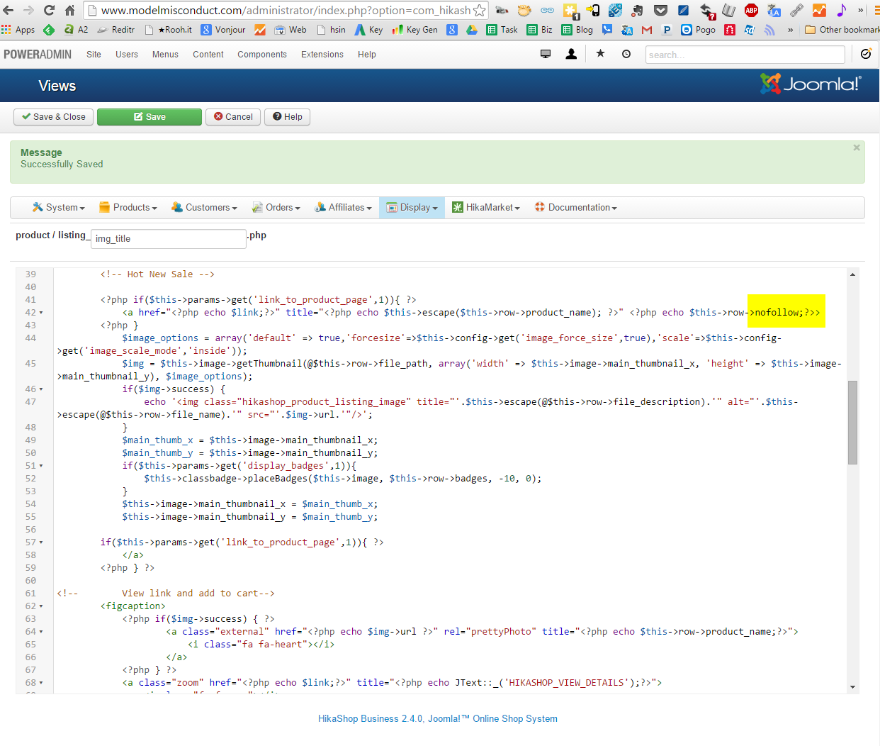

I replace
<a href="<?php echo $link;?>" title="<?php echo $this->escape($this->row->product_name); ?>">
with
<a href="<?php echo $link;?>" title="<?php echo $this->escape($this->row->product_name); ?>" <?php echo $this->row->nofollow;?>>
should the nofollow above be No Index?
  • Posts: 86027
  • Thank you received: 14168
11 years 4 months ago #195911
I don't see why that change would generate a 404 error since you don't change the href attribute of the link.
On top of that, your modification is correct so it should work fine.
The 404 error must come from something else.
Do you mean that if you remove the modification you don't get the 404 and if you add it back you get it again ?
That would be really strange.
