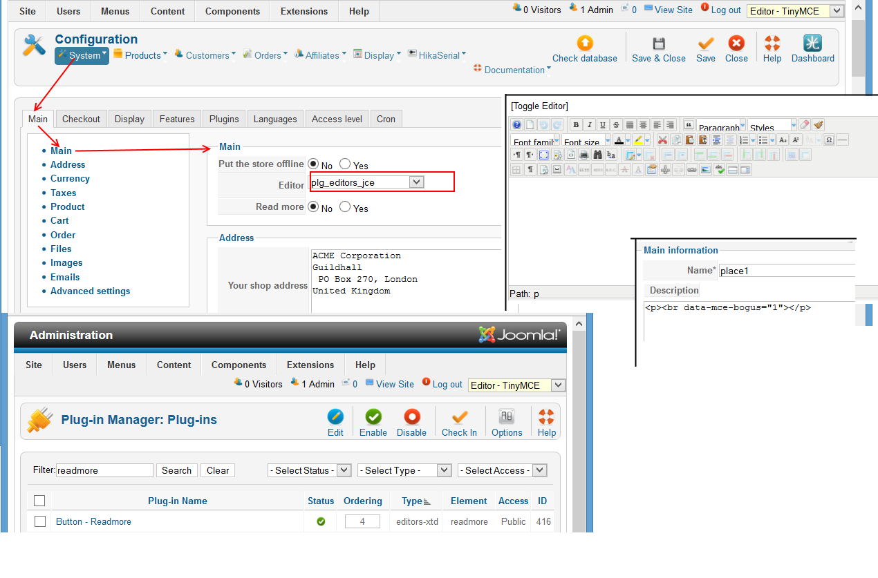

Can I use JCE to get a Read More button to use?
  • Posts: 190
11 years 5 months ago #190132
-- Joomla version -- : 3.3.6
-- PHP version -- : 5.3.29
-- Browser(s) name and version -- : Google Chrome Version 40.0.2214.111 m
-- Error-message(debug-mod must be tuned on) -- : I am not getting an error. I am just trying to figure out if I can use JCE editor safely with HikaShop.
Mostly I am wanting it to be able to turn on the Read More button. I have not been able to turn this on using TinyMCE. I have configured HikaShop so that Read More is set to YES. I have also configured TinyMCE to be in Extended mode but have not found any option for Read More.
Am I just missing something basic? If I can't get Read More with TinyMCE then I would like to install and use JCE. :-)
Thank you, Sean
11 years 5 months ago #190161
Do you have enabled the plugin "Button - Readmore" ?

11 years 5 months ago #190519
JCE yes , Tiny MCE don't Work !!
I think readmore functionnalities work only for articles publish in blog Layout !
www.joomlacontenteditor.net/support/faq/...readmore-not-working
@xavier
Does readmore is implemented by Joomla core or by HKS ? for which layout ?
Last edit: 11 years 5 months ago by lionel75.
  • Posts: 86027
  • Thank you received: 14170
11 years 5 months ago #190551
The read more button below the HTML editors is displayed by Joomla if the "button read more" plugin plugin is enabled via the Joomla plugins manager and that the "read more" option of the HikaShop configuration is turned on.
The HTML editor you use shouldn't change that and it works fine on our end with TinyMCE.

11 years 3 months ago #198428
a composite( blend) visual capture screen
