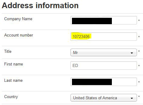

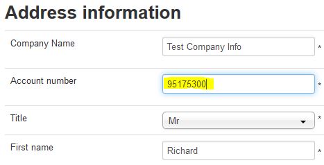

  • Posts: 60
11 years 3 months ago #200490
Please see the attached screen shots. It shows that the number which should be displayed with my account is 95175300, but the front end is actually displaying 10723406 (which is associated with a different account).
I really appreciate your help with this... Not sure what's going wrong here.
  • Posts: 86027
  • Thank you received: 14170
11 years 3 months ago #200501
Ha, I know, there is a mistake in the code you gave. It should be like that:
{source}<?php
 $query = "SELECT ha.address_vat FROM #__hikashop_address ha LEFT JOIN #__hikashop_user hu ON ha.address_user_id=hu.user_id WHERE hu.user_cms_id = '".$user->id."' LIMIT 1";
 $database->setQuery($query);
 echo $database->loadResult();
?>{/source}
