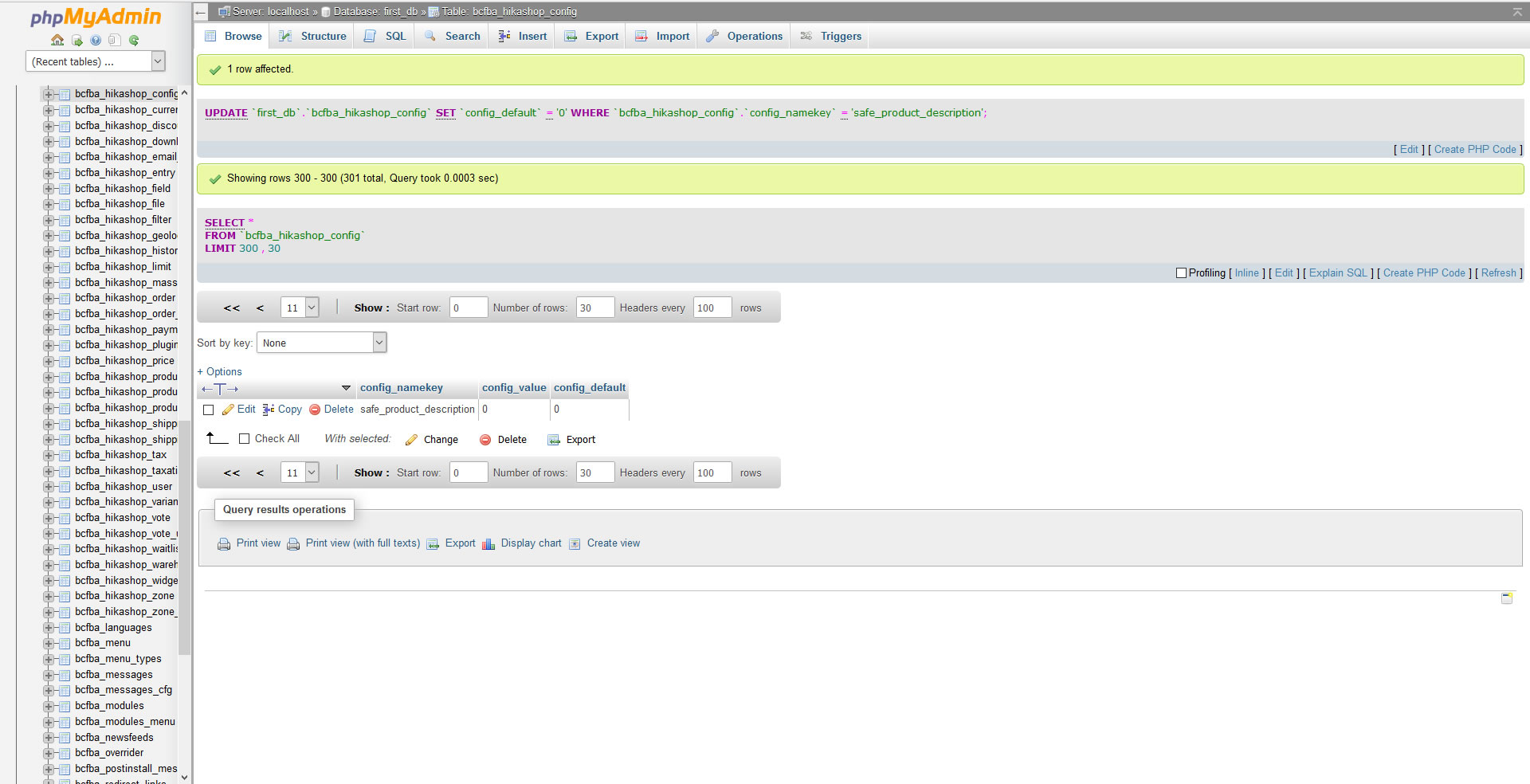

Thank you for your suggested workaround, however, it doesn't work? Also I would like to get this working correctly as its not just youtube that will be required in the custom fields.
Please see attached screen shot of the DB config. Do you have any other suggestions?

  • Posts: 86027
  • Thank you received: 14170
10 years 9 months ago #217498
I read too fast your first message. I thought that it was about the product description, not custom fields. For custom fields, you need to turn off the "Input filtering" setting of the setting and such content plugin wouldn't work.
