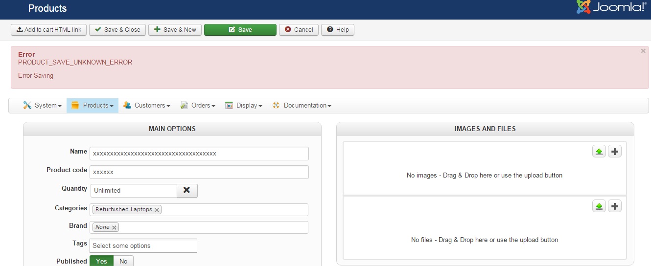

-- Joomla version -- : 3.4.4
-- PHP version -- : 5.4.45
-- Error-message(debug-mod must be tuned on) -- : Error
PRODUCT_SAVE_UNKNOWN_ERROR
Error Saving
WHEN I ADD A NEW PRODUCT AND I TRY TO SAVE I RECEIVE THE ERROR:
Error
Error Saving
THE PROBLEM APPEARED AFTER UPGRADING TO HIKASHOP ESSENTIAL.
Last edit: 10 years 9 months ago by ggiakoum. Reason: PICTURE
