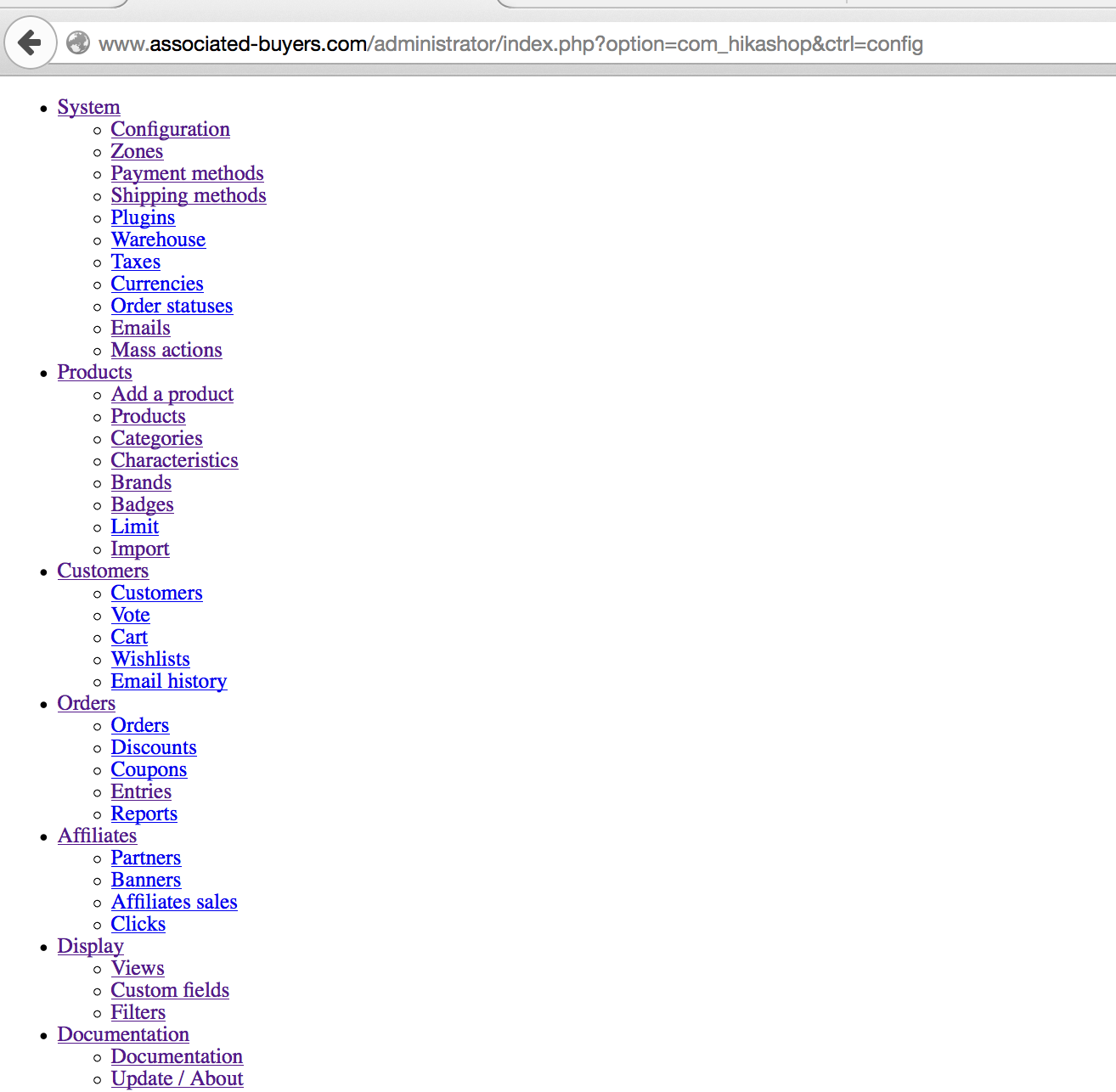

Hello -
Somehow I made a change that has caused the config page to come up in list form.
Can you advise how to switch back.

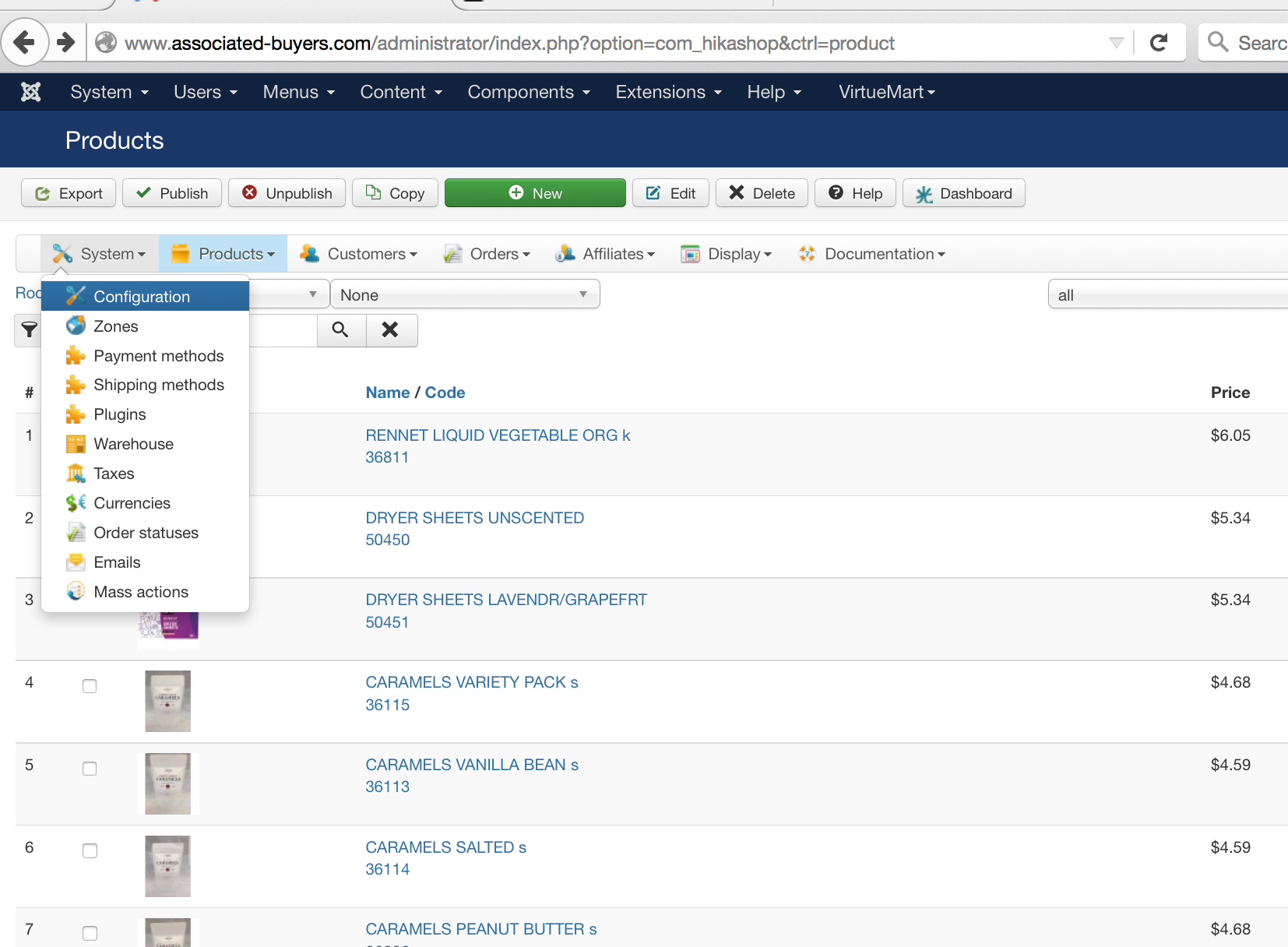

Two screenshots attached, page I click to link - then config page.
Thank you.

Please check your PHP error log ; you have a PHP Fatal error in your configuration page (which is generated at the bottom of the page but might be not visible in the page).

Hello Jerome -
yes,
Fatal error: Call to undefined method hikashopZoneClass::getNameboxData() in /homepages/6/d100188684/htdocs/associated-buyers/administrator/components/com_hikashop/types/namebox.php on line 270
this is what is on line 269 and 270
$fullLoad = true;
list($elements, $values) = $nameboxClass->getNameboxData($typeConfig, $fullLoad, $mode, $value, null, $options);
Please advise what it should be?
Thank you!
James
  • Posts: 26380
10 years 8 months ago #219997
The function "getNameboxData" is in the HikaShop Zone class since HikaShop 2.5.0
Are you sure that you right updated HikaShop ? That Joomla have write permission on all HikaShop files ?
That you do not have a class override for the HikaShop zone class (which does not extends from the original one...) or a system plugin which would re-define it ?
administrator/components/com_hikashop/classes/zone.php
