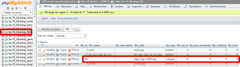

I can process some test, I suspect an SQL issue, for be sure of this, can you make a screenshot?
I need to see like on this example below element in your hikashop_file table, and the file_ref_id = 158 (13 in the example) AND [/b]file_type = category
This element belongs to your category "Alle LEGO sets" and can give some clues with your issue.
Last edit: 10 years 6 months ago by Philip.

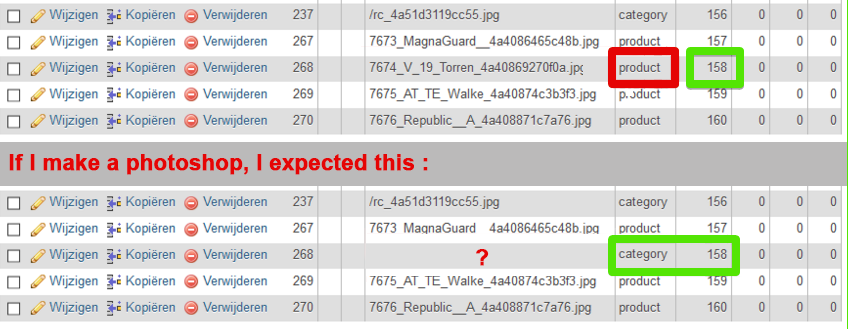

  • Posts: 224
  • Thank you received: 10
10 years 6 months ago #228796
Hi Philip,
Will this screenshot do?
10 years 6 months ago #228889
No, this isn't what I need.
element in your hikashop_file table, and the file_ref_id = 158 (...) AND [/b]file_type = category
for be more precise :
  • Posts: 224
10 years 6 months ago #228944
As you can see in this picture the column "file_ref_id" is ordered and there is only a row 158 for product not for category
  • Posts: 224
10 years 6 months ago #228945
I think i found something,
When i try to add the row in phpmyadmin i get the error:
#1062 - Duplicate entry '158' for key 'file_ref_id'
I dropped the unique key in file_ref_id and it seems to work now.
Thank you for pointing me in the right direction!
Last edit: 10 years 6 months ago by Joomill.
