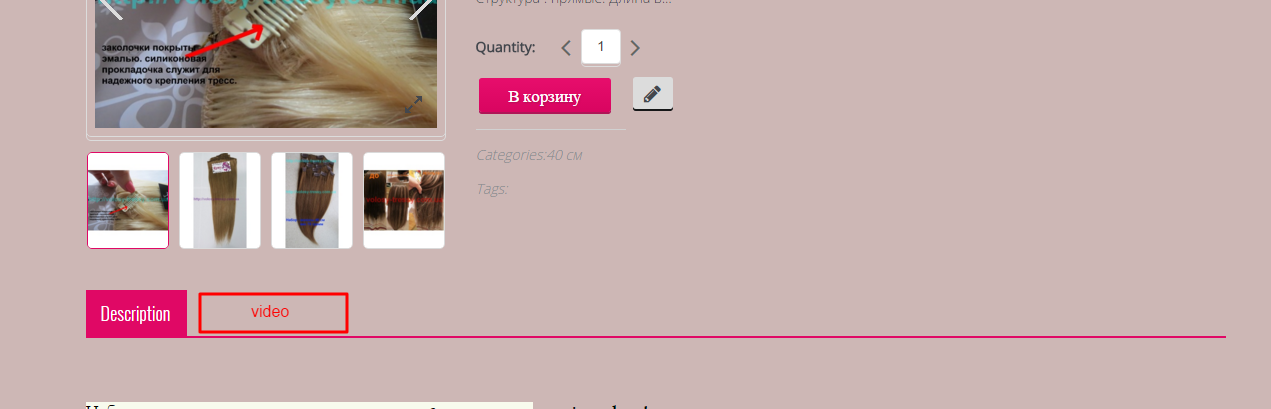

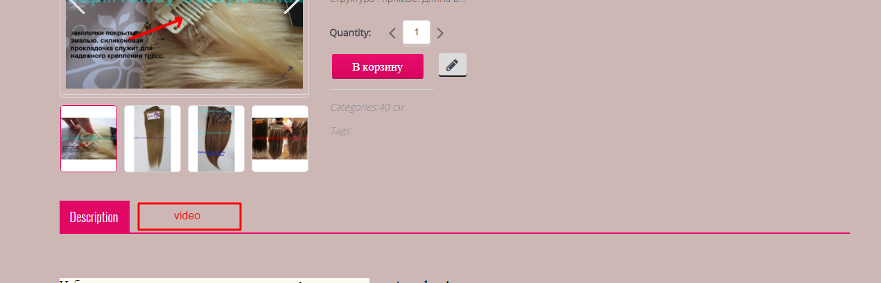

Hi! The question how to make an additional tab (optional field)such as description, only the "video" tab when you click on the video tab, there was a video! the example in the attachment. Thank you!

And so the Lord,) that I the rules, but, nothing happened!
<div id="hikashop_product_bottom_part" class="hikashop_product_bottom_part show_tabular">
<div id="hikashop_tabs_div">
<ul class="hikashop_tabs_ul">
<li id="hikashop_show_tabular_description_li" class="hikashop_tabs_li ui-corner-top"><?php echo JText::_('PRODUCT_DESCRIPTION');?></li>
<?php if($hide_specs == 0){ ?>
<li id="hikashop_show_tabular_specification_li" class="hikashop_tabs_li ui-corner-top"><?php echo JText::_('SPECIFICATIONS');?></li>
<?php }
if($status_vote == "comment" || $status_vote == "two" || $status_vote == "both" ){
<li id="hikashop_show_tabular_comment_li" class="hikashop_tabs_li ui-corner-top"><?php echo JText::_('PRODUCT_COMMENT');?></li>
<li id="hikashop_show_tabular_new_comment_li" class="hikashop_tabs_li ui-corner-top"><?php echo JText::_('PRODUCT_NEW_COMMENT');?></li>
<?php } ?>
<li id="my_tab_li">Video</li>
</ul>
<?php
if(!empty($this->element->extraData->bottomBegin))
echo implode("\r\n",$this->element->extraData->bottomBegin);
<div class="hikashop_tabs_content" id="hikashop_show_tabular_description">
<div id="hikashop_product_description_main" class="hikashop_product_description_main">
<?php
<div class="hikashop_tabs_content" id="my_tab">
content of the tab
</div>
echo JHTML::_('content.prepare',preg_replace('#<hr *id="system-readmore" */>#i','',$this->element->product_description));
</div>

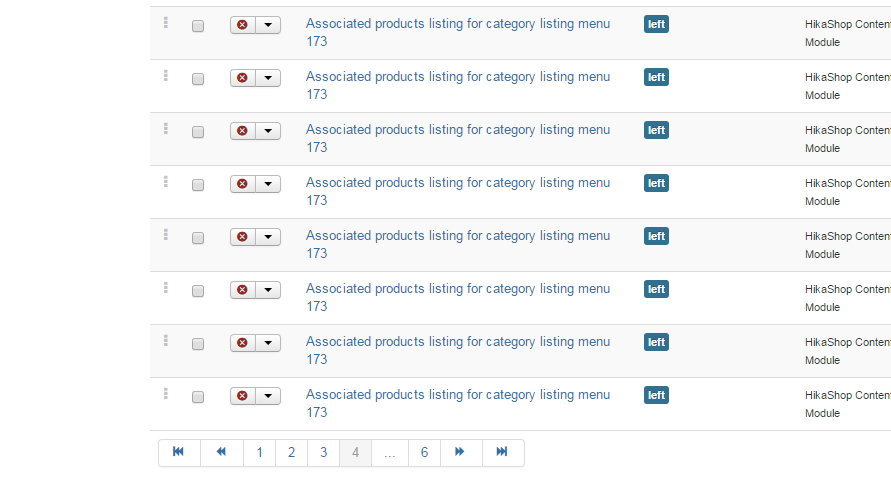

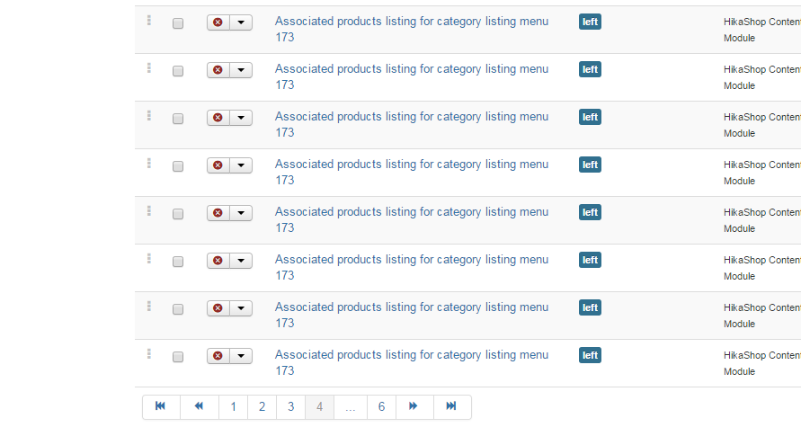

and I have duplicated the entry Associated products listing for category listing menu 173
Yesterday it was 76 pages, restored the Database, it was OK, today is another such story.
What could it be?
Last edit: 10 years 5 months ago by Святина.
  • Posts: 26380
10 years 5 months ago #229912
You're using HikaShop 2.6.0 ?
So the best would be to update to the latest version.
www.hikashop.com/support/documentation/5...ashop-changelog.html
