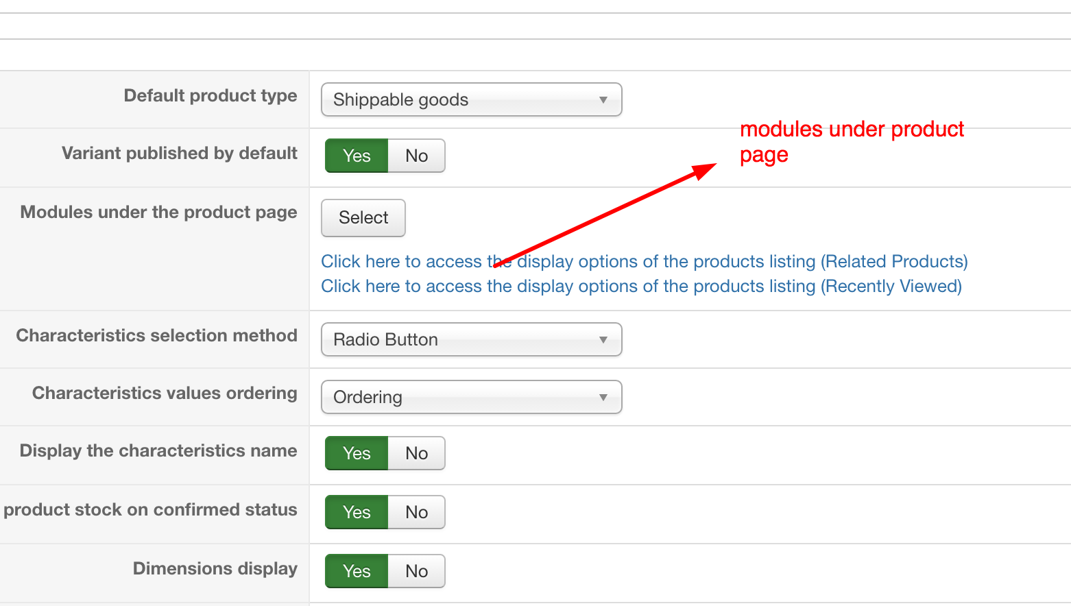

9 years 10 months ago #245219
-- Joomla version -- : 3.4.3
-- PHP version -- : 5.5
hi
i found the ability to create modules under the product page.
is this possible for categories as well?
i found a docu about associated menus but i cant see it on the category listing menu
thanks

  • Posts: 490
9 years 10 months ago #245328
at the configuration > main > product. you can select modules for the product page.
in the category page can i have this too?
thanks
  • Posts: 85712
  • Thank you received: 14048
9 years 10 months ago #245337
No, there is no option to do that.
There are several ways to do it:
- You could configure your module to display in a position of your template below the main content area for the menu items you want, and then configure the Display settings of the module to only display on the listings.
- You could use the Advanced modules manager extension to restrict the display of the module to the listings only.
- You could edit the file "listing" of the view "product" for your frontend template via the menu Display>Views and add at the end a Modules Anywhere tag displaying your module there.
