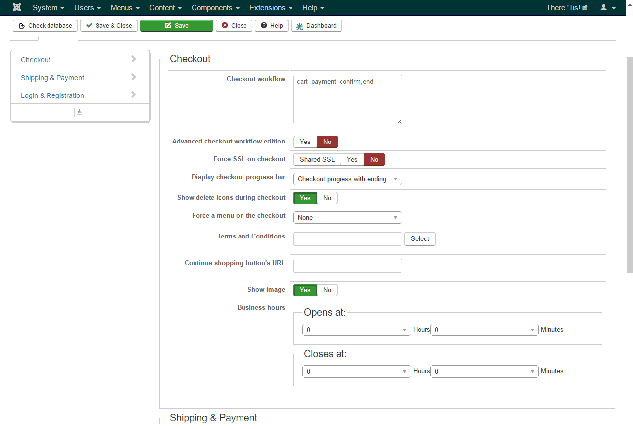

I deleted the block "status".
I now only have "Cart" and "Payment" blocks but the cart screen (image 3 on my attachment) now repeats itself without the extra "You chose Paypal".
The workflow reads: cart_payment_confirm,end. Where is the "confirm" coming from?

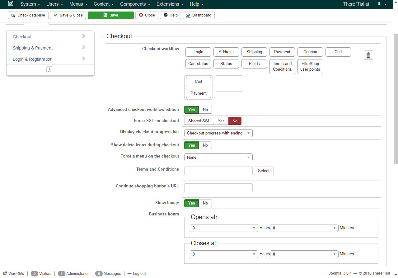

Please provide a screenshot of your checkout workflow (a jpeg or png image will be more interesting than a PDF).
  • Posts: 47
9 years 8 months ago #255138
Please see attached image

9 years 8 months ago #255139
Here is the other image.
9 years 8 months ago #255158
If you want your checkout workflow to work correctly, you'll actually need to add more action to your checkout workflow steps like
login / address / shipping (if needed)/ payment / cart / status (if needed).
Can you add the required steps and test it again ?
Thank you.
