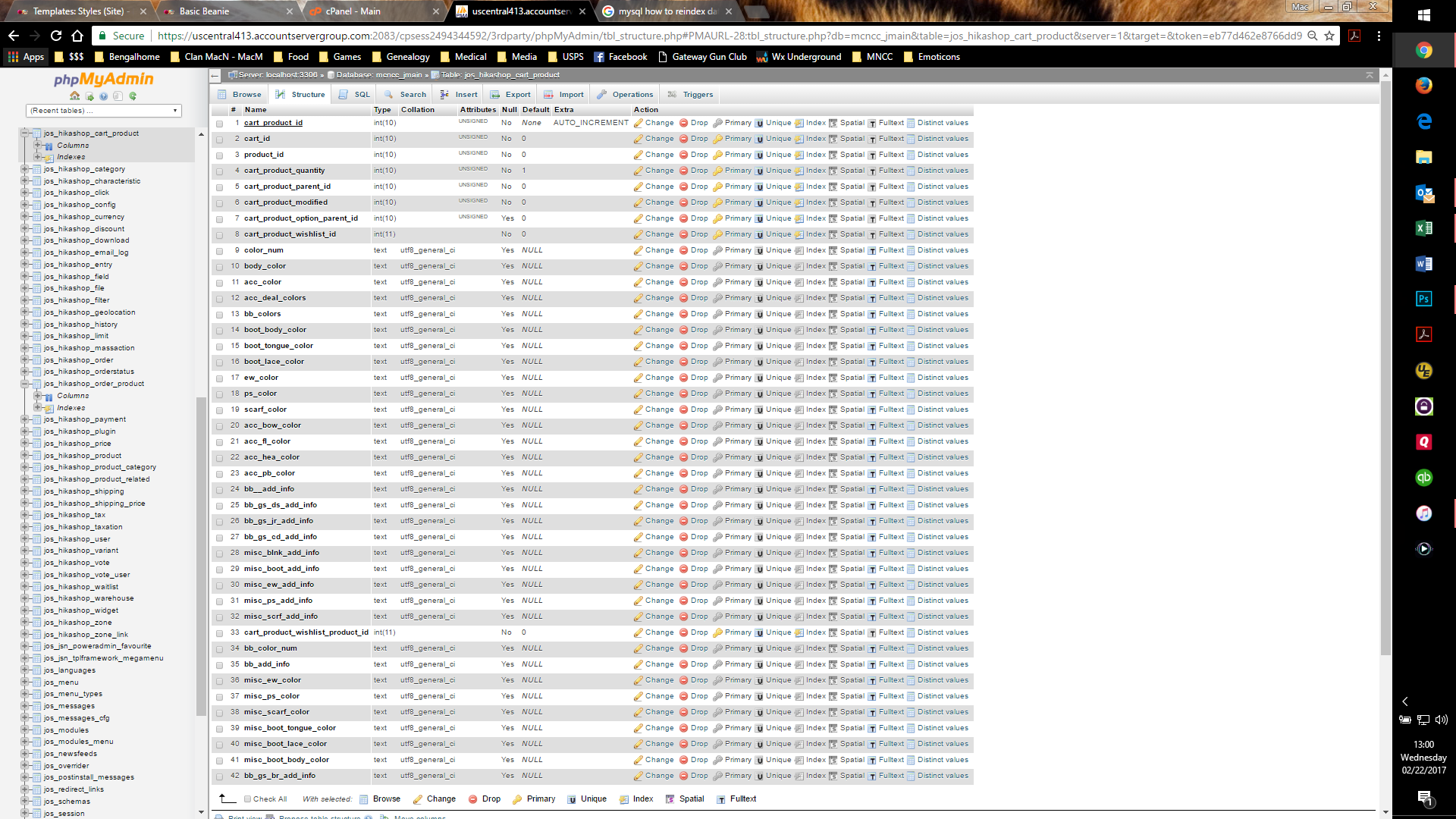

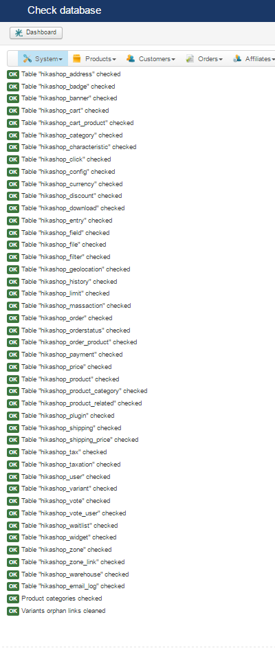

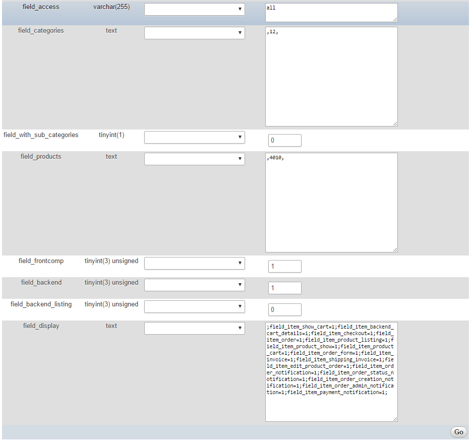

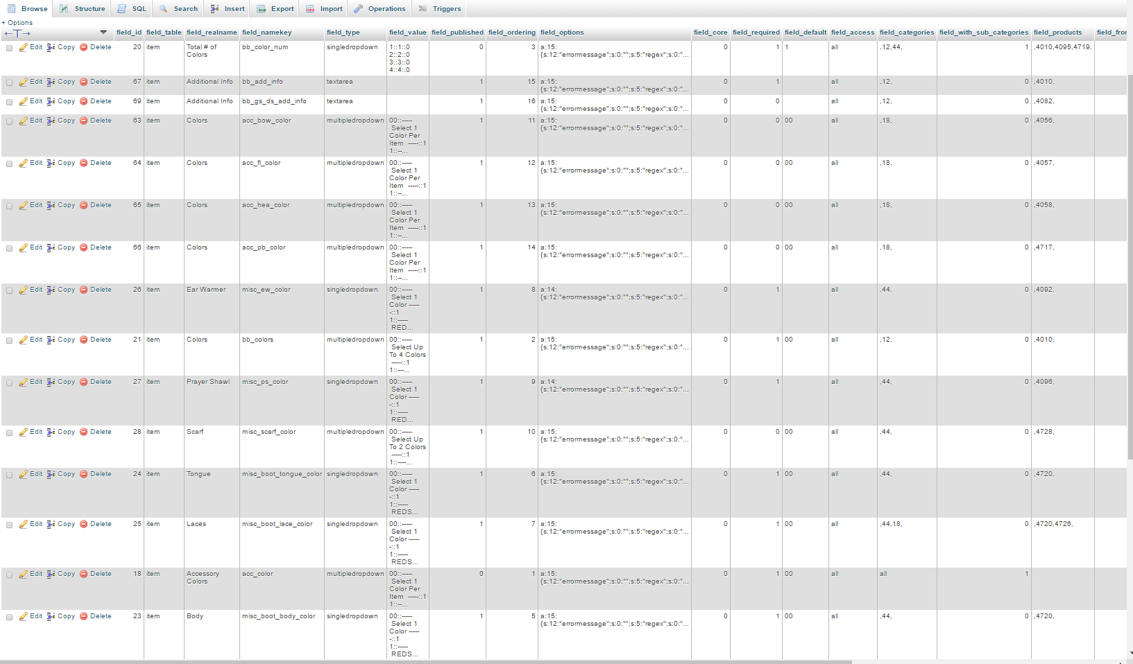

  • Posts: 23
9 years 5 months ago #263093

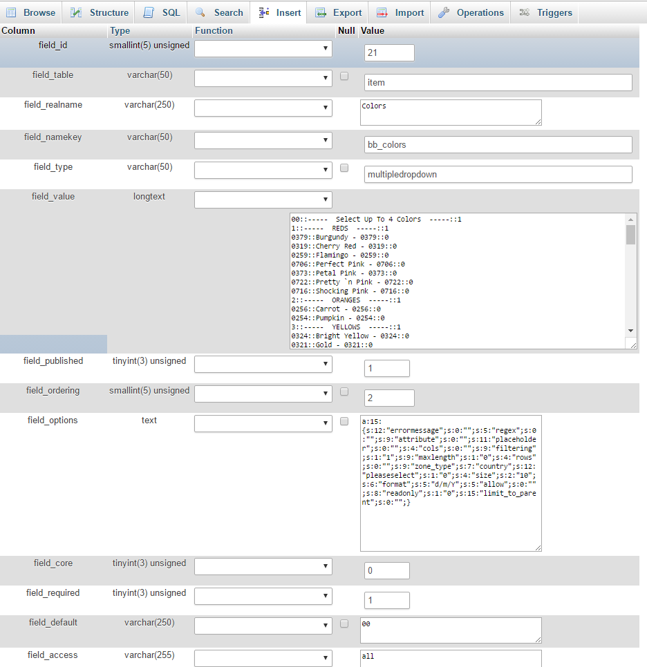

Jerome,
Thanks for your quick reply. I have checked everything you suggested but I don't see a problem. I have included screen caps of of the Database check results, the a portion of the phpAdmin listing of the customs fields I am having issues with, and 2 caps of 1 particular record.
I would appreciate you looking these over & tell me what I've missed.
Many Thanks,
Michael S. "Mac" Miller
Webmaster
Bengalhome Enterprises
This email address is being protected from spambots. You need JavaScript enabled to view it.

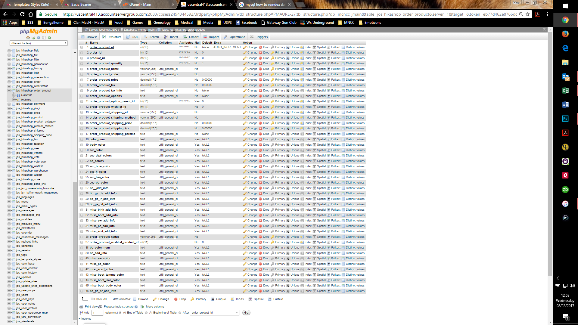

  • Posts: 26380
9 years 5 months ago #263125
Because your custom field is an "item" custom field, the corresponding column in the database should be in the table "cart_product" and "order_product".
Afterwards, we would need to exact error message of the SQL query error ; and if you can also provide the "callstack" it would be awesome.

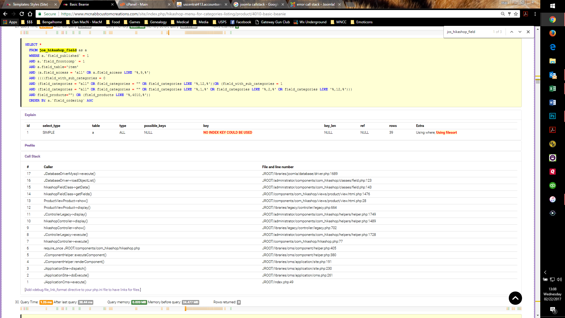

  • Posts: 23
9 years 5 months ago #263239

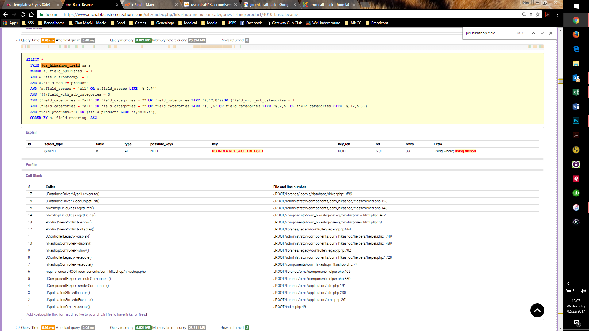

Jerome,
Here are screen caps of the jos_hikashop_order_product & jos_hikashop_cart_product tables plus 2 screen caps of the jos_hikashop_field callstacks. There were no callstacks for the order/cart product tables.
Webmaster
  • Posts: 26380
9 years 5 months ago #263242
I'm afraid that is not the error message that I was talking about :
I get a 1054 error "unknown column in field".
The error you gave previously is not the real error message and does not contain the "call stack" I was talking about.
