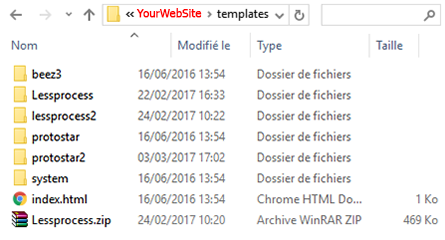

9 years 3 months ago #268123
you will find your template file in your website root file :
Go in YourWebSite/templates/TemplateName.
