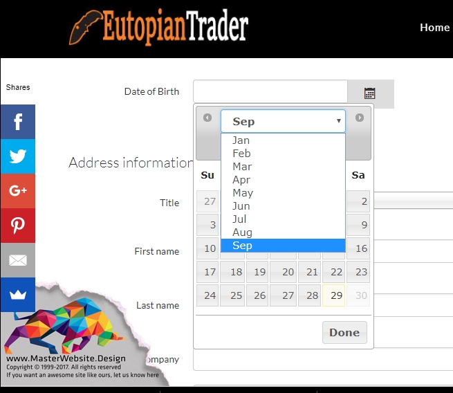

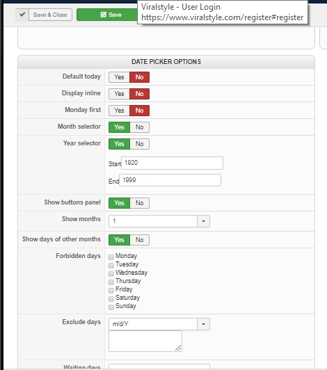

I hope I am not losing my mind here, but I had added a new field for my customer signin where I added a Date of Birth field and I chose to use the Advanced Data Picket in the hopes of making this a required field with a verification to set it so that a new user would have to enter a date that would show that they were 18 years old or older. I set everything up, but oddly, the month of October is not an option to be chosen.
I also set it up so that Start Year was 1920 End Year was 1999. The idea was that they could not pick a year for their DOB past 1999 as that would indicate they were over 18. Well for the most part it works, but I have found that if you choose a date and then change in in the same session, it doesn't always accept the change. It's almost like your first chosen date is stuck in the cache and unless you close the window and go back in, you can't select a new date. Also, again, the month of October is not available in the list of months and I am not sure why.
For now, I have to remove the date validation and just choose the simple date picker because the advanced date picker seems to have a number of issues. Can someone let me know what info you may need me to provide to help you look into this issue? If you would like to access to see what I am seeing, please let me know. Also, let me know and I will turn the Advanced Date Picker back on so you can see the issues I am seeing.
The attached SS should show you most of how I have it setup and the fact that OCT is missing from the choices of months.

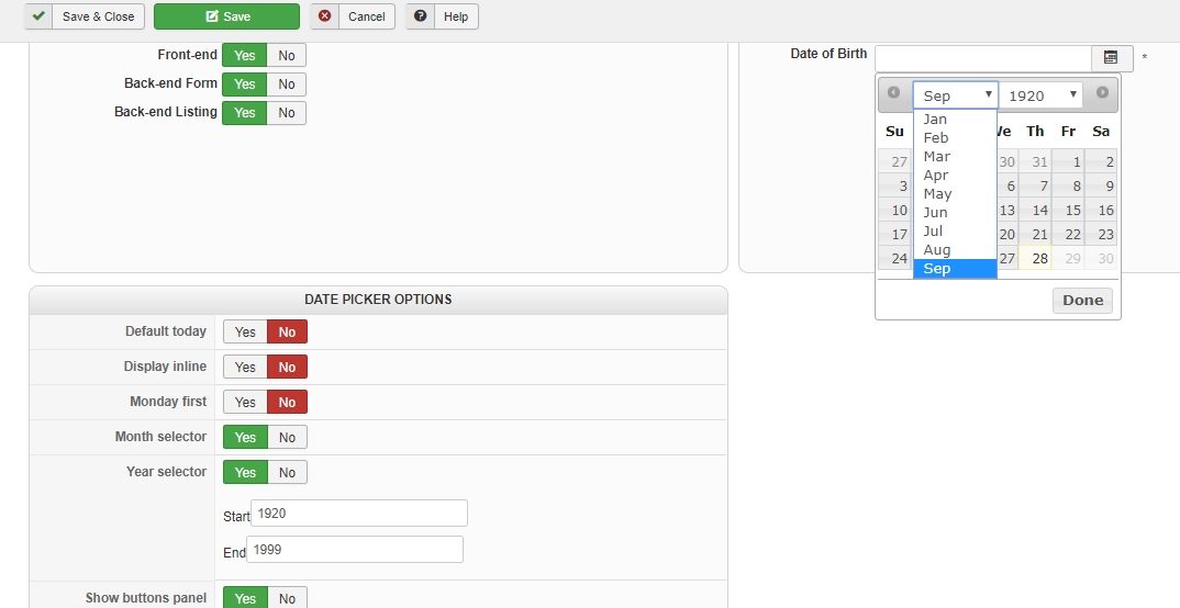

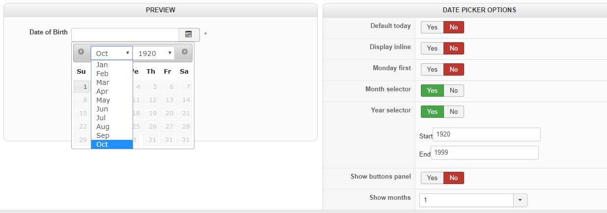

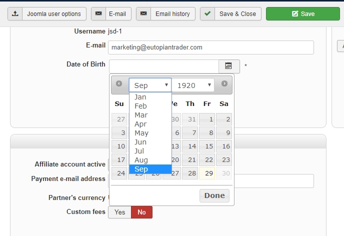

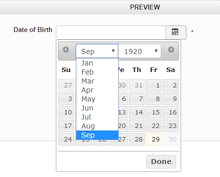

To reproduce this, create a new field in display / new field called DOB. Set up the new field using the Advanced Date Picker and configure it per screenshots.
Use the Test Calendar, edit hikashop / User, or use the new user registration form and select the DOB field opening the calendar and you will see in all places that October is missing from the choices.
The important thing is to set the dates to only show past dates, and set the start year to 1920 and end year 1999.
This should be easily reproducible. If you need any other information, please let me know exactly what you need and I will provide it.
The screenshots should be in the order in which this was configured / tested. ie 1. Create New Field, 2. Configure, 3. Test in the configuration using example calendar, 4. Test HikaShop User Editor, 5, Test New User Registration (using the Joomla to Hikshop user registration plugin.

I was able to get in the back end this time but am not getting this error in the demo site
Warning
Copy failed: /web/administrator/components/com_hikashop/falang/hikashop_category.xml to /web/administrator/components/com_falang/contentelements/hikashop_category.xml
However I was able to reproduce the missing months. If you check for the field Date of Birth, and you use the calendar example you will see that now the months November and December are missing from the drop down box for the month. See the screenshot.
This is the same problem I am seeing. So it appears that all months from the current month until January become missing.
(HikaShop Business 3.2.0 [1709061916])
