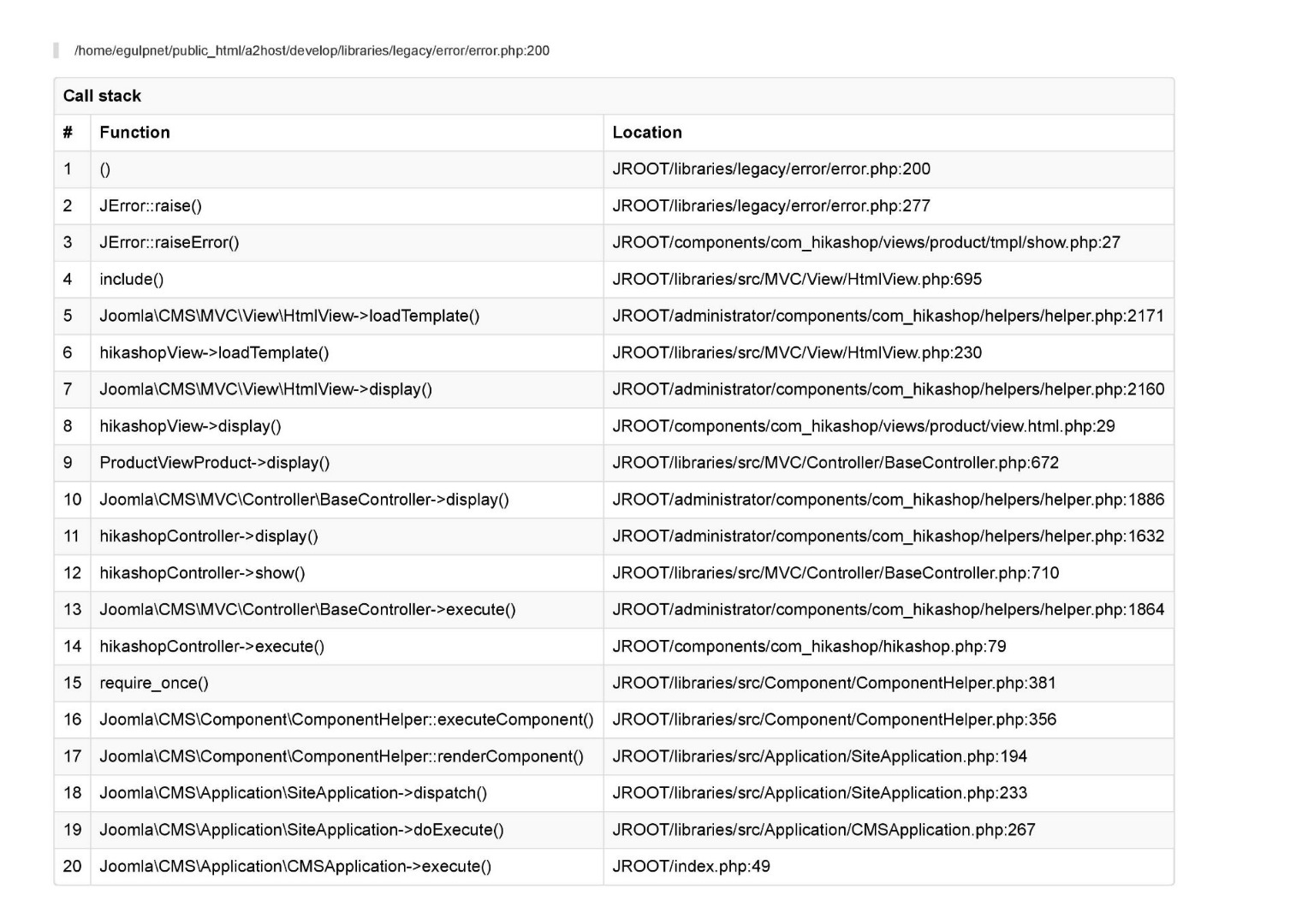

8 years 8 months ago #283047
Debug System: Yes
Error Reporting: Development
I had to switch to Protostar template (instead of mine that continue to giveme back only the blank page) to have back this report:

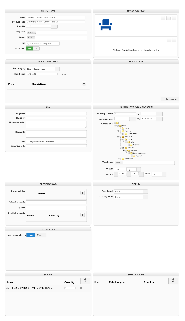

8 years 8 months ago #283051
Your problem has several layers to it:
1. There is a problem with the URL of the page which leads HikaShop to not finding the product to display for the link you're clicking on.
2. HikaShop then tries to display the 404 error page of your website through Joomla's API.
3. There is apparently an issue with your 404 error page which creates the fatal error.
First, try to replace the code:
JError::raiseError(404, JText::_('PRODUCT_NOT_FOUND'));
		echo '</div>';
		return;
to:
header($_SERVER["SERVER_PROTOCOL"]." 404 Not Found", true, 404);
in the file components/com_hikashop/views/product/tmpl/show.php
That should display the 404 error without going through Joomla.
Now that won't fix the real issue which is that there is a problem with your URL, but we would need to know more about that: screenshot of the product settings and the URL you're using to access that error page.

8 years 8 months ago #283188
so, I made the modification and:
1 - I have back the message: "Product not found"
2 - I attach the screenshot of the product settings. PS In Menus, the "Event" public menu is setted with alias as "convegno-aimfi-centro-nord-2017"
3 - "URL you're using to access that error page" - Here the product Menu Link on the copy test site
Thanks for support !

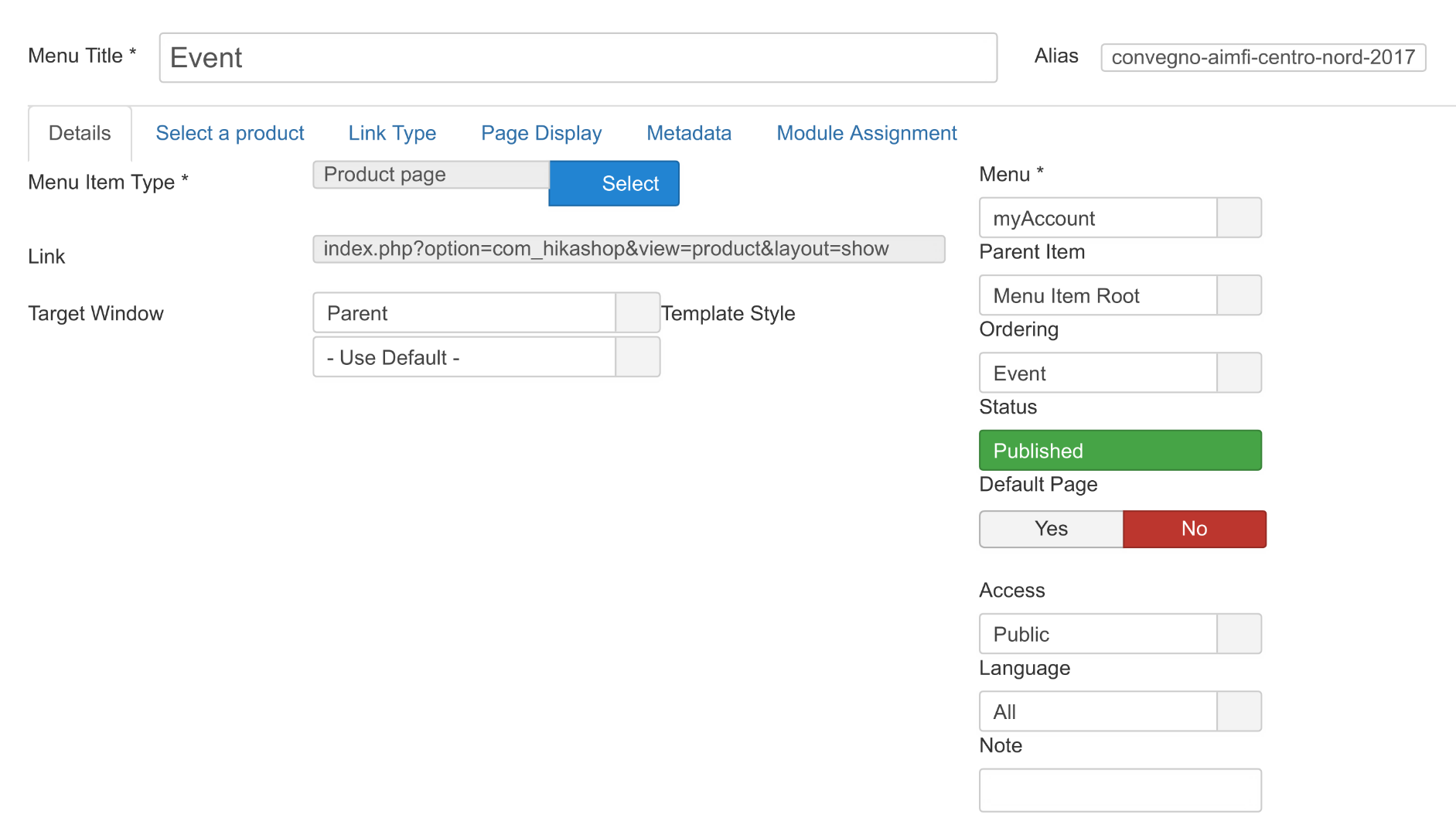

  • Posts: 461
  • Thank you received: 36
8 years 8 months ago #283242
thanks for helping:
1 - "Do you also have that "article not found" error when you try to access the link you gave ?" I'm too sorry, I made a mistake, I corrected it .
2 - "How do you get to that "Product not found" error page ?" = After trying I came back to the original file components/com_hikashop/views/product/tmpl/show.php. So now I have back the blank page. Please, let me know if I have to swith again to your modified file.
PS Menu Access: Public - Event Product - RESTRICTIONS AND DIMENSIONS - Access level: "XXX" - If the user is not assigned to that usergroup = blank page
Menu Access: Public - Event Product - RESTRICTIONS AND DIMENSIONS - Access level: "XXX" - If the user is assigned to the "XXX" usergroup = the Product page is shown rightly
3 - "How did you configure the menu item of that link ?" Here attached the setting image:
Last edit: 8 years 8 months ago by joomleb.
