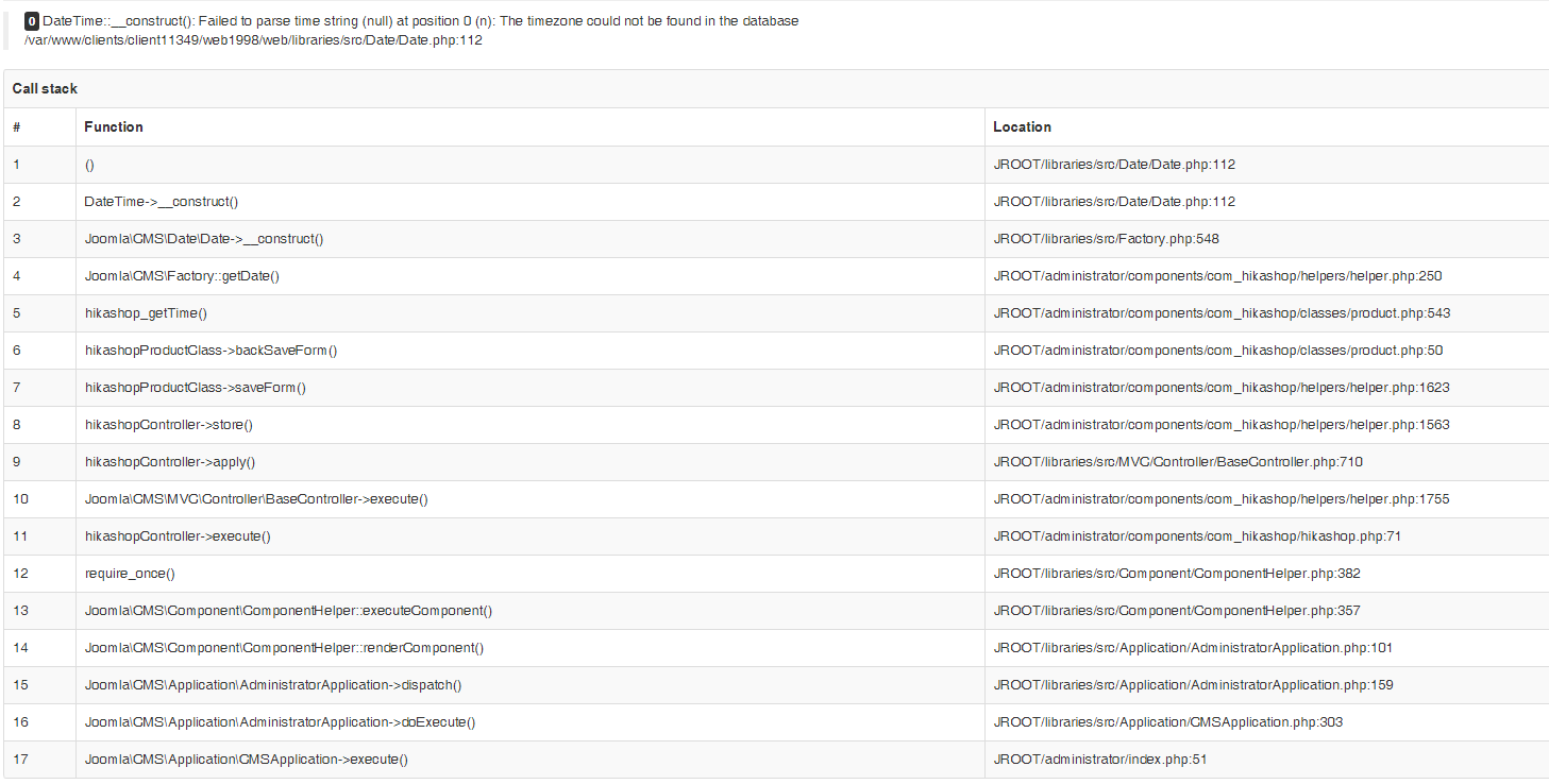

-- Error-message(debug-mod must be tuned on) -- : DateTime::__construct(): Failed to parse time string (null) at position 0 (n): The timezone could not be found in the database
Good day,
After installing the Hikashop component I want to create my first product. After entering te prize and saving the record I get this error message:
'DateTime::__construct(): Failed to parse time string (null) at position 0 (n): The timezone could not be found in the database'
What do I do wrong?
Thanks!

Thank you for your feedback. We've added a patch for that. Please download again the install package on our website and install it on yours and that will fix the problem.
