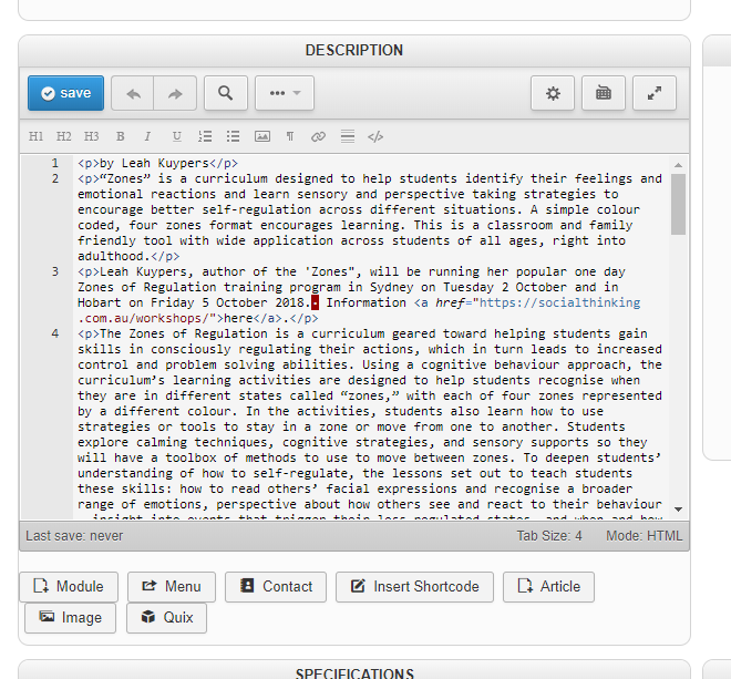

I have the joomlacontenteditor.com installed and want to use that instead of the limited editor
that appears to be the default editor for product descriptions. How do I change this?

Then there is something else happening here as my default editor was JCE but that was not the editor in HikaShop until I expressly went and set it to that.
