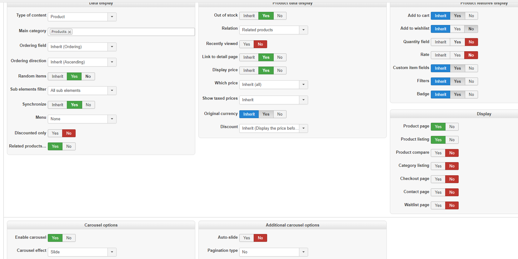

Right, however, it still will not display on the product page. The ONLY way i've gotten it to display is to add a product to cart and go to checkout. Then i can return to the product page and it displays (sometimes). I've also tried turning synchronize on/off, but same behavior for each. Below is a screenshot of the settings.

You have two problems I can see. I would indeed recommend to turn off the "synchronize" option, but also turn off the "related products of products in the cart" setting. Otherwise, the module will filter the products it is supposed to display to only display the products that are related to products that you already have in the cart. And thus, if your cart is empty, or that the products don't have any related products among the products the module is supposed to display, the module won't display anything.

That worked. I assumed the "related products" option was how you displayed the items you select as related products in the product edit page. Turning it off fixed the issue. I still need the "synchronize" option as that is the only way i can display the related products chosen on the edit product page.
