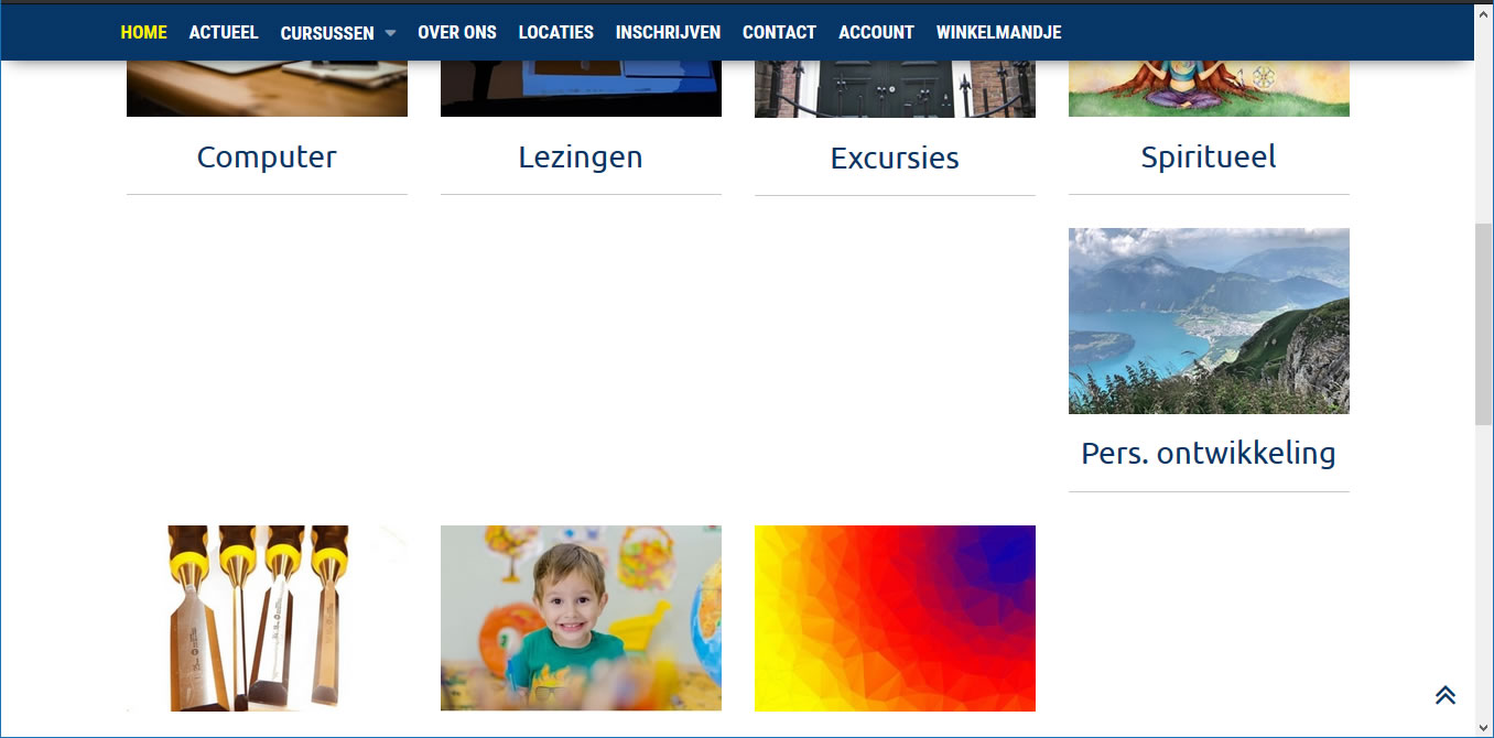

7 years 10 months ago #295693
The problem is on the forntpage because I have edit the image to be the exact right size for the category, but for the frontpage it gives still an issue:
The other images where added monbths ago and the PERS.ONTWIKKELING is new.
I'll keep on trying!
Last edit: 7 years 10 months ago by gasoline. Reason: add image
  • Posts: 26354
  • Thank you received: 4068
7 years 10 months ago #295694
Your image is a different problem and it's because the image for "excursies" do not have the same ratio than the other, so the resized image do not have the same height and it results that display.
Usage of the "consistency height" can help ; or using images with exact same dimension for your categories.

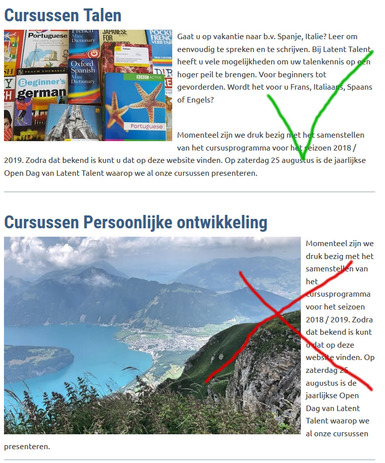

  • Posts: 85712
  • Thank you received: 14048
7 years 10 months ago #295759
The link you're giving displays a listing of products with the image of the current category at the top:
monosnap.com/file/HJgnpV8qpxGu14QicA98qu2ultslNs
It is normal that this image is the full size image of the category. That has always been so. That's actually the only place to display the original category image.
So if you don't want a category image so big, then reupload it with a smaller size and it will use it.
Otherwise, you can also add some CSS to force the size of the image, as you said.
