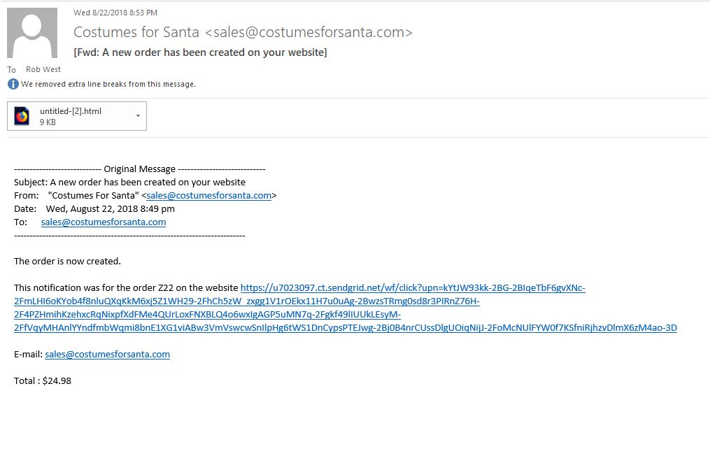

Hi - we are currently testing orders created and abandoned. Using PayPal.
1) When an order is placed, but, the customer gets to PayPal and DOES NOT complete payment, the Customer & Admin both get emails anyway. How can this be turned off? This is confusing! We only want orders emailed to the Customer and Admin when the order is PAID.
Otherwise, this could be confusing to the Shop Admin or the Customer, thinking they placed an order when they did not. The customer will call, thinking they've been charged, or the Admin may ship an order even though it was never paid for.
You can see a copy of the email to the Admin with the attached screenshot "order.jpg".

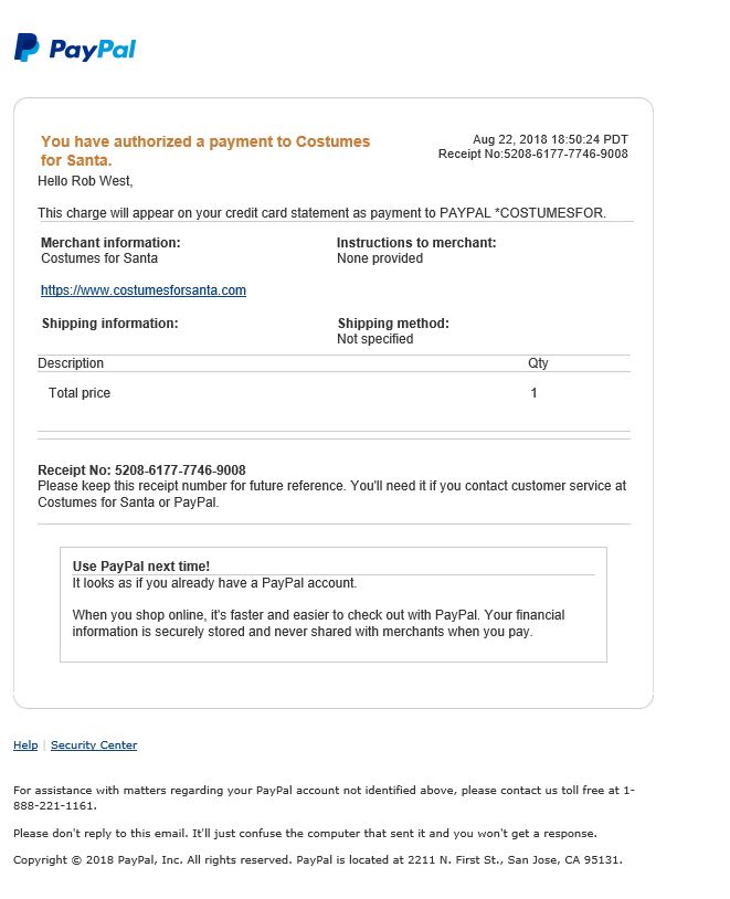

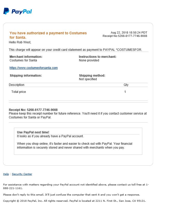

2) PayPal is sending a confirmation, but it has no real information! Please see attachment "paypal.jpg". Is your software NOT sending the correct info to PayPal? Or is this a PayPal issue where i need to contact them.

  • Posts: 86027
  • Thank you received: 14169
7 years 11 months ago #297063
1. You can go in the menu System>Emails and unpublished the "order creation notification" and "order administrator notification" which are sent when the order is created.
2. The PayPal receipt doesn't have any information because you must have the "send order details" setting of the PayPal payment method turned off in the menu System>Payment methods.
Also, note that when the payment is made, PayPal sends a payment notification request to HikaShop which then changes the status of the order to "confirmed" and that triggers again the sending of the "order status notification" to the customer and the "payment notification" to the administrator. So you shouldn't even need to take into account the PayPal receipt.

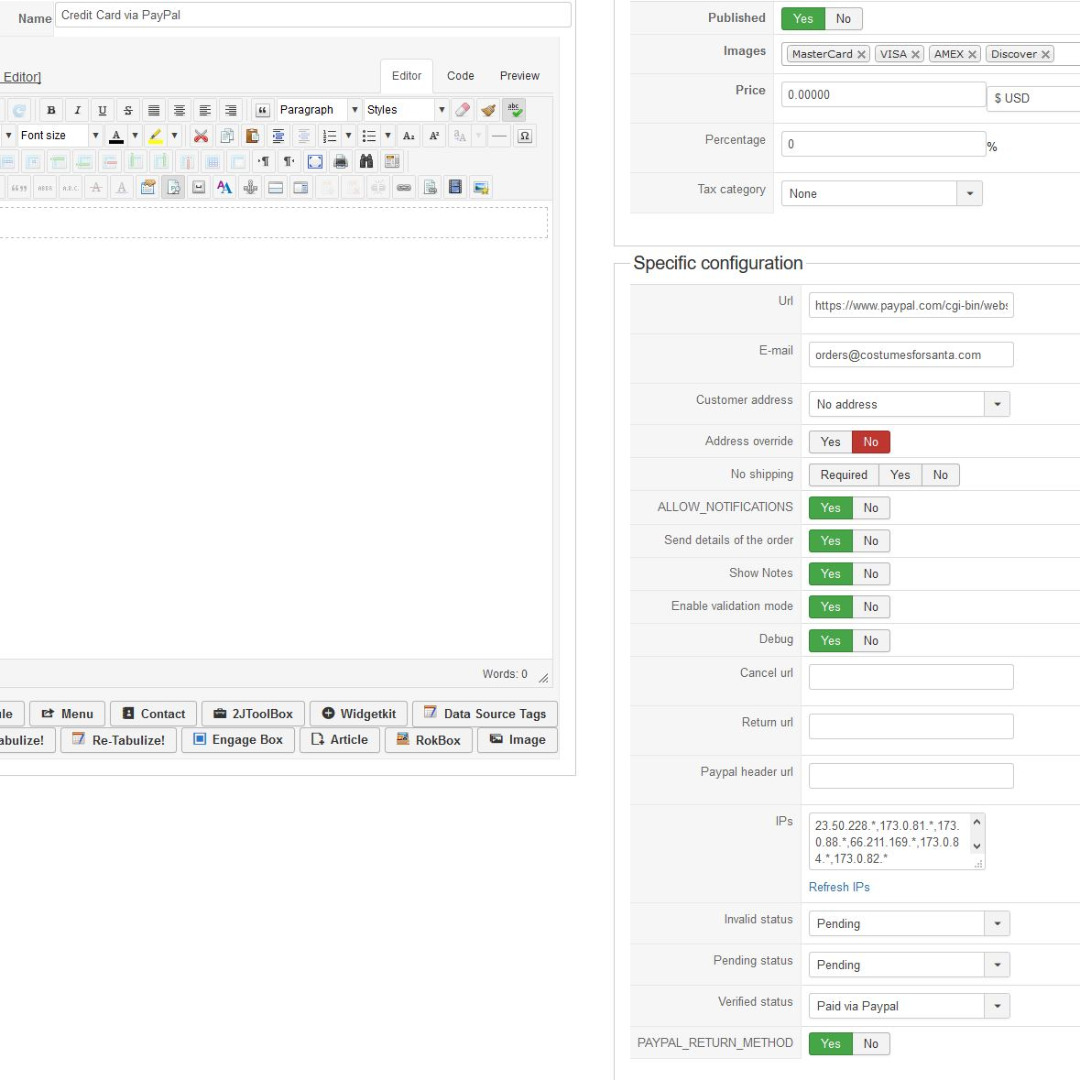

  • Posts: 24
7 years 10 months ago #298458

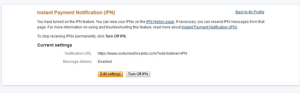

Hi Nicolas - thanks for the info. I did everything you suggested and it still doesn't seem to work. Please see screenshots. I also set language to UTF-8 within Paypal. Hopefully the PayPal setup screenshot will help, and attached log file i generated with Debug.
  • Posts: 86027
7 years 10 months ago #298467
In the documentation, you have this point:
Please make sure that the payment is accepted in your PayPal account. If the automatic validation of the payments is not turned on in your PayPal account, PayPal won't send the payment notification to HikaShop and your orders won't be confirmed !
I believe that this is your problem.
Looking at the logs, the payments have the "pending" status, meaning that PayPal is waiting for you to accept the payments in your PayPal merchant account. Only after you do that will HikaShop receive the payment notification and confirm the order.
That's because you have activated the "enable validation mode" setting of the payment method which does that. So you want to turn off that option, as it is the case by default, if you don't want to have to validate the payments manually.
  • Posts: 24
7 years 10 months ago #298474
Hey Nicolas - I think that was it...thanks! Maybe some of the other tweaks helped as well, but after changing 'Enable Validation Mode' to 'No' - I can confirm all is working. Thanks!
