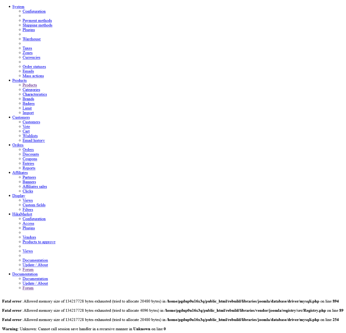

-- Error-message(debug-mod must be tuned on) -- : Fatal error: Allowed memory size of 134217728 bytes exhausted
I have been trying to figure out why I can't export products from my hikashop store, but I can't figure it out.
I go to products, as usual. I click on Export, as usual, but instead of generating the CSV file, I get the attached page.
I really need to get this figured out, so I would appreciate instructions on how to remedy this problem.
Thanks.
  • Posts: 86027
  • Thank you received: 14169
5 years 4 months ago #330610
When HikaShop generates the CSV file, it first need to load in the PHP memory the data of all the products that will be in the CSV.
This error indicates that the processus has hit the memory_limit that you set in your php.ini
So you need to either increase that memory_limit (you might need to ask your hosting) or reduce the number of products you're exporting at once.
