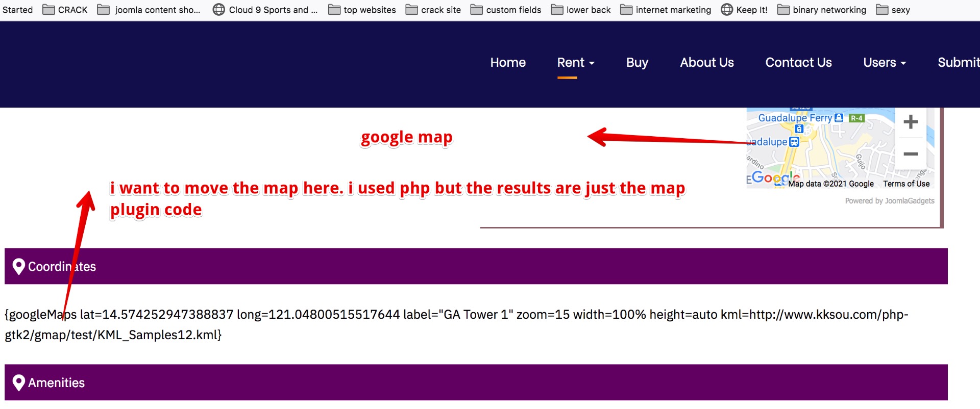

my problem is displaying the map on a different location of the page.
im using this code to call the map on the view product show_default
<?php echo '<div class="custom_field_bottom"><i class="fas fa-map-marker-alt fa-lg"></i> Amenities </div>'. $this->row->map; ?>
i don't want to display the map custom field on the right part. i want it on the bottom part.
Can you kindly give me the code to get the wysiwyg editor custom field and not just the content of the field?

5 years 4 months ago #330851
hi nic
thanks for the quick reply and sorry forgot the ss.
Please see attached it.

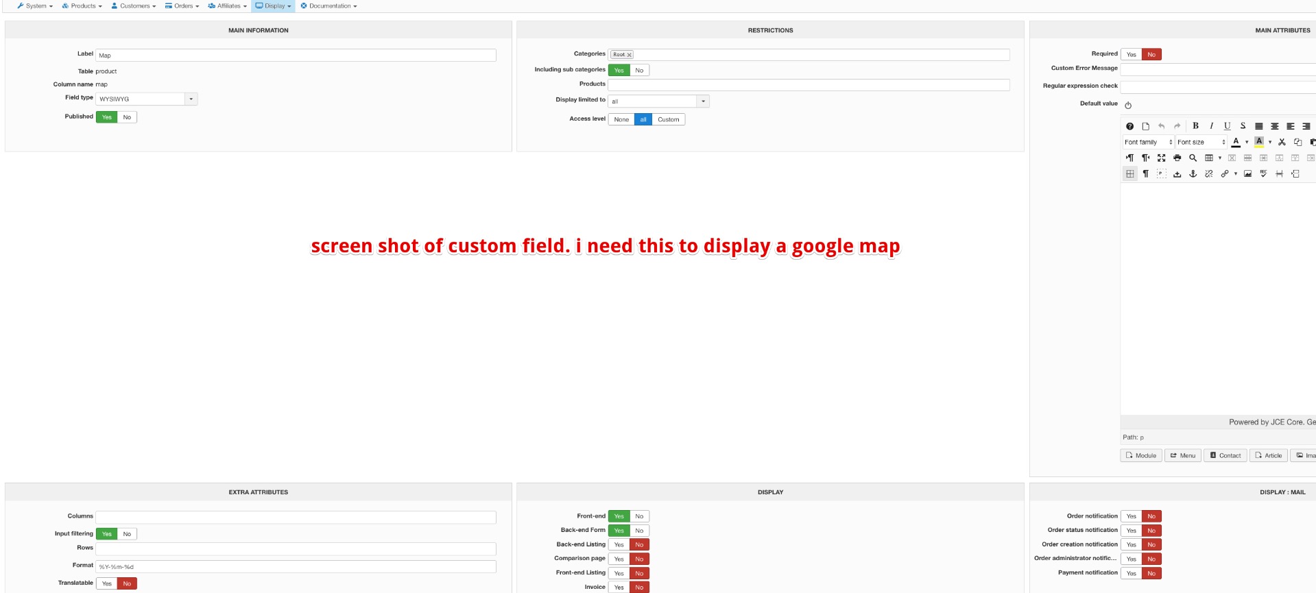

This is the custom field configuration
This is the url of the page affcon.net

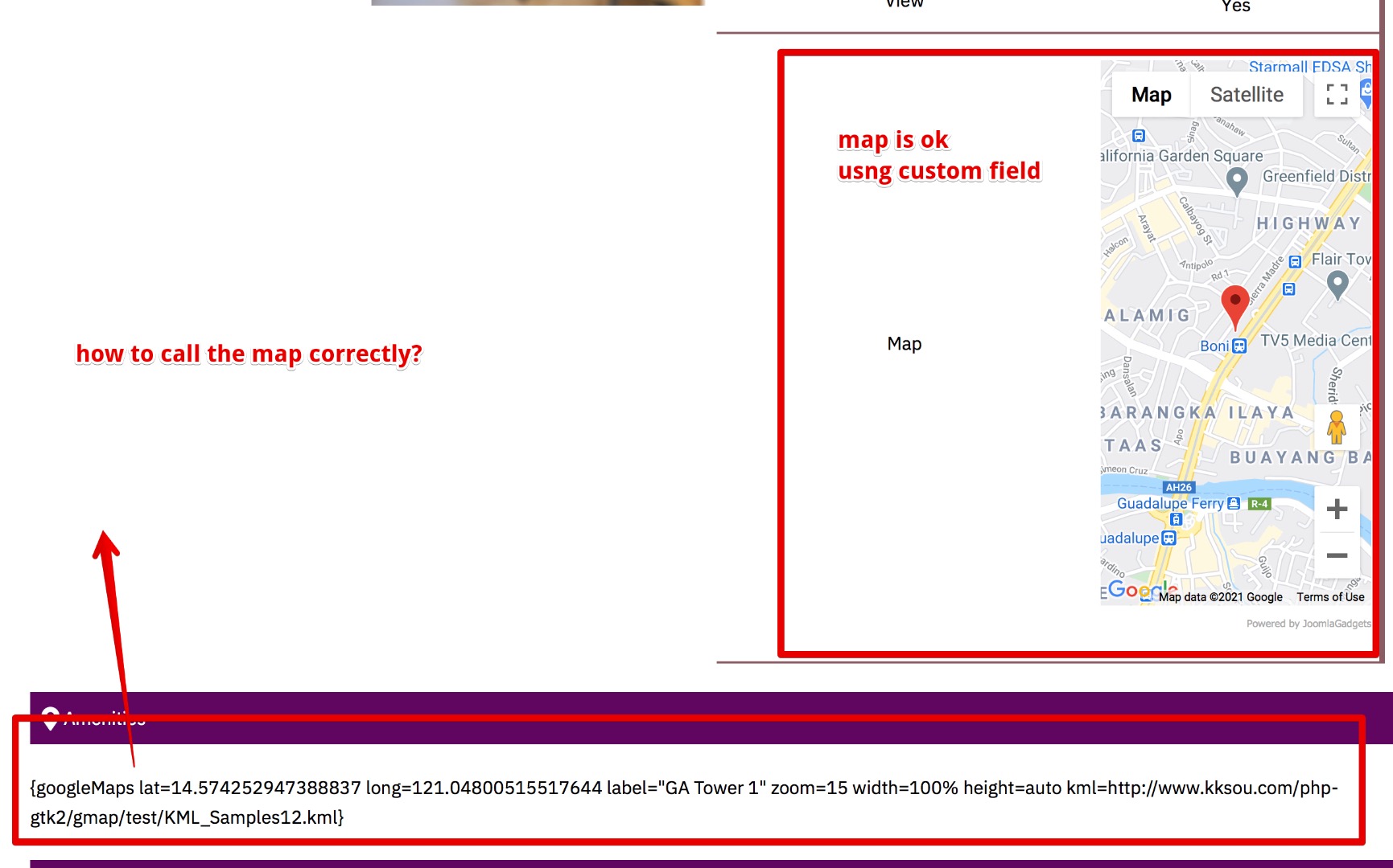

As you can see google map is working fine but It is displayed on the right side of the page. i want it to appear below and not on the right. i used php but the result is not the map but the code plugin
this is another ss

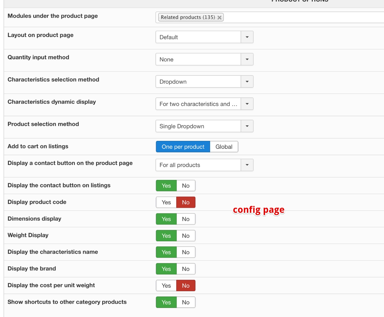

This is hikashop config

5 years 4 months ago #330853
Ok, so your question is about how to handle the display of a custom field so that the content tag in it is properly replaced by the corresponding plugin.
That's quite simple. Instead of:
$this->row->map
you need to use:
JHTML::_('content.prepare', $this->row->map)
