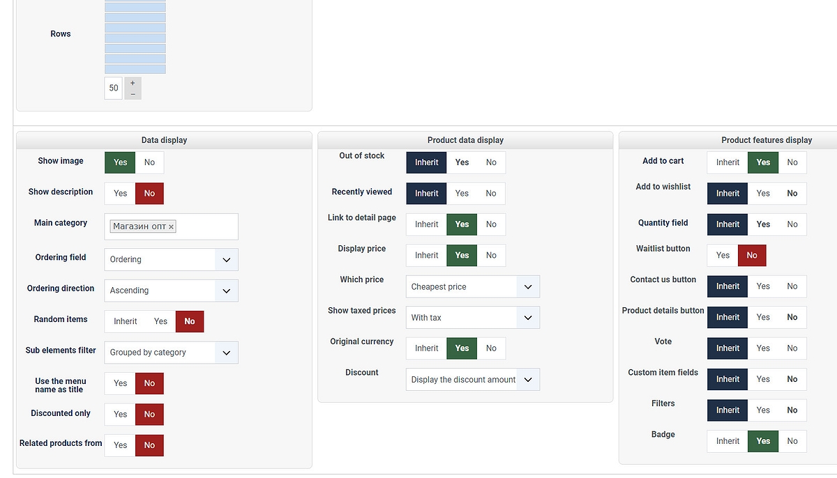

There are two sections and two separate menu items, a retail store and a wholesale store.
Each of these menu items has a different presentation of the products. In retail as a tile (div) and in a wholesale table.
Images are set to: Thumbnail 220x220 and main 400x400.
How can I set a different image size for the product table? For example 100x100.

In the menu item settings for the wholesale store, under the "products options" tab, you'll find a thumbnails setting where you can set a different size for the thumbnails displayed on the table listing.

Unfortunately, I have no such opportunity. Hikasop 4.4.3
What's wrong with me? Maybe some function is disabled?

That's a good point. We've added the display of the images to the table layout a while back but we forgot to have the image width/height options available when that layout is selected.
Switch to the "div" layout for your menu item and you'll get the images setting. Change the values in them and save. Then, edit the menu item again and change the layout back to "table" and you'll get the new thumbnails size with the table layout.
We'll look at adding these image size options for the table layout.
