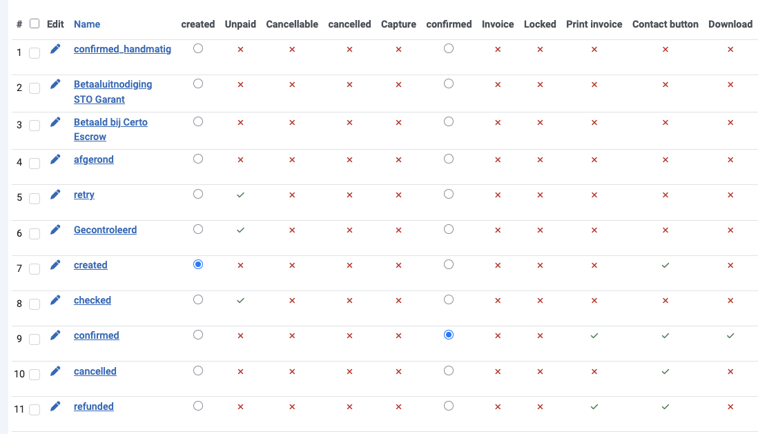

2 months 4 weeks ago #372091
OK, I have this working for the biggest part.
But it automatically sends the pdf with the "confirmed" orders. But I want to turn that off.
I thought I would disable that in the statusses configuration for invoice or print invoice, but that is not the case.
The help in the plugin says: "By default, the PDF invoice is attached only to the notification email when the order is getting confirmed (based on the setting in the configuration). You can configure here one or several statuses (separated by a comma) so that it overrides the status of the configuration. ".
But I cannot find out, where to change the configuration. And I cannot find any other support for this.
Kind regards
  • Posts: 86080
  • Thank you received: 14188
2 months 4 weeks ago #372092
First, please note that there are two different things:
- The "order status notification" email is sent by HikaShop when the order is confirmed by a payment plugin.
It is also sent each time you change the status of an order in the backend and you check the notify user checkbox.
If you don't want that email to be sent, you can unpublish it via the System>Emails menu.
- The plugin will attach the PDF to this "order status notification" email based on the status of the order and what you configured in the plugin or the "invoice" column on your screenshot.
All this means that even with all the statuses disabled for invoice, and even with the PDF invoice plugin disabled, the order status notification email will be sent to the user as long as it is published and the payment plugin changes the order status to confirmed.
If you still want that email to be sent but you don't want the PDF invoice to be attached by the plugin, then you can keep the email published and enter a status name different from "confirmed" in the order status setting of the plugin.
