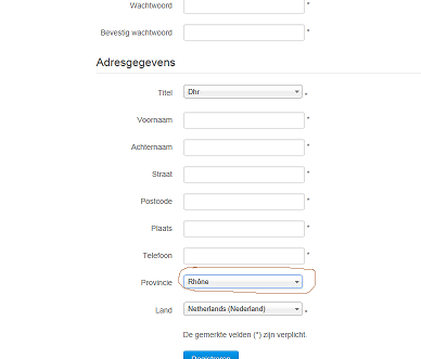

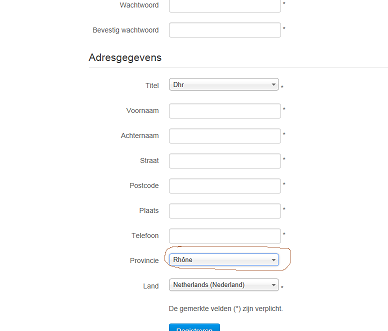

I have a problem with the customer registration form in the starter shop.
For some reason it gives a wrong state when people try to register (dutch/netherlands country with france states)
I cant find the solution and hope someone can help me
thanks, Michel

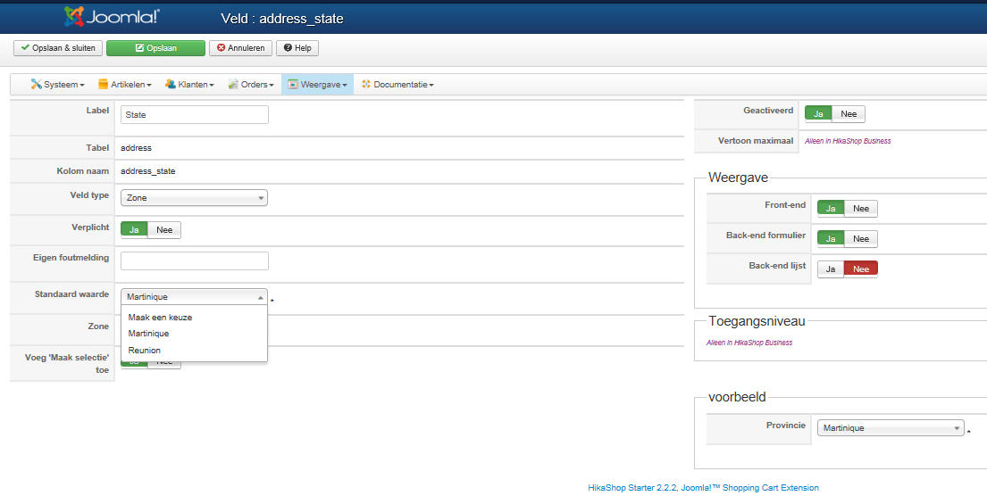

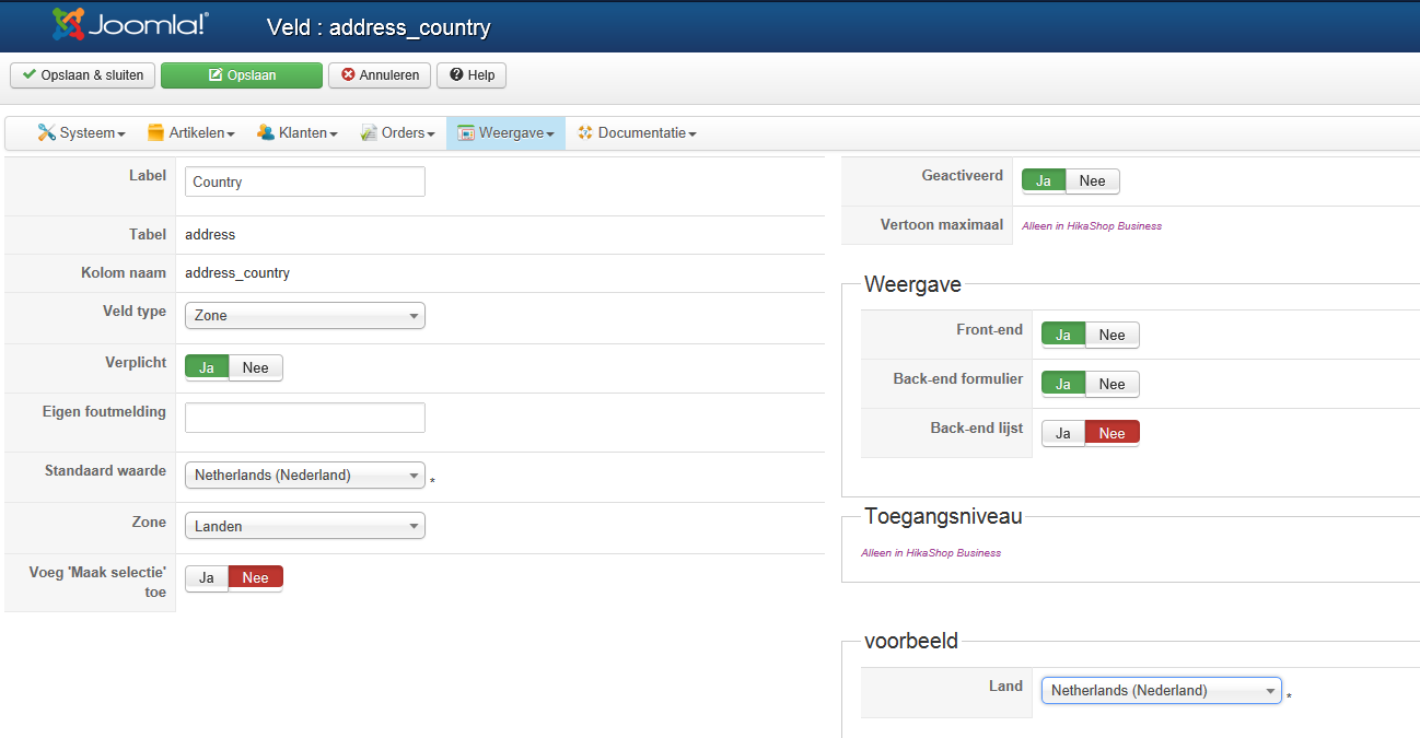

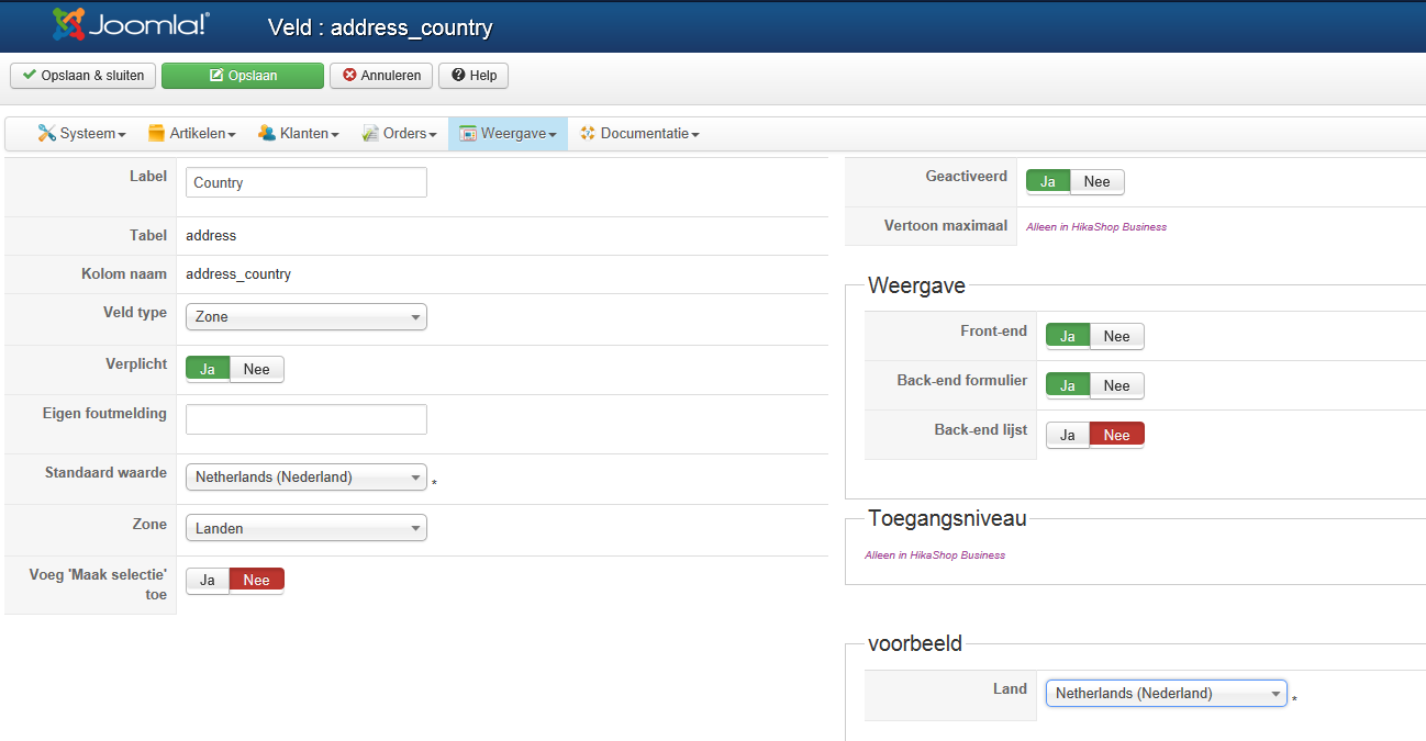

Can you show me some screenshots of how you configured your state/country custom field through "Hikashop->Display->Custom field" ? Also, reading this thread will probably help you.
  • Posts: 7

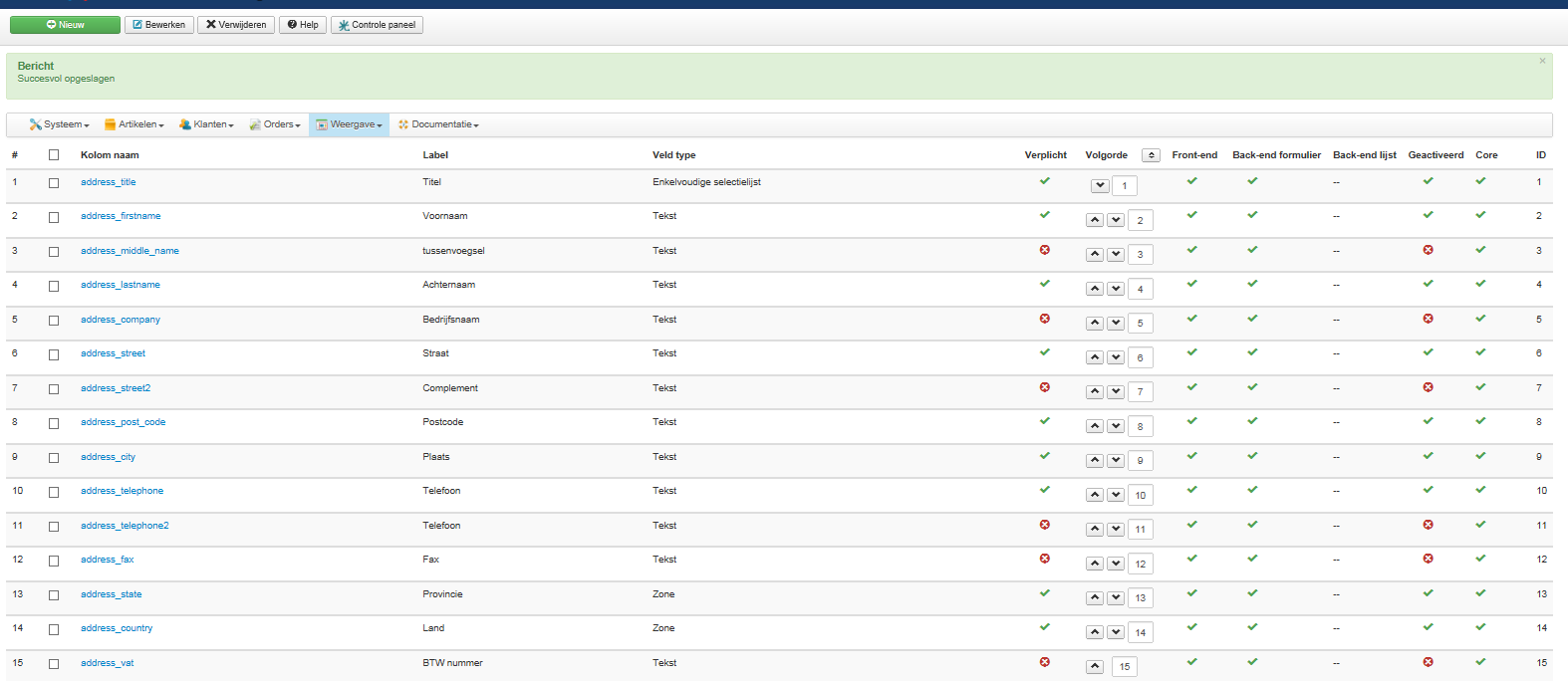

12 years 10 months ago #129103

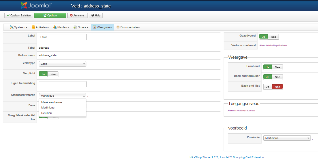

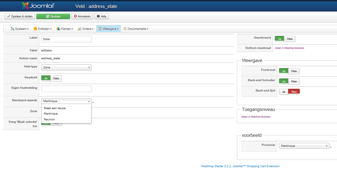

Here are some screenshots, the problem seems simular in the other topic, but still i dont see what iam doing wrong or forget.
i cant change the settings in the adress_state

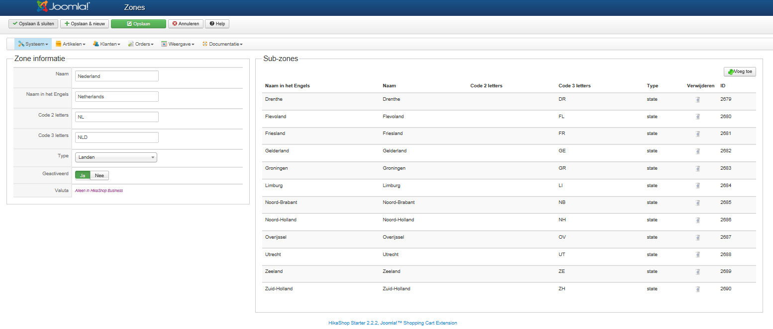

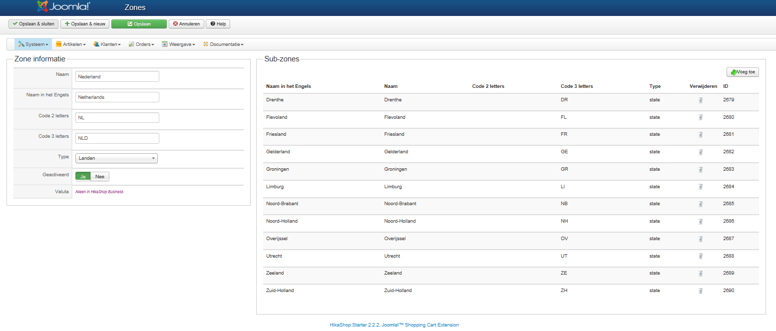

12 years 10 months ago #129391
Thanks to publish back the zones that you have maybe unpublished.
Then in the country custom field, try to set the value back to France, or Martinique (values suggested for the state dropdown).
Put back your country value for this field, then edit the state field to the desired state.
And finally you can unpublish again the undesired zones.
