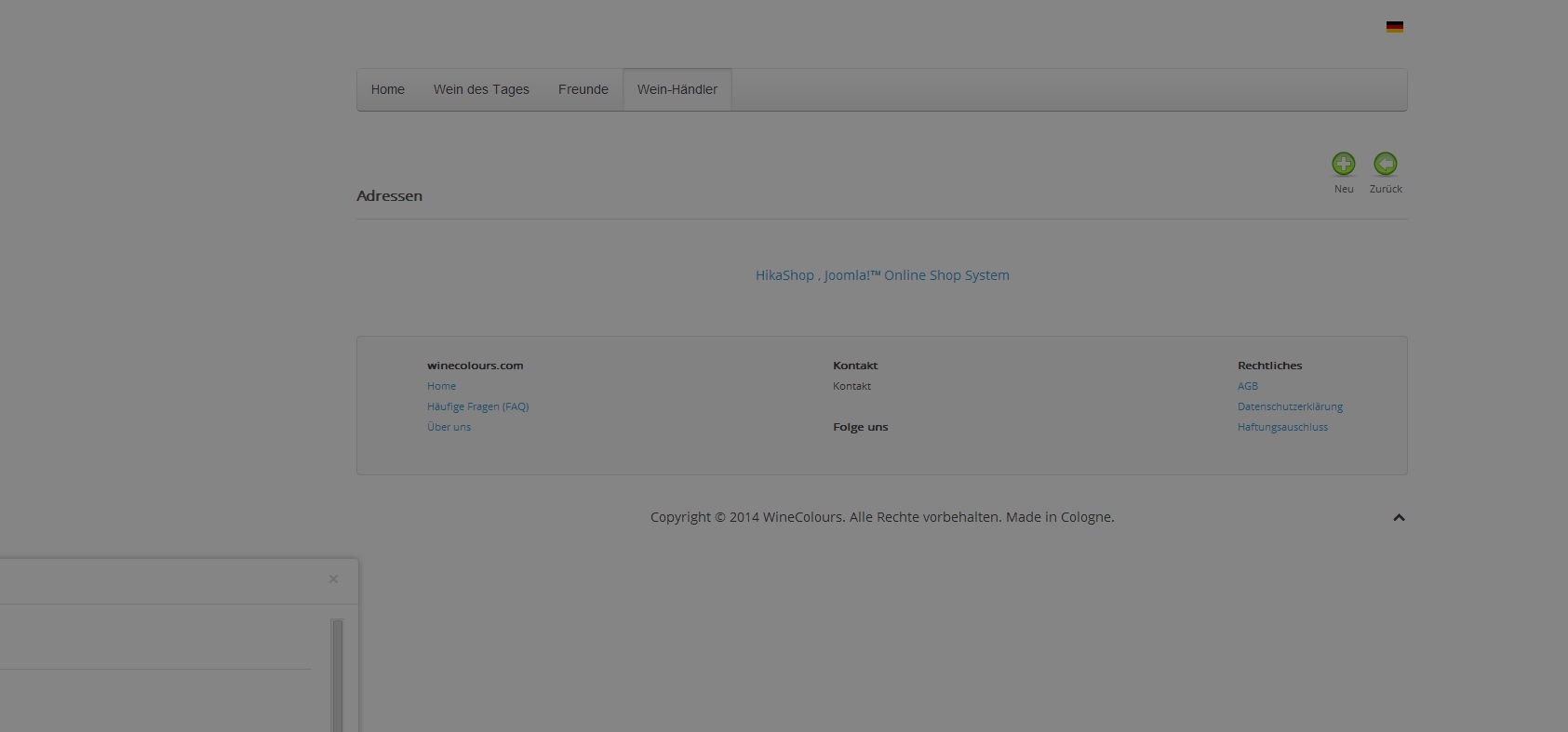

I am a new user of hickshop and actually installed it some minutes ago.
Joomla: Current Version 3.2.3
HickaShop: downloaded it minutes ago
Browser: Google Chrome / Firefox Current Version
Template: yootheme
Extensions: Admin Tools by akeeba
Problem:

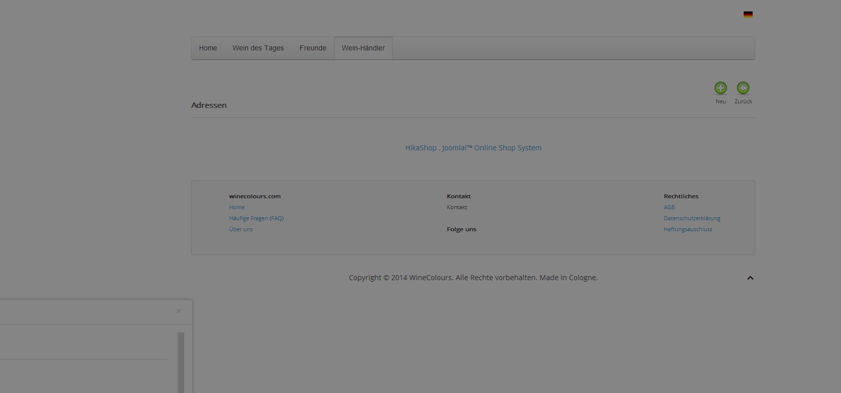

When I log in into the user account and the button "New" in the address administration then the screen fades to grey but no form is shown to enter an address. I can see a small part of a form in the lower left corner, but is behind the grey layer. I checked via firebug that all files are loaded without errors.
Thanks for the help and keep up the good work.
Andreas
  • Posts: 86180
12 years 5 months ago #149907
That's a bug of your template which doesn't handle the popups properly. Go in the Display tab of the configuration of HikaShop and change the "popup mode" to "mootools" and that should help.
The following user(s) said Thank You: WineColours
  • Posts: 9
12 years 5 months ago #149937
Thanks a lot. Changing the popup mode works perfectly.
