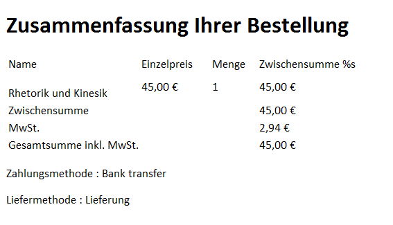

12 years 3 months ago #152265
I have the problem that the subtotal in the bill contains the VAT.
How I can correct this failure?
Thanks for your help.

I am doing exactly as you suggested in this thread however whatever I do, it does not seem to effect the subtotal.

I want to display the subtotal without VAT during the checkout process. In my opinion it does not make much sense to put sub total with VAT, the VAT under neath it and finally the total amount (same exact amount as the subtotal) :)
