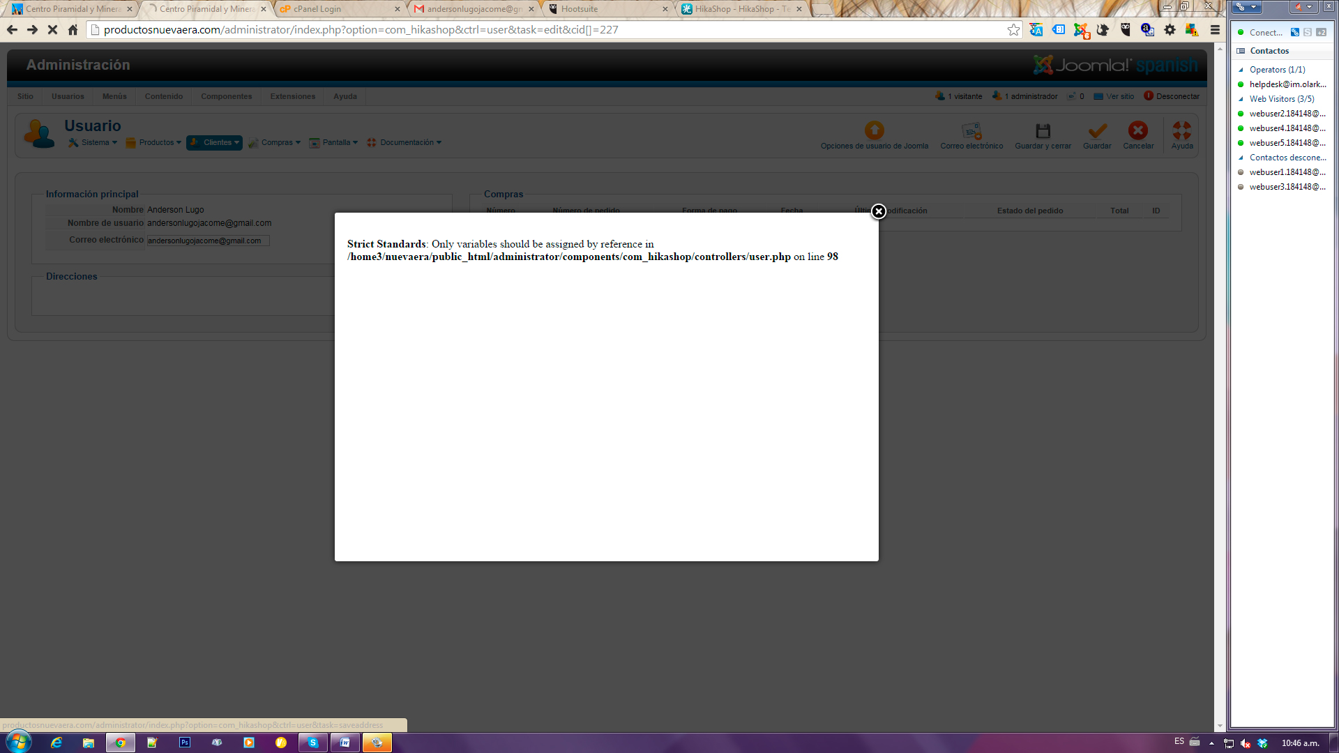

  • Posts: 13
11 years 11 months ago #173773
Hi, I have the same problem, but now the disable AcyMailing, but I still have the same error, no data are recorded customer address, attached the image of the message it gives me. Please help me :(

11 years 11 months ago #173775
Please provide some useful information like your HikaShop version number and details of your current error (the screen shot something but I don't know how you got it).

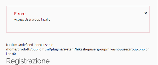

  • Posts: 4
11 years 8 months ago #183952
HikaShop essential 2.3.4
Joomla 3.3.6
I got a problem with account registration; a error box is shown "Error: Access Usergroup Invalid" and even though the registration is successful no address is recorded in the profile and is again asked during checkout. I switched on debug mode and see this message "Notice: Undefined index: user in /home/prodotti/public_html/plugins/system/hikashopusergroup/hikashopusergroup.php on line 40"
How can I fix this problem?
Andrea
  • Posts: 86180
11 years 8 months ago #184022
Try to disable the HikaShop group plugin via the Joomla plugins manager.
  • Posts: 4
11 years 8 months ago #184432
thank you! it did work. Only there was still a small problem with some links directing to the Joomla deafult registration form, leading to the same problem of missing address on the stored profile. I found a solution on a different post. Here the link, hope can be helpful if someone has this issue too:
www.hikashop.com/forum/3-bug-report/8726...trationredirect.html
