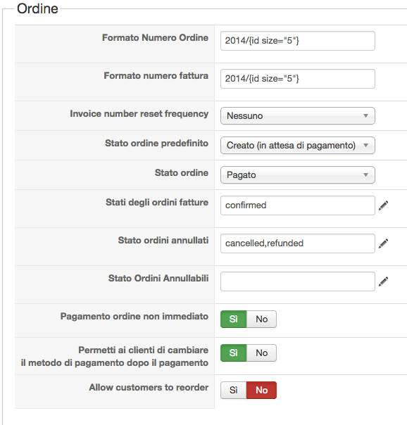

  • Posts: 177
11 years 11 months ago #174224
Hi Mohamed,
the setting is ok (please look the attachment file).
What i mean is after selection and after payment the the payment method isn't displayed.
Any Idea?
