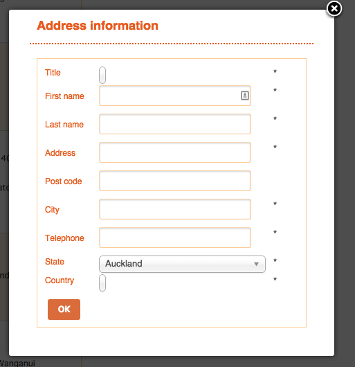

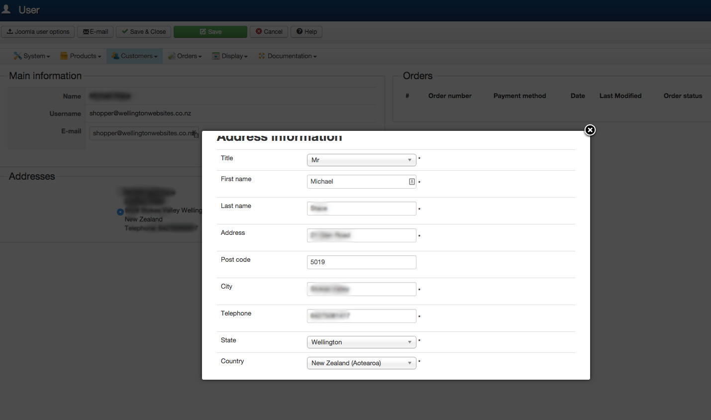

In the address template, the Country drop down is causing Google Chrome to crash (Aw Snap!) when it is selected from the back end or front end. Both Mac and PC versions are affected.
This occurs when editing an existing customer or adding a new one.
This works fine in Firefox.

From the front end, if you go in and EDIT an address, the TITLE and COUNTRY dropdowns are not populated.
This is true on any browser or platform.
I have checked the custom field settings and they are set to to be visible and to everyone.
Last edit: 11 years 6 months ago by MSTACE.

We tried both things on our end with Joomla 3.3.6, HikaShop 2.3.5 and Chrome and we don't have the problem.
Can you provide a backend access so that we can look at that on your website ?

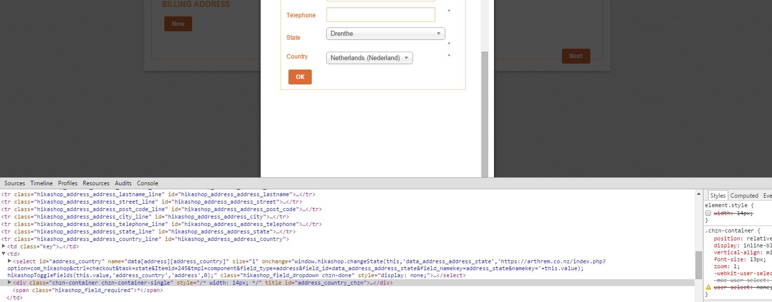

First, it didn't crash my google chrome.
Second, the issue is more link to CSS/Chosen than from HikaShop.
Please try to deactivate the "use chosen library" in your HikaShop configuration.
  • Posts: 293
  • Thank you received: 9
11 years 6 months ago #192303
Deactivating the chosen library worked. Not crashing Chrome now but I also found in the style_orange.css that several of the fields had a width set to 1px.
This was contributing to the problem as those fields were not selectable at that width.
#hikashop_address_form_span_iframe #address_title
#hikashop_address_form_span_iframe #address_country
#hikashop_address_form_span_iframe #address_state
