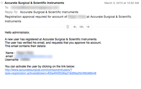

This is the email I receive currently.

  • Posts: 26376
11 years 4 months ago #195826
You need to override the email "user_account_activation" in your HikaShop email (System > Emails).
(please note that the email edition is provided by HikaShop Business ; version that you have, but just in case)
In the $data variable you will have access to all registration field that HikaShop had when the user registered.

  • Posts: 85952
  • Thank you received: 14142
11 years 4 months ago #195933
It's the "User account administrator notification" email.
For custom user fields, it's that code:
echo $data->user_data->field_column_name;
For custom address fields, it's that code:
echo $data->address_data->field_column_name;
And if the column name of your custom field is address_street, then it would be that code:
echo $data->address_data->address_street;
