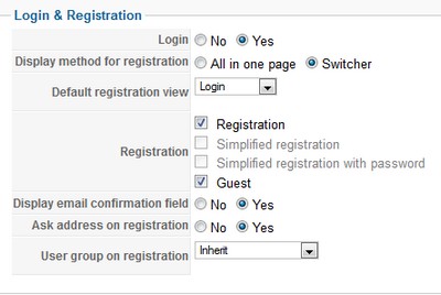

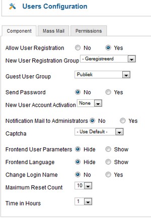

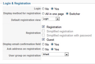

11 years 4 months ago #201555
Attached are screenshots of the registration configuration in Joomla and of the Login & Registration configuration in Hikashop.
The issue is not with just one account. It happens with all Hikashop users who first placed an order as a guest, and then try to place a next order and choose registration with the same email address.
Then a new Joomla user is created and the customer is logged in. But alas this Joomla user has not become a Hikashop user and once more the checkout asks for registration. The existing Hikashop guest account is not changed.
I hope this information helps.
Udo

11 years 1 month ago #209703
So can you show us how did you configured your checkout workflow through some screenshots ?
  • Posts: 220
  • Thank you received: 8

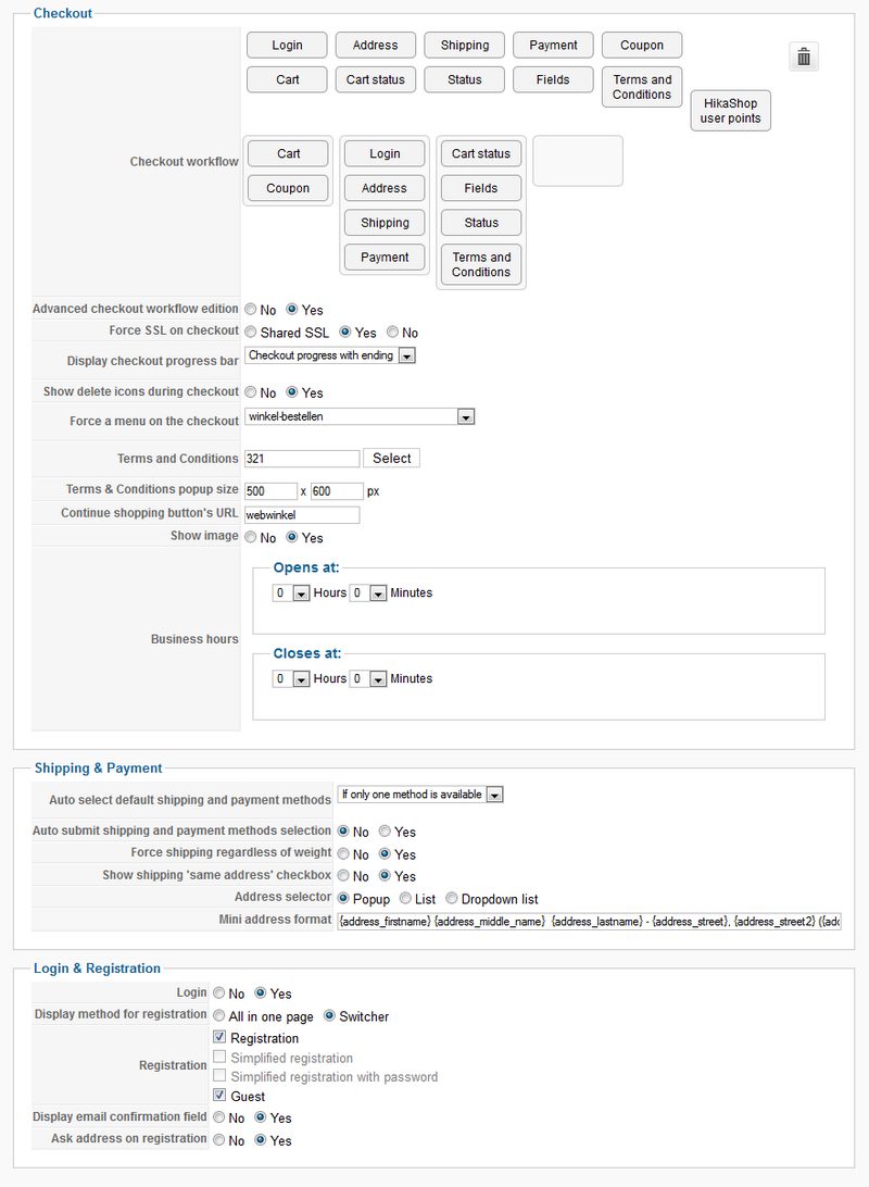

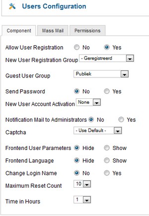

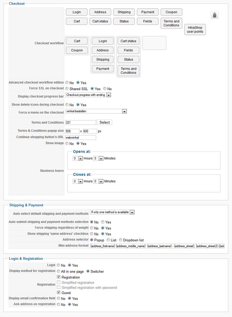

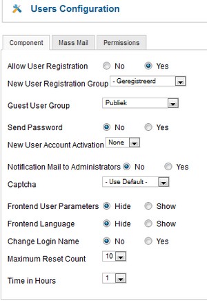

11 years 1 month ago #209750
In the attachment is the configuration of the checkout.
Also I've added the Joomla users configuration.
Hopefully this gives a clue.
regards,
Udo
  • Posts: 26386
  • Thank you received: 4078
11 years 1 month ago #210005
Regarding your current website data ; it looks like the account creation is partially done but the link between the HikaShop user and the Joomla user is not processed.
I think that's why we can see the "test hikahop" user in Joomla and also in HikaShop (but still as a guest account, without the link with the corresponding Joomla user).
I saw that you have a system plugin for form security checks (EasyCalcCheck) ; did you performed some test with that plugin deactivated ?
