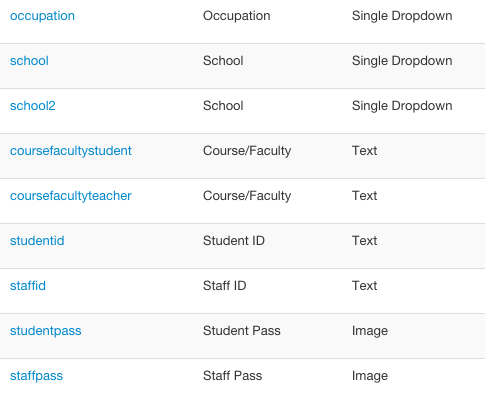

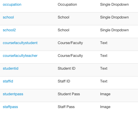

I have set conditional custom fields as follows:
if Occupation = others
- [none]
if Occupation = student
- school
- coursefacultystudent
- studentid
- studentpass
if Occupation = teacher
- school2
- coursefacultyteacher
- staffid
- staffpass

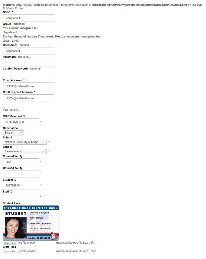

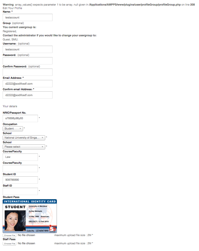

In the Edit Profile, the conditional are not in place and all fields are shown at the same time.
When I try to fill out only 1 set of fields, and submit, I get the error message shown.
Appreciate your help. Thanks!

The warning comes from the "profileGroup" user plugin you're using. That's not a HikaShop plugin.
Regarding the fact that you see fields regardless of their "display limited to" setting, add the code:
$requiredFields = array();
		$validMessages = array();
		$values = array('user' => $user);
		$this->fieldsClass->checkFieldsForJS($extraFields, $requiredFields, $validMessages, $values);
		$this->fieldsClass->addJS($requiredFields, $validMessages, array('user'));
after the code:
$fieldsClass->addJS($null,$null,$null);
		$fieldsClass->jsToggle($extraFields['user'],$user,0);
in the file plugins/system/hikashopuser/hikashopuser.php and that should fix that behavior.

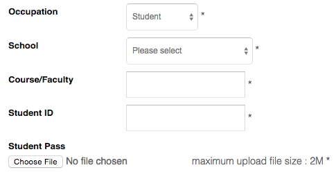

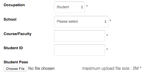

I've checked and I could see that you were missing some other patch we had before. I've added them all for you and it's now working.
  • Posts: 22
10 years 11 months ago #212372
Hi, thanks.
Yes I see the fields are now conditional.

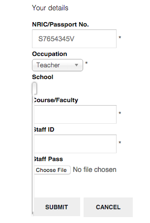

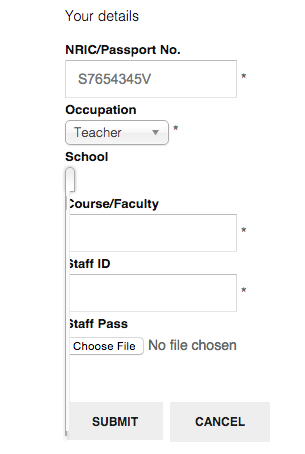

However, if I select "Teacher", the dropdown for school has no options in it.

That's an issue with the chozen library. I don't know why it does that.
Try to add that CSS on your website:
#hikashop_user_school .chzn-container-single-nosearch{ width: auto !important; }
If that doesn't help, you can also turn off the "use chozen library" setting of the HikaShop configuration and that should circumvent the problem.

  • Posts: 22
10 years 11 months ago #212461
The chosen library was already turned off. And the CSS didn't work.
But I managed to get it working with
#school2_chzn { width:219px !important;}
Apparently something forces a width:0 on this div.
Thanks for your help in this. Really appreciated.
