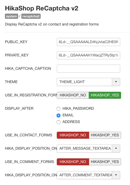

  • Posts: 64
8 years 3 months ago #293451
See the attached screen shot. Is this correct?
I disabled the other plugin which is named Captcha - ReCaptcha.
The reCaptcha does appear on the Hikashop page were we ask for a person's email address.
Any other forms outside of Hikashop for other purposes the reCaptcha is there.

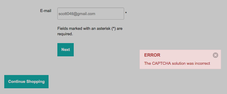

We are having an issue with some people that come to the site to order what the site sells. They say "Some users are not seeing a captcha but they are being told the solution to the captcha is wrong and they cannot order."

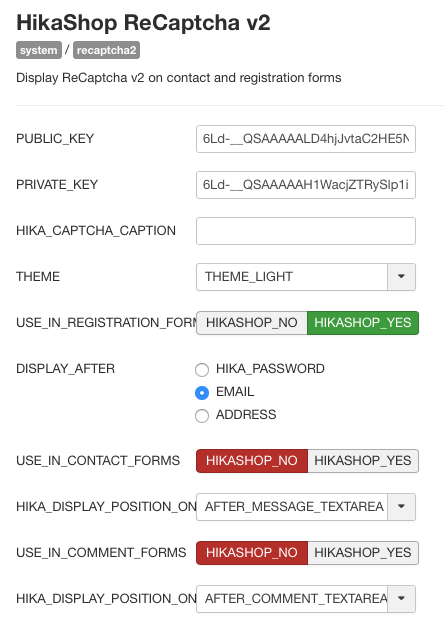

  • Posts: 64
8 years 3 months ago #293483
Three files included in this message. Two are from our Dev site and the recapture works just fine. On our Production site it doesn't and the recapture doesn't even appear where its supposed to. I'm at a loss as to what the problem is being that both cap plugins have the same settings.

8 years 3 months ago #293462
The way you configured the plugin it will only display itself on the registration form of HikaShop and Joomla.
It won't display in any other form and won't interfer with them.
If you see the the recaptcha of the plugin on the checkout, then, as long as you fill the captcha correctly it will work.... unless another captcha system interfers with the registration process. If that's case, then please check that the "Default Captcha" setting of the Joomla configuration is set to "none" and that the " Captcha" setting of the user manager options of Joomla is also set to none.

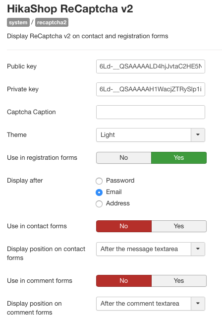

  • Posts: 64
8 years 3 months ago #293492
I don't understand what you're saying in your reply. Its confusing.
I just looked in the Joomla Global Configuration Site tab. Default Captcha is set to Captcha - ReCaptcha. You saying I should change it to None?
Are there any other settings that need to be changed? If so where are they?
Should I leave the settings as they are in the screen shot that I posted here?
Will the reCaptcha still be on forms outside of Hikashop if I change the Default Captcha is set to Captcha - ReCaptcha to none?
I also have a reCaptcha plugin other than Hikashop's. Should I keep that disabled or enable it?

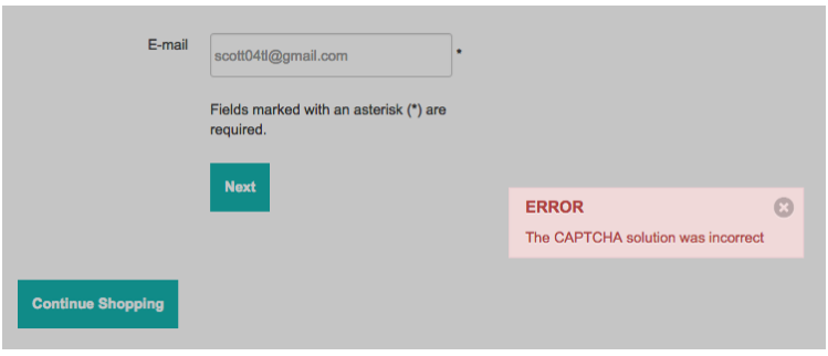

  • Posts: 64
8 years 3 months ago #293497
dev.radata.com/radon/buy-radon-test-kits/product/1-home-radon-test-kit-2-pack
reCaptcha is working here.
In the Joomla Global Config, Default Captcha is set to None Selected.
In the Extensions Plugins both Captcha - reCaptcha and Hikashop reCaptcha v2 are enabled.
www.radata.com/radon/buy-radon-test-kits...adon-test-kit-2-pack
reCaptcha isn't working here.
See the included screen shot.
So as you can see all settings are the same but yet on the Prod site it doesn't work and on the Dev site it does.

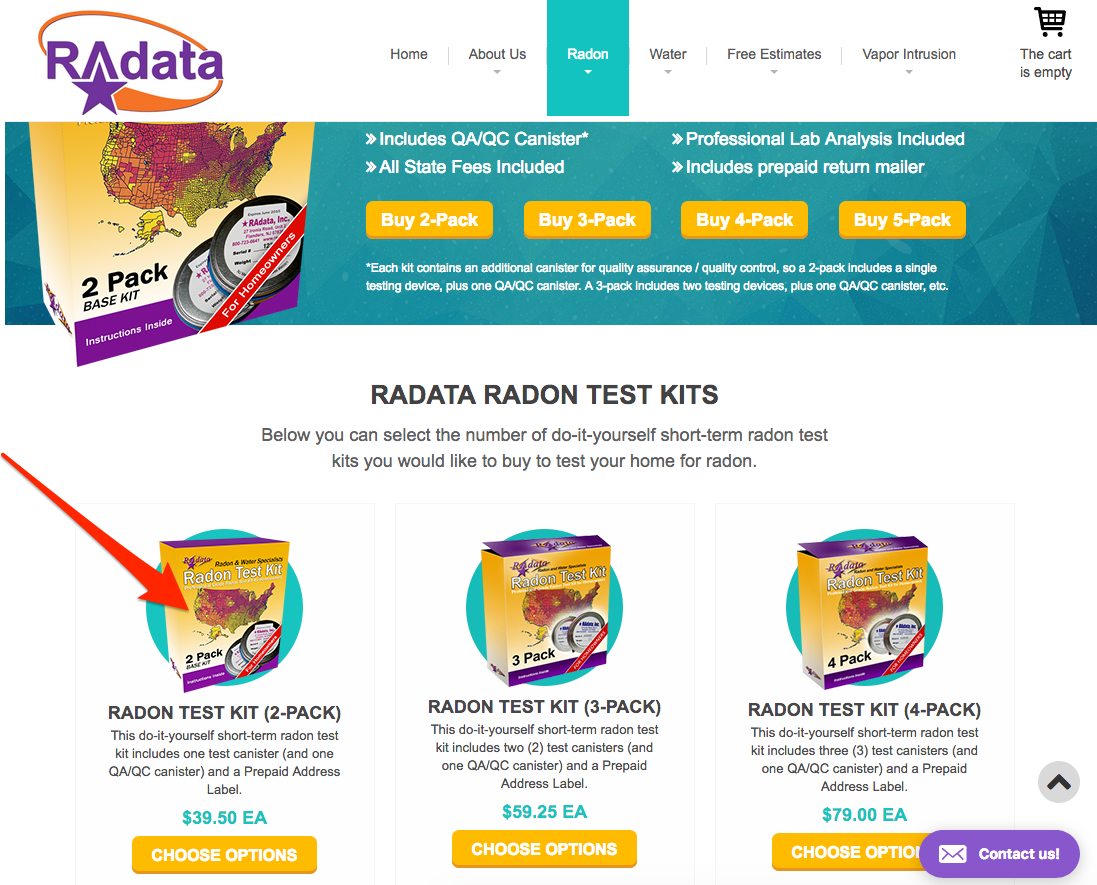

  • Posts: 64
8 years 3 months ago #293606
See the attached screen shot. You clicked on the wrong one. Go back to dev.radata.com and click on the item that I have a red arrow pointed to.
On the dev site the captcha works and can be seen.
Its on the prod site radata.com that it doesn't work. I've said this over and over again. I had disable Hikashop reCaptcha on this site because it was stopping people from ordering and we can't have that. If you look back at the prior screen shots you'll see that when I had it enabled that error appeared.
Upgrading Hikashop to the latest version I highly doubt would fix the reCaptcha problem and who knows what other problems may occur. Something with the ordering process may break and the programmer that set it all up isn't available to me anymore.

The only screenshot you provided of the issue so far is on this message:
www.hikashop.com/forum/customers/879744-...v2-issue.html#293497
And on this screenshot the captcha doesn't appear but the error message appear.

  • Posts: 64
8 years 3 months ago #293685
As my message said but you skipped over it look at the screen shot from a prior message I posted so here it is again included in this message. This is from the production site radata.com - I had to disable the Hikashop reCaptcha because it was stopping people from ordering but I wanted you to see the error again before I disabled it.
There are three reCaptcha in Joomla. Hikashop reCaptcha, reCaptcha (that are plugins) and Joomla's reCaptcha that is found in System Confiq.
Which ones should be enabled and which ones disabled so that the Hikashop reCaptcha doesn't put out the error?

On this screenshot there is an error message and no display of captcha.
So the reason you don't get the display of the captcha is either that you have the recaptcha v2 plugin we provide disabled, or that the view has been customized in a way preventing the plugin to display itself.
If the recaptcha v2 plugin is disabled, then the error message you get on that screenshot doesn't come from the recaptcha v2 plugin, but another plugin that you should deactivate.
If the plugin is enabled, then it's normal that you get the error when it can't display itself. And in that case, you want to follow the indications there:
