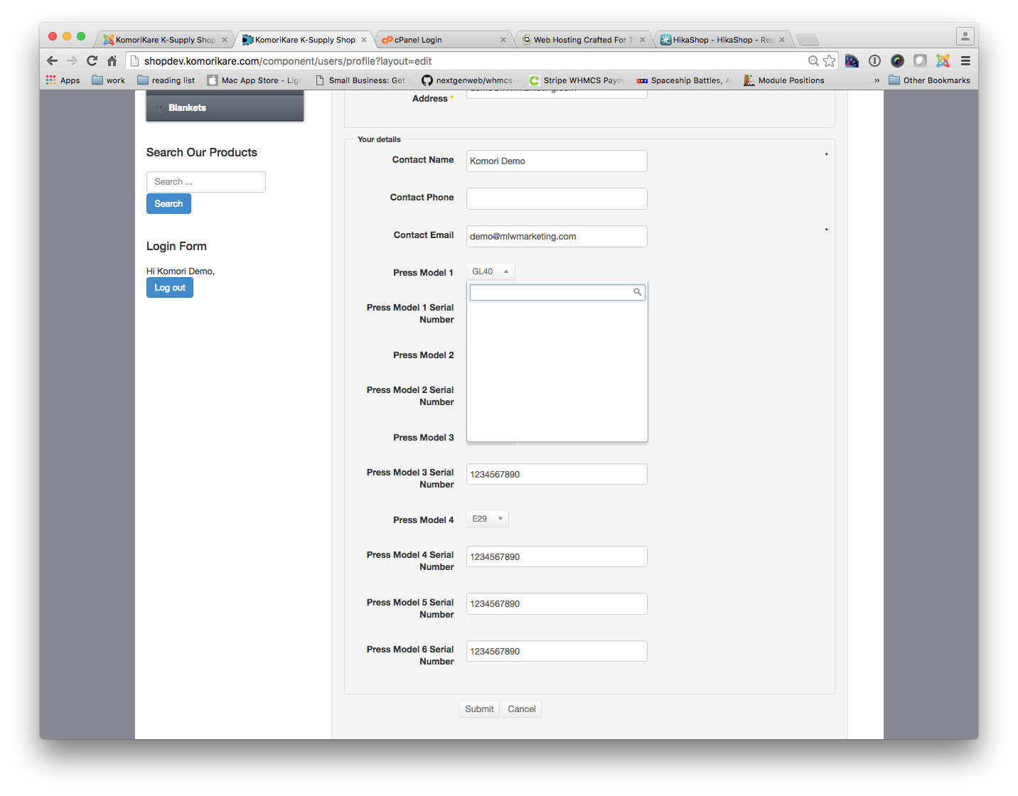

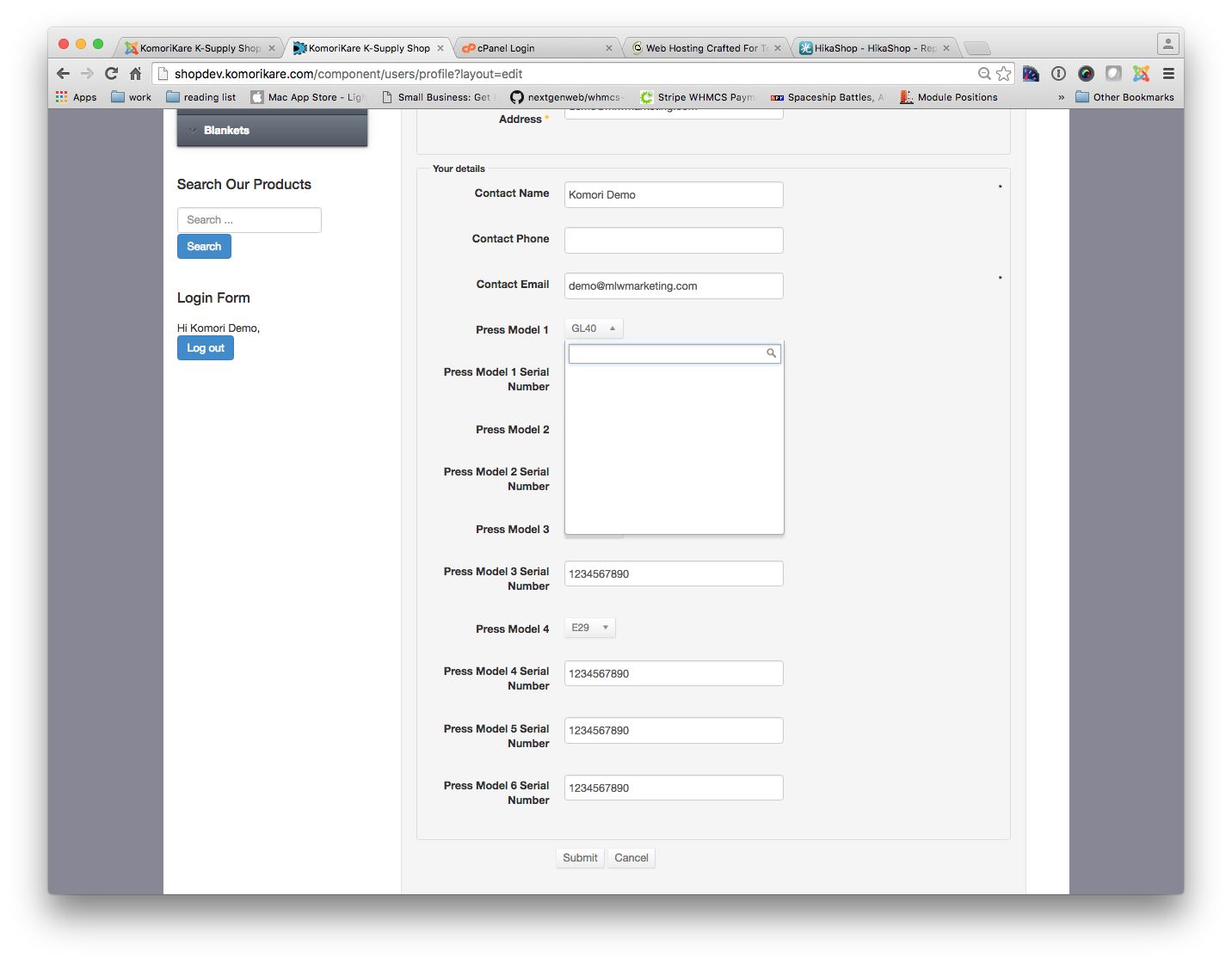

I have entered the My Account menu and have edited the profile for the logged in user. I can edit all fields except for "Single Dropdown" types. When I click the dropdown to edit it, the data below the search box is totally empty. There are NO records showing up. I have 6 of these fields on this form and NONE of them work.
Why is the data not showing up when it works find on the user registration page?

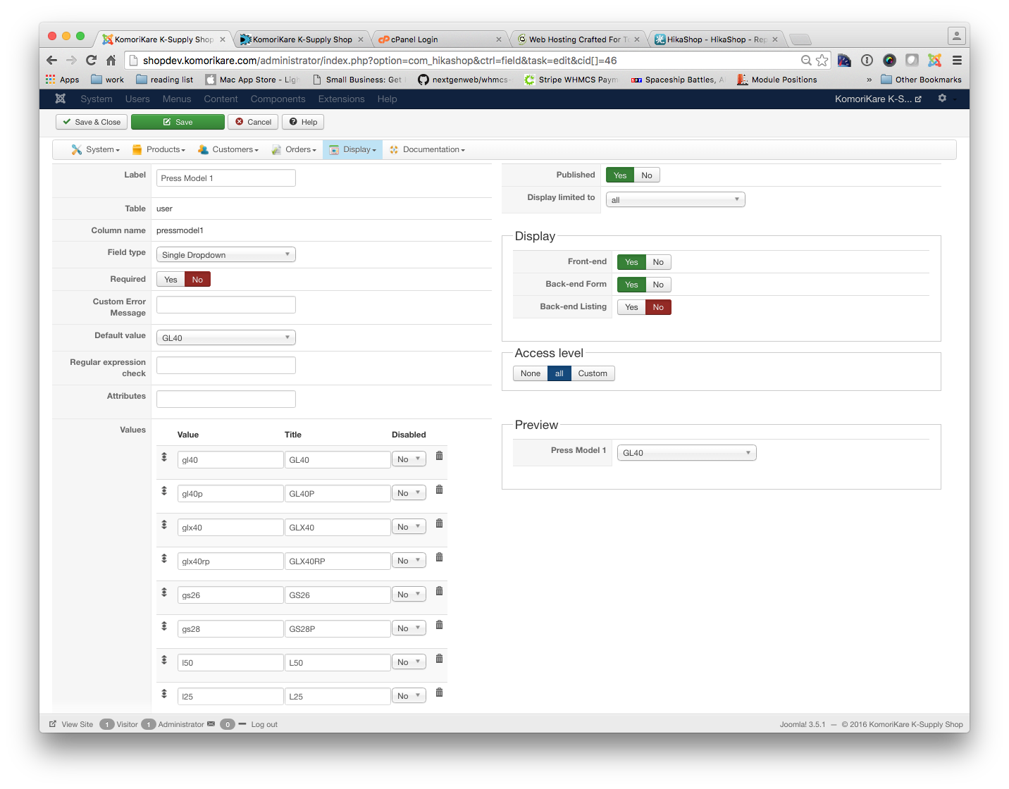

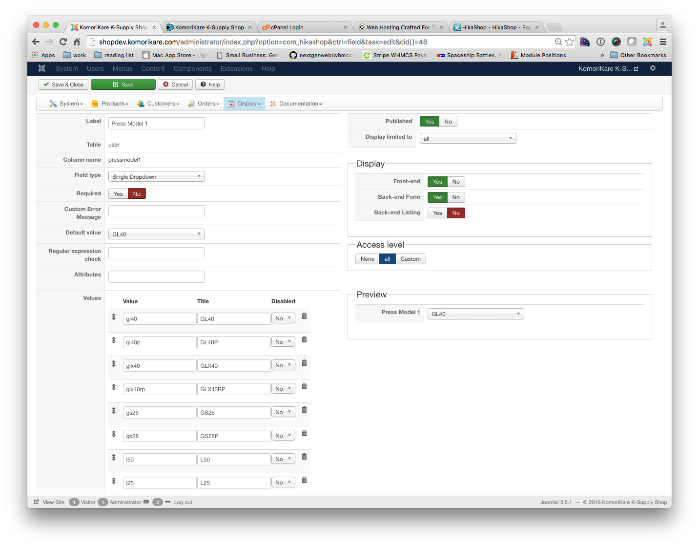

The fields in question are a Hikashop "user" filed type of "Single Dropdown". I have attached a screen shot of the configuration for one of the fields in question and also a screenshot of the edit screen for the profile too.

I've checked your user profile page and I do see the HTML of the dropdowns: take.ms/4MCZp
It's just hidden by the chosen system and thus turning off chosen should solve the problem.
Apparently, there is some CSS messing with the display of the dropdown with chosen on your website. Just removing the padding makes the elements appear:
take.ms/3hUEq
