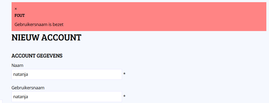

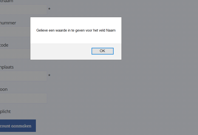

on my hikashop registrationform I get popup errors when a field is not filled or filled correct. But I don't like this popup.
I want to show the errors in my error message div with the <jdoc:include type="message">.

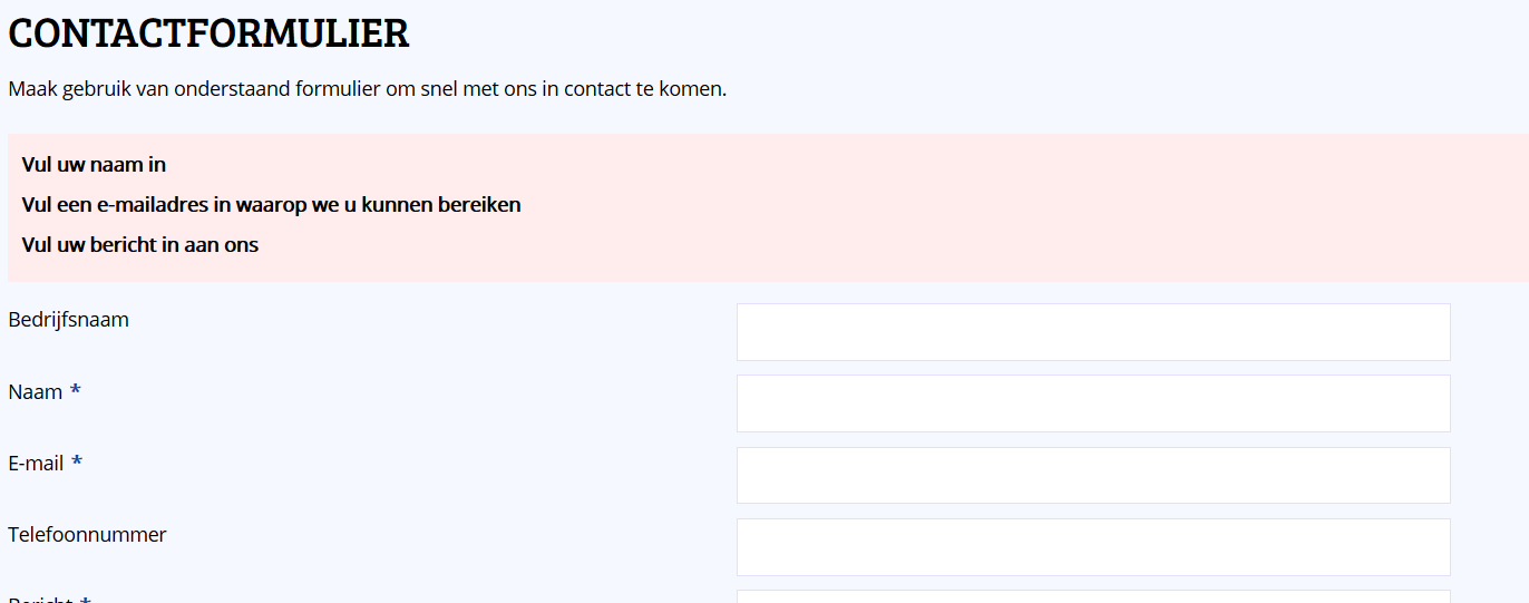

Is there a setting for this? On my contactform made in breezingforms, I get the errormessages on the right place.
and when you have filled all fields on registration form, I also get error about already existing username, on the right place. I would like to have all messages and errors on the same place.

There is no setting for that.
It's possible to do that by removing the javascript check.
To do that, you can change the line:
if ( hikashopCheckChangeForm("register",form) && hikashopCheckChangeForm("user",form) && hikashopCheckChangeForm("address",form) )
to:
if ( true )
in the file components/com_hikashop/views/user/view.html.php

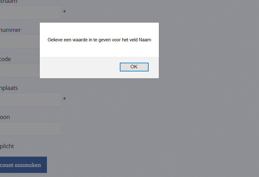

is it also possible to remove javascript messages on checkout page? I can't find the right line of code in view.html.php in the folder checkout.

It would be the same kind of solution : removing the usage of "hikashopCheckChangeForm" so you won't have any check in javascript but only the check made by the server.

Then do it simply. Instead of changing all the places using hikashopCheckChangeForm, you can instead edit the file media/com_hikashop/js/hikashop.js and add the line :
return true;
right at the beginning of the hikashopCheckChangeForm function.
That way, all the places using that function to check custom fields in javascript will skip the javascript check and it will only be done on the server side.
