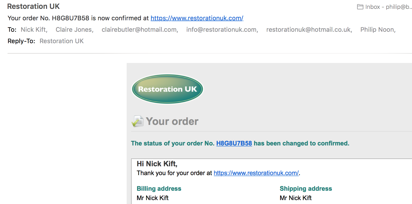

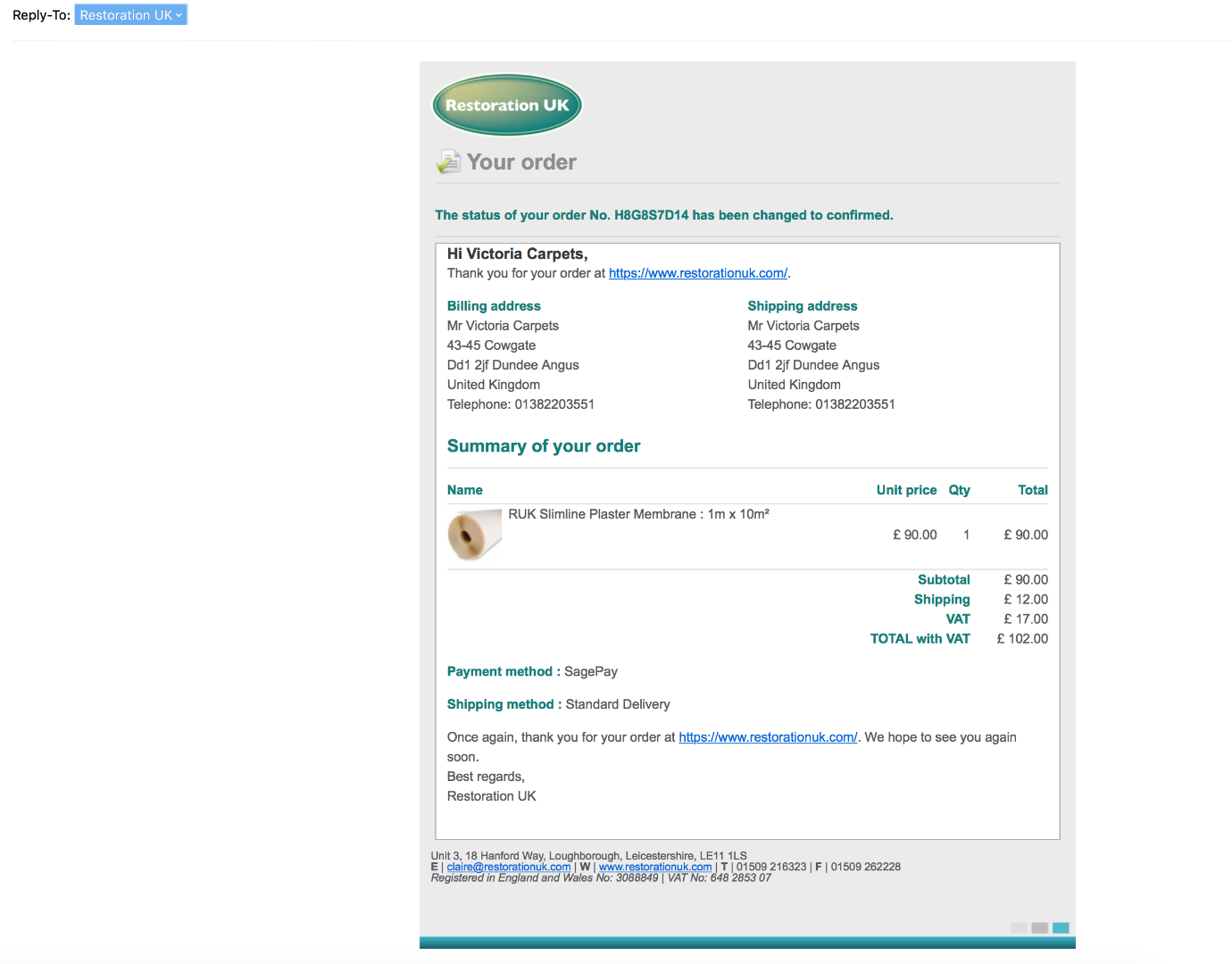

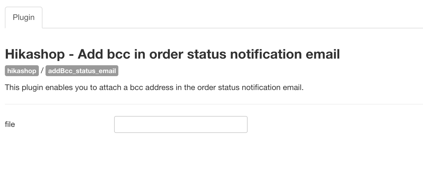

No they are not in email history. However I believe I remember how it was done before I used the bcc plugin to copy in when a order status is sent to the customer my client also receives it which works now.
However the bcc is not working as a blind copy as you can see everyones email in the receiving email.

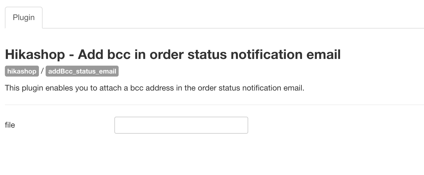

I have attached the plugin I am using and the email we are receiving.

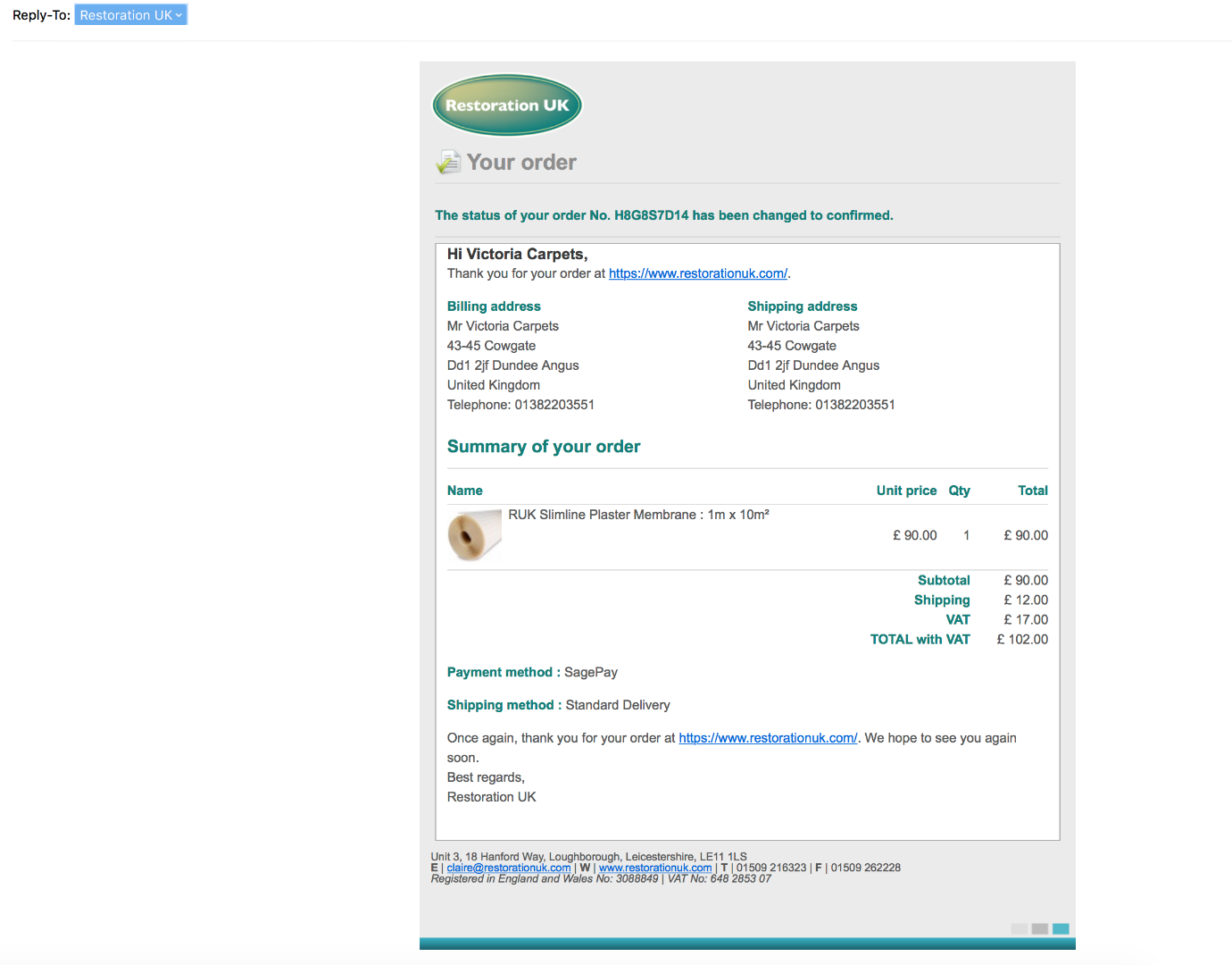

We are currently not receiving any email notification that an order as come through. Does the notification email look similar to the status email and how would I set this up so the client will only receive the confirmation?
I have attached what the client use to receive when a order came through.

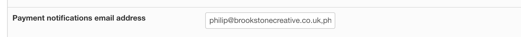

I have already unpublished the creation email. I have added my email address into the payment notification field however I have the issue of still receiving the Paypal pending notification emails when I only want to receive the email when orders are confirmed?

7 years 10 months ago #299478
Hello
I have zipped up the plugin I used, it would be great if you take a look and get it working again.
  • Posts: 86179
  • Thank you received: 14217
7 years 10 months ago #299484
This plugin code always add the email addresses in the order status notification regardless of the order status.
So basically, it works like the bcc field of the emails that we have in the email edition interface.
This plugin cannot only add the email addresses for the confirmed order status and not the others. That would require some additional code in the plugin.
So I don't see how it could be working for you before HikaShop 4. I suspect that you already had that behavior before but you just didn't notice until now.
I've made a small code change to that plugin so that it adds the email addresses only when the order status is confirmed:
Last edit: 7 years 10 months ago by nicolas.

Yes, that's because the code adds the email as recipient, not as bcc.

Sure. Change the addRecipient function to addBCC in the code.
