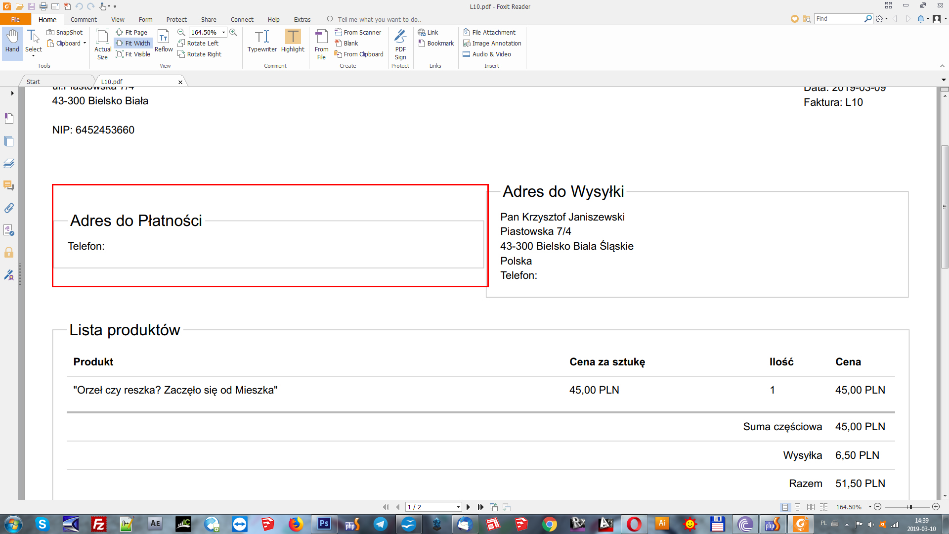

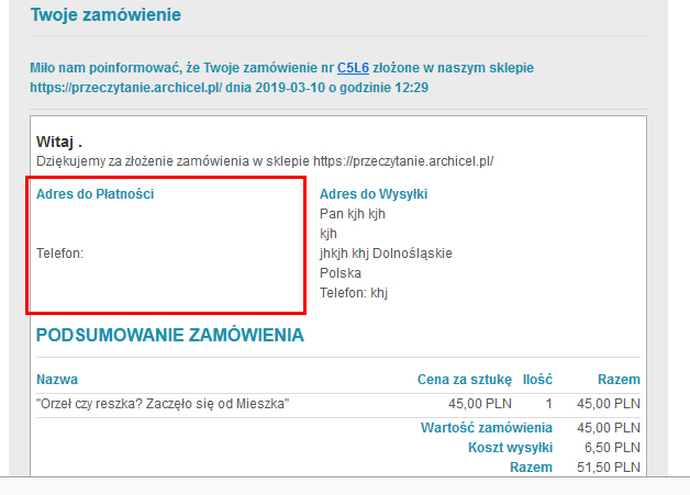

how to remove billing address from invoice and massage notification
  • Posts: 11
7 years 6 months ago #304582

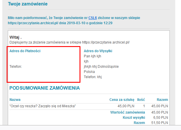

how to remove billing address from invoice and massage notification?
I allready dont use biilig address in order step

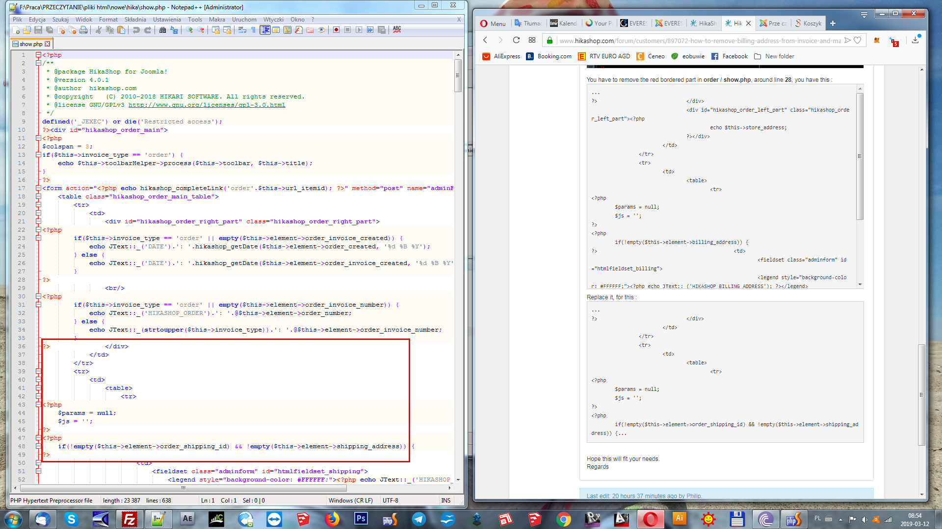

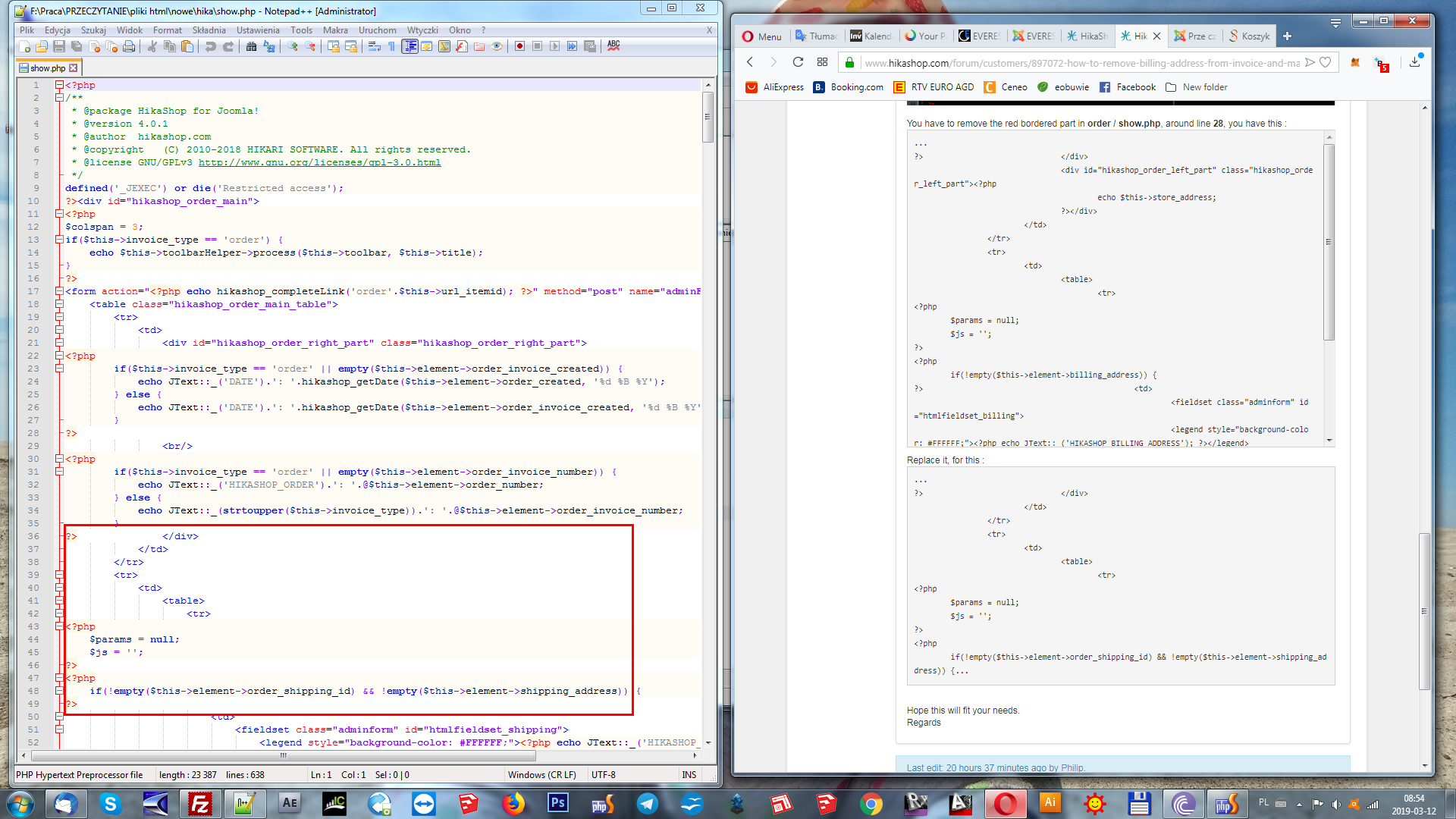

In order to remove your billing address, you have to create view override, have a look on this tutorial. www.hikashop.com/support/documentation/1...-display.html#layout
In order to help you to get which view you have to edit you have an the "Display view files" option.
To reach it, go in Main HikaShop Configuration, then in Advanced tab, then go in "Advanced settings"
To get this :
You have to remove or comment the part that process the billing address, let's detail it:
In order/show.php at the start you have this :
You have to remove the red bordered part in order / show.php, around line 28, you have this :
?>				</div>
				<div id="hikashop_order_left_part" class="hikashop_order_left_part"><?php
					echo $this->store_address;
				?></div>
			</td>
		</tr>
		<tr>
			<td>
				<table>
					<tr>
<?php
	$params = null;
	$js = '';
<?php
	if(!empty($this->element->billing_address)) {
?>						<td>
							<fieldset class="adminform" id="htmlfieldset_billing">
							<legend style="background-color: #FFFFFF;"><?php echo JText::_('HIKASHOP_BILLING_ADDRESS'); ?></legend>
<?php
		$addressClass = hikashop_get('class.address');
		echo $addressClass->displayAddress($this->element->fields,$this->element->billing_address,'address');
?>							</fieldset>
						</td>
<?php
	if(!empty($this->element->order_shipping_id) && !empty($this->element->shipping_address)) {...
Replace it, for this :
?>				</div>
			</td>
		</tr>
		<tr>
			<td>
				<table>
					<tr>
<?php
	$params = null;
	$js = '';
<?php
Hope this will fit your needs.
Last edit: 7 years 6 months ago by Philip.
  • Posts: 11
7 years 6 months ago #304630
Hi Philip
Thanks for answer , I tried to do like U said , I replaced code but I still have the same issue, nothing change

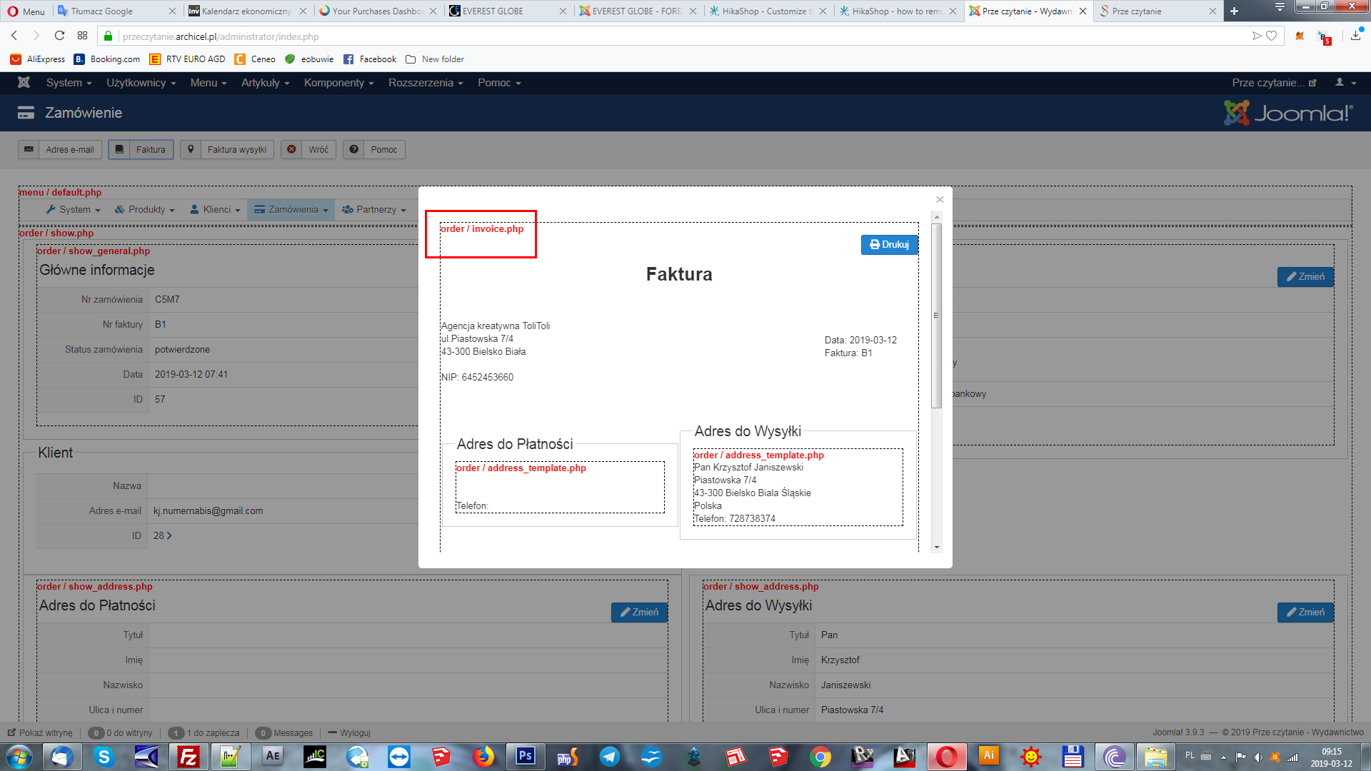

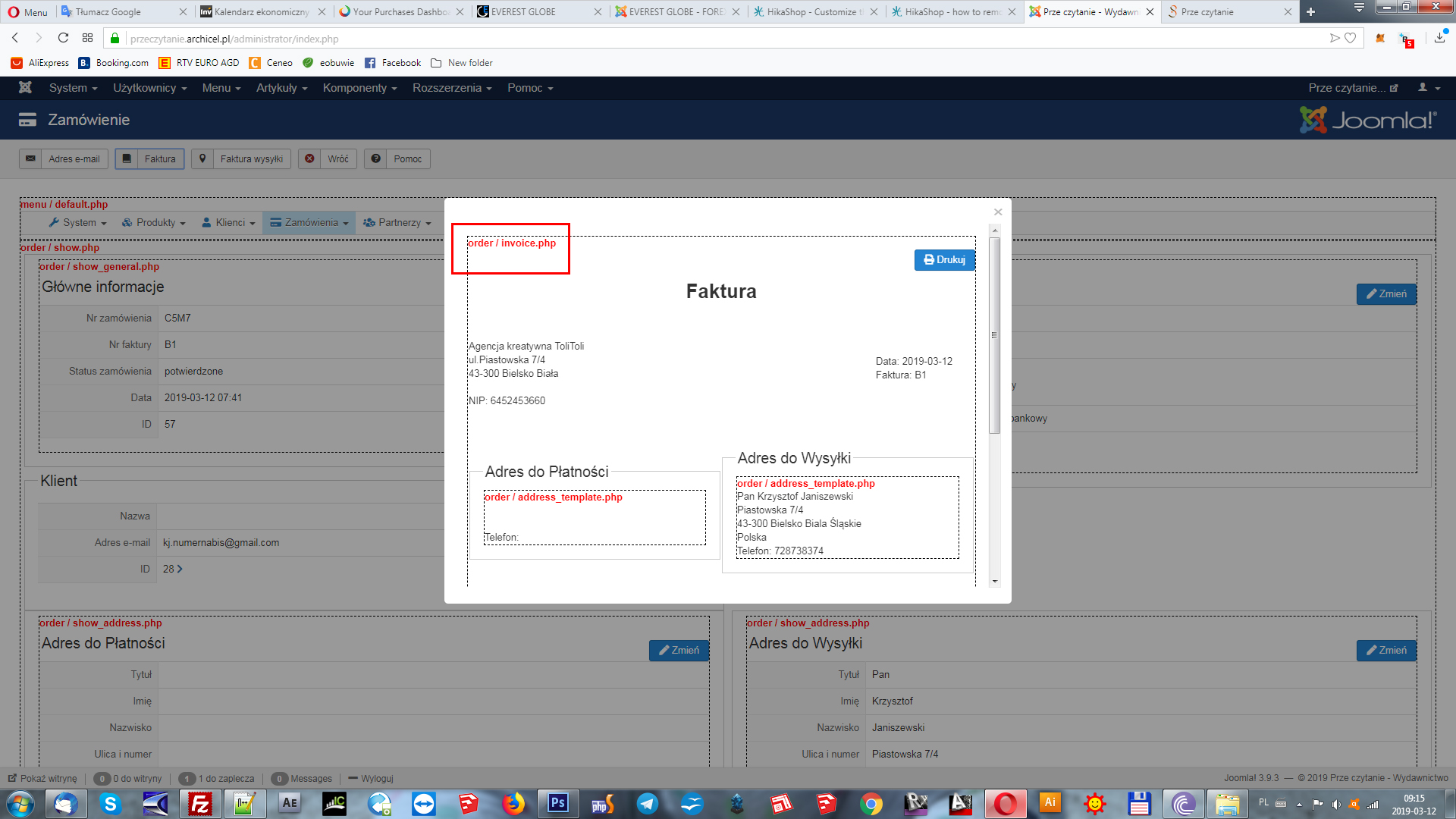

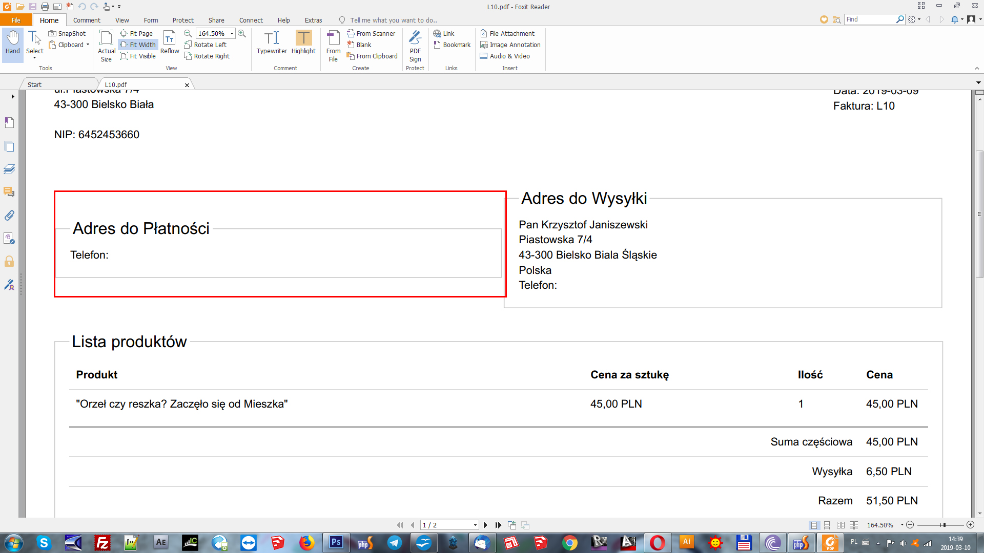

I checked and I maybe should make same changes in order/invoice.php file ? if yes, where I can find this file and what I need to remove?
  • Posts: 86179
  • Thank you received: 14217
7 years 6 months ago #304637
Order / show.php is for the invoice that the customers can print on the frontend of your website. Order / invoice.php is for the invoice that you can print in the backend of your website. So yes, if you're talking about the invoice you can print in your backend, you want to do the same modification in the order / invoice.php view file.
As for the orerv / show.php view file, and any other view file of HikaShop, you can edit them via the menu Display>Views of the HikaShop backend.

ok I sloved the issue thanks
