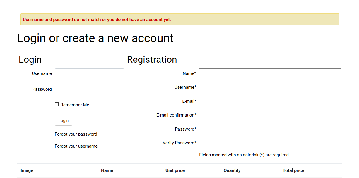

6 years 6 months ago #314463
Thank you.
Yes I know that I am already using extensions.joomla.org/extension/authentication-email/ but that is not working for Hikashop login
demo.joomlashine.com/joomla-templates/js.../shop/checkout/cid-2
https://nimb.ws/8BOfgz
, it is working only when using default Joomla login
  • Posts: 85952
  • Thank you received: 14142
6 years 6 months ago #314468
This plugin work with HikaShop too on my end so please double check.
I looked at its code and I don't see why it wouldn't work.
Are you saying this because it's written "username" in the input field of the login form ?
That's just text that you can change with translation overrides. But if you enter an email address there, it will login properly.
  • Posts: 127
6 years 6 months ago #314566
Thank you.
I did try but get message "Username and password do not match or ..."
Do I need to enable somewhere to work with Hikashop
