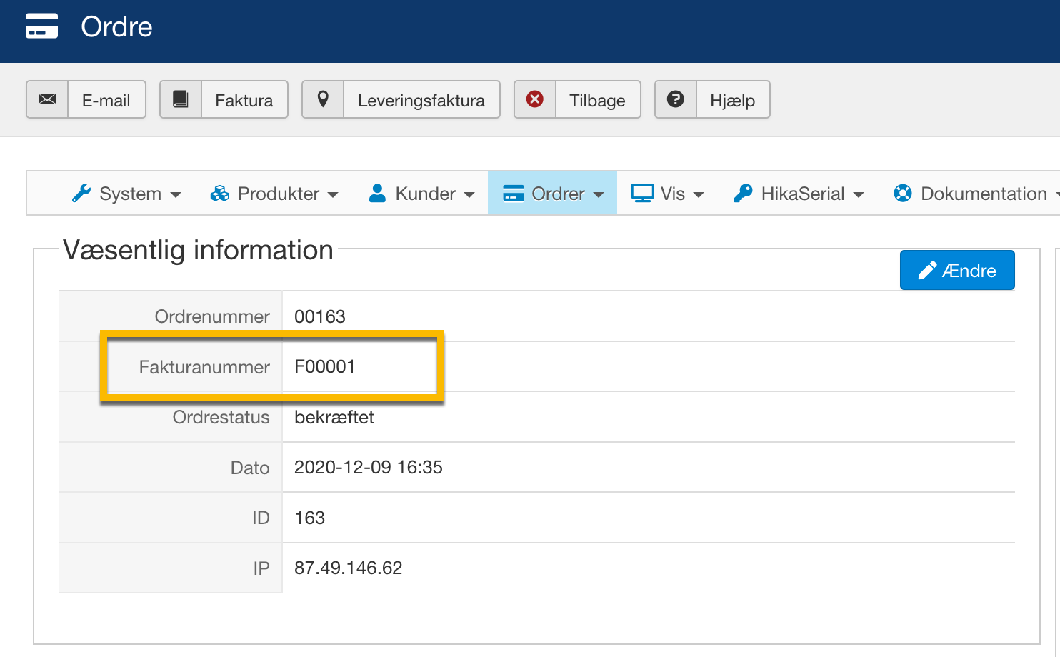

Is there a way to edit the invoice number manually?
Because I have to use numbers from my other payment system.

5 years 9 months ago #327244
No, not the format, but the number itself on the order.

5 years 9 months ago #327269
In that case, you'll have to go through a mass action with an action "display the results":
monosnap.com/file/tJUEObSgumGdx9YKA1KL1myjRDloAd
When you process it, you'll be able to edit the values by clicking on them:
monosnap.com/file/Yz7RS9ki6xIDMQNMLGYj1fQKj8agFo
Note that the system generates the invoice number based on the invoice id. And the invoice id is automatically incremented based on the maximum value of the invoice id in the other orders. So potentially, if you want the next invoice numbers to after at a certain number, you could just modify the invoice id of a previous order (even a test order) so that the next order would directly have the correct invoice id and invoice number.

5 years 9 months ago #327303
Thank you, I'll give it a try!
  • Posts: 366
  • Thank you received: 26
5 years 9 months ago #327304
Tried it and that's a great solution for me, thank you!
