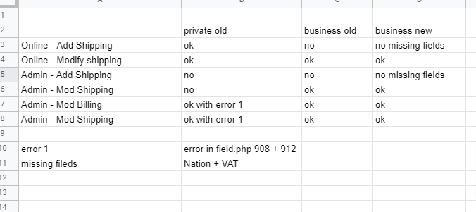

I tried adding and/or changing the shipping and billing details of some of my test users. I attach a screenshot of the tests.
From administration:
- I can't add new shipping addresses (no private, no business, no old users, no new ones).
- I can only edit shipping addresses for business (old and new)

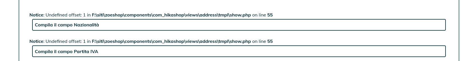

- I can create and edit private and business billing addresses. The private gives an error in the field.php file at line 908 and 912, but saves the data (attachment 2). Business are ok.
Editing the profile from the site:
- As private I can add and edit. All ok
- As a business I can edit existing addresses.
- I cannot add new business addresses because two required fields (nationality and VAT) are missing and do not appear in the form.

Now, I just have this field.php warning, only for private billing address, only in admin update/create process.
It asks for a missing field that shouldn't be related with private.
