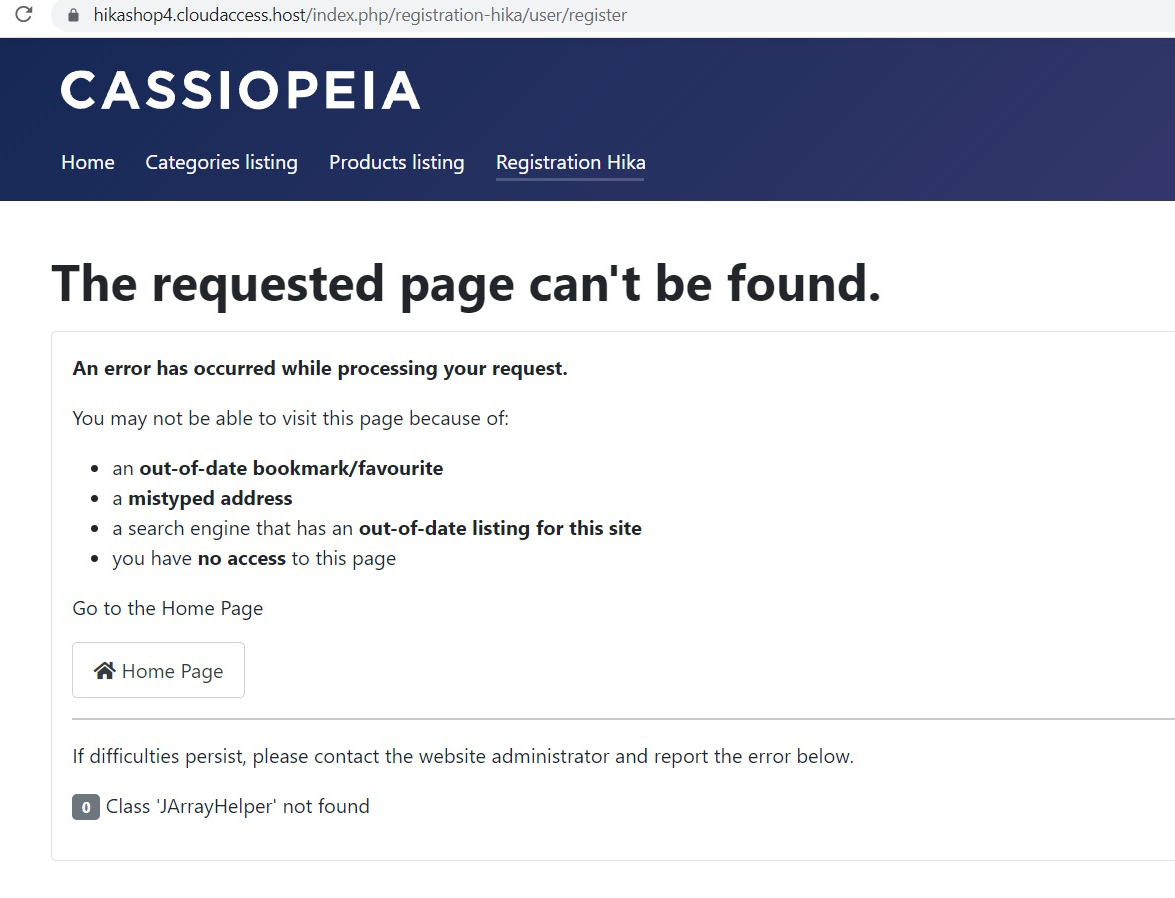

After completing all the fields of the form correctly, I click on REGISTER and I get this error message
I also tried on a server where php 7.4 is installed

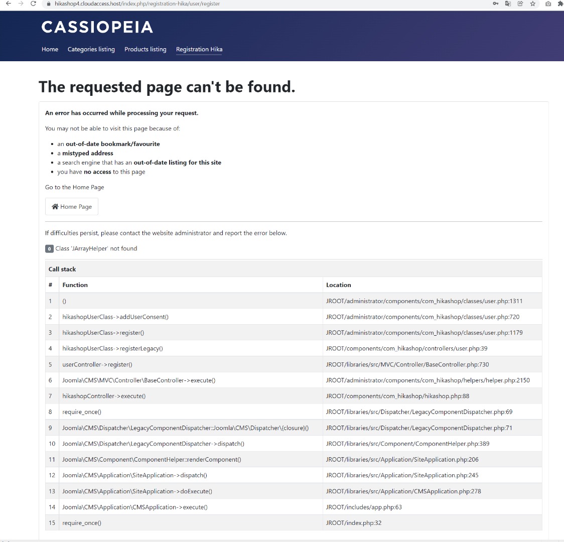

Can you activate the "debug system" setting of the Joomla configuration and try again ?
It will then display an error message with more information, which will allow us to understand the situation and give you a solution.

4 years 8 months ago #338419
Thank you for your feedback.
Remove the line:
$userId = JArrayHelper::getValue($data, 'id', 0, 'int');
in the file administrator/components/com_hikashop/classes/user.php and it will fix the problem.
I've also added the fix on our end so it's possible to fix it by just downloading again the install package of HikaShop on our website and installing it on yours again.

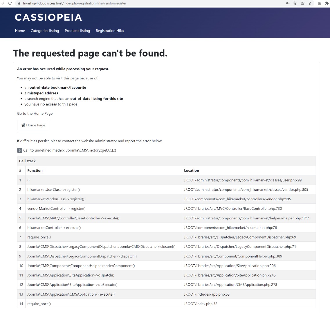

Same bug in HikaMarket when I create the HikaMarket> Vendor edition menu item

Thank you for the report.
You can remove the line 99 from the mentioned file (class/user.php)
We will also include that patch in HikaMarket 4.1.0 release, which should be ready today.
