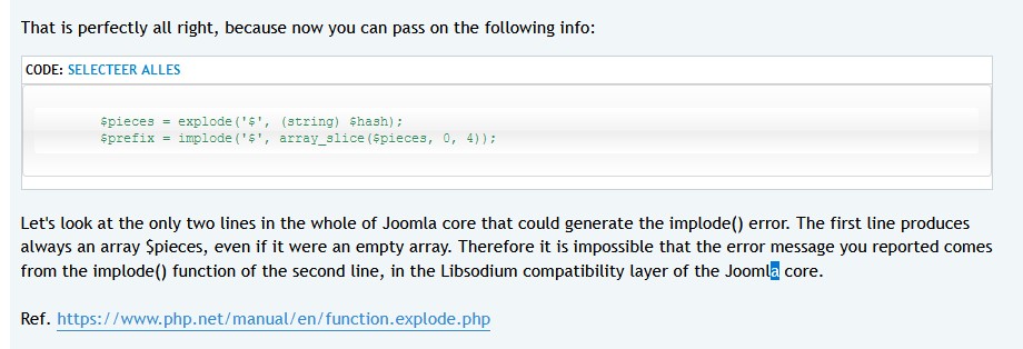

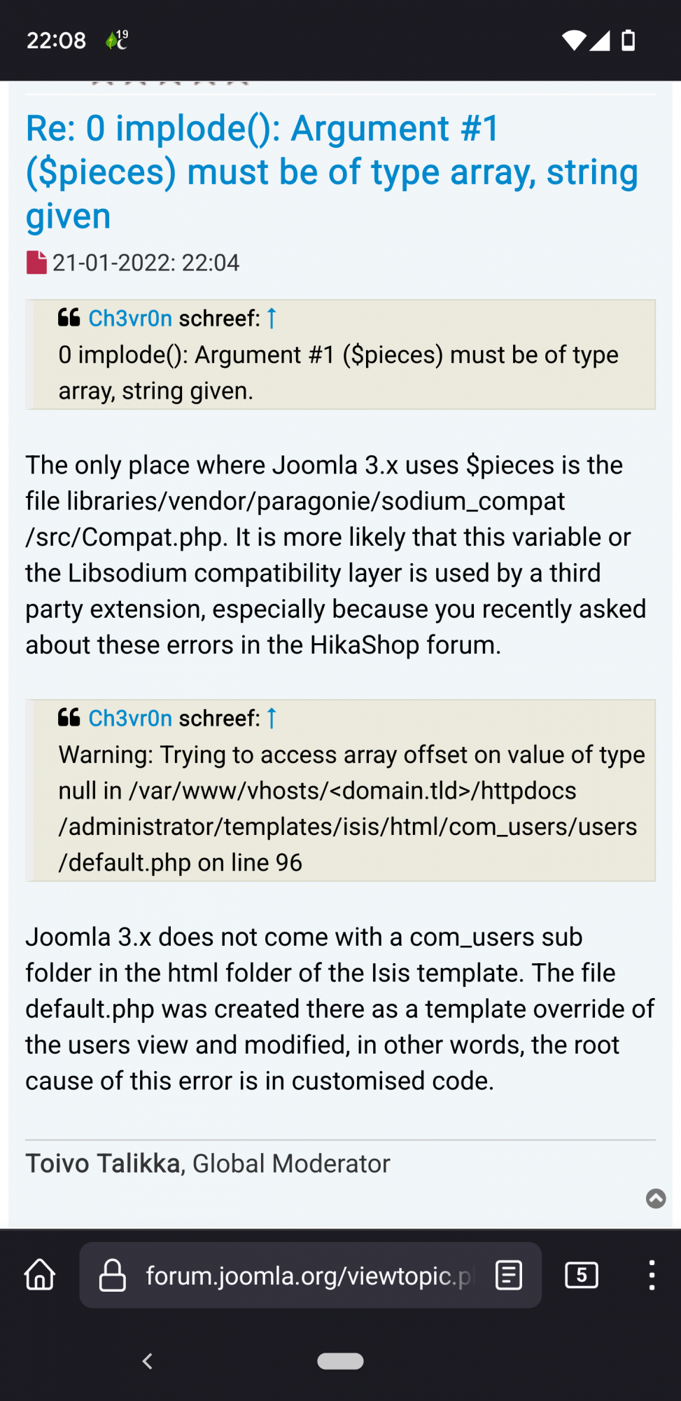

So i asked this question over at the Joomla forum too. A mod had this to say (see attachment). Maybe it's of help, as the only extension i know of that is installed that modifies user registration is the hikashop registration redirect plugin.
additional info

i checked out that specific file just now and its this
$allowed_admins_prm_arr[] = $allowed_admins_prm[0]
Then out of shere curiousity i figured lets check the header if this is even a hikashop file at all. It's not. Its from the component "Login As User" by Web357. I need to take this issue up with them. I'll let you know how this turns out
