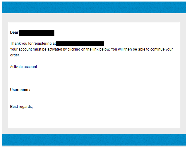

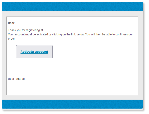

When a new user registers at our Hikashop he gets a email message asking him to activate the account, but the activiation link is missing:
In contrast, when we do a test registration to check for the presence of the activation link, the link is displayed and works correctly:
Does anyone understand this and may be can help??
Best regards,
Helmut

1 year 7 months ago #365576
Can you confirm that the button is missing if you open the email via the menu Customers>Emails history ?
Could you provide a backend access and a FTP access via our contact form so that we could look deeper into it ?

  • Posts: 86179
  • Thank you received: 14216
1 year 7 months ago #365606
So, to recapitulate, the link is in the email when you register with your own email address and check the email via your email client, and when you check in the email history, the link is also in the email sent to the user who provided you with the screenshot of the email with the link missing when opened with his own email client. Is that correct ?
In that case, that can only mean that the email client or the receiver email server of your user changed the content of the email (for example, to remove links, for security reasons). And in that case, you can't do anything to avoid this since the problem is not on your website. That also means that other users shouldn't have the problem.
